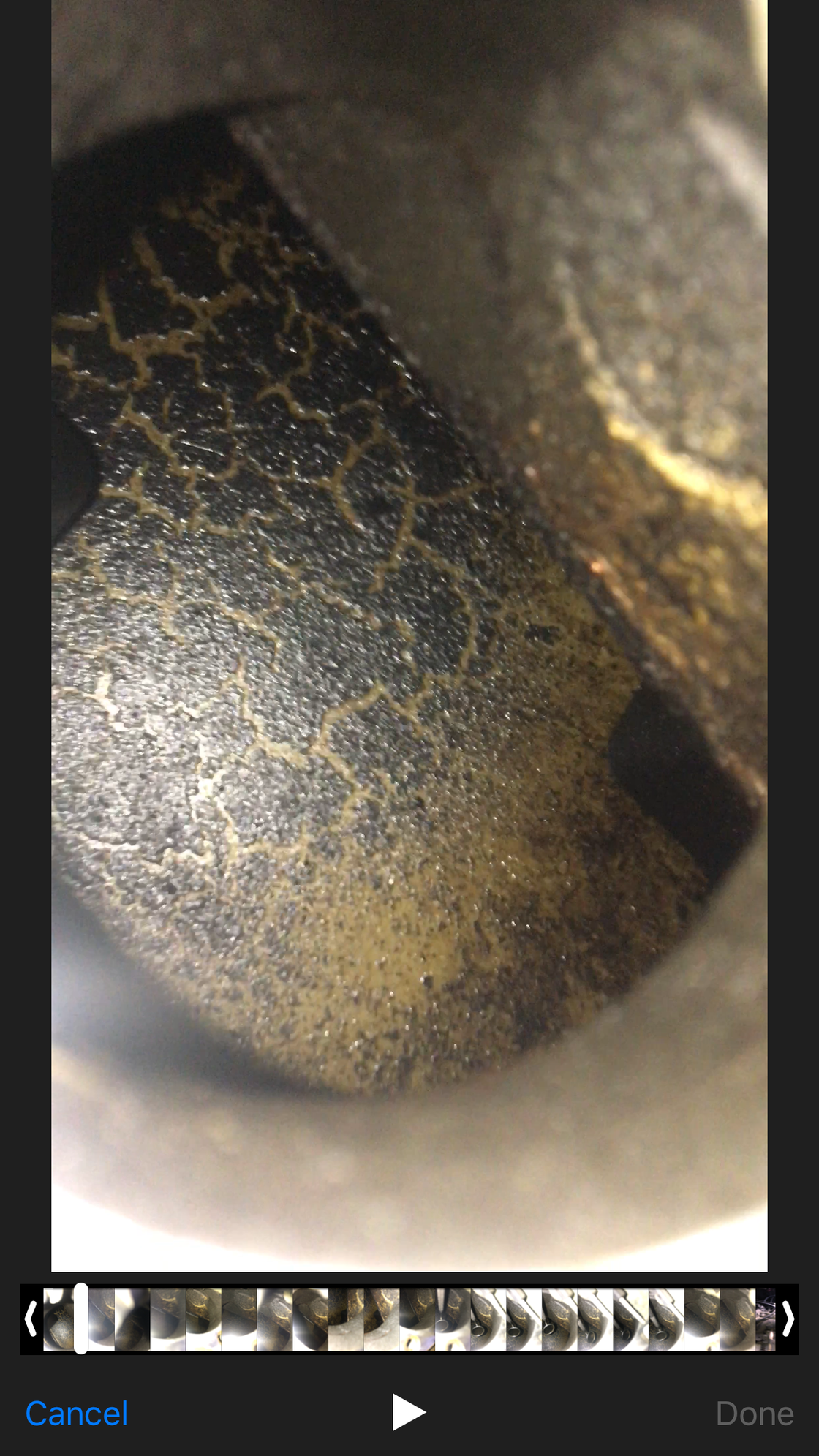

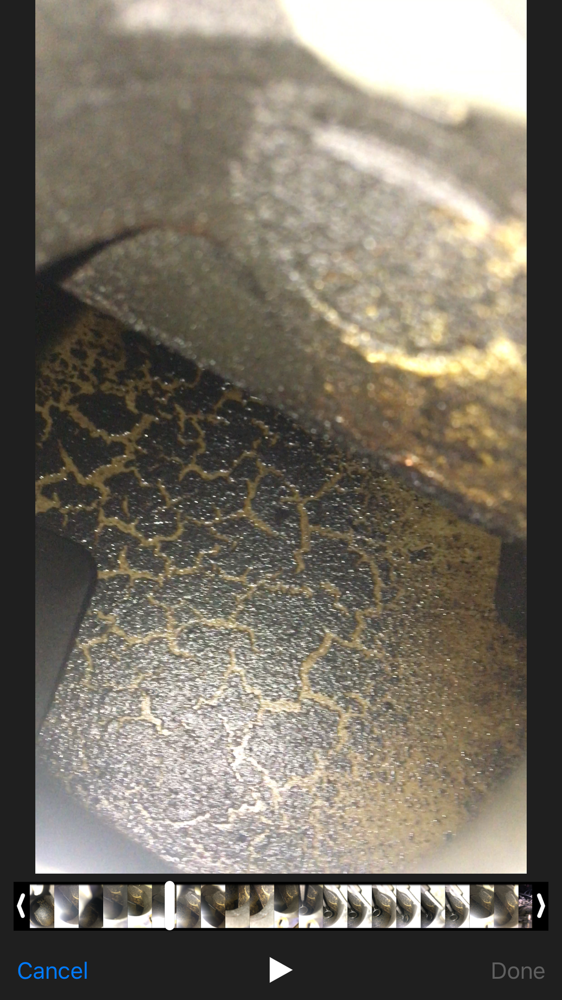

Is the code p141 showing because of the missing relay? I don’t have any code for a bad cat. My plenum plate doesn’t have oil floating in. Looks like the picture below.
Questions:
1) Do you recommend to change the plenum gasket or leave it as is.
2)Because of the relays missing, will this cause loss of power? ( no communication between o2 and pcm)
3) don’t know y it showed codes P0138 - shorted to voltage o2 sensor, P0171 - Air/Fuel Mixture too lean in bank 1, P0141 - o2 sensor heater circuit.
Thanks again
Old Dec 1, 2017 | 11:10 PM
Posts: 87,483
Too much crap in there. Likely the gasket is bad.
Relay missing will ensure the heater circuit doesn't have power...... that really needs to be there.
First code is likely related to the missing relay as well. It may think you are running lean because of the blown plenum, or, the front O2 sensor has become fouled from burning oil, and is no longer accurate.
Replace the relay, clear the codes, see what comes back.
