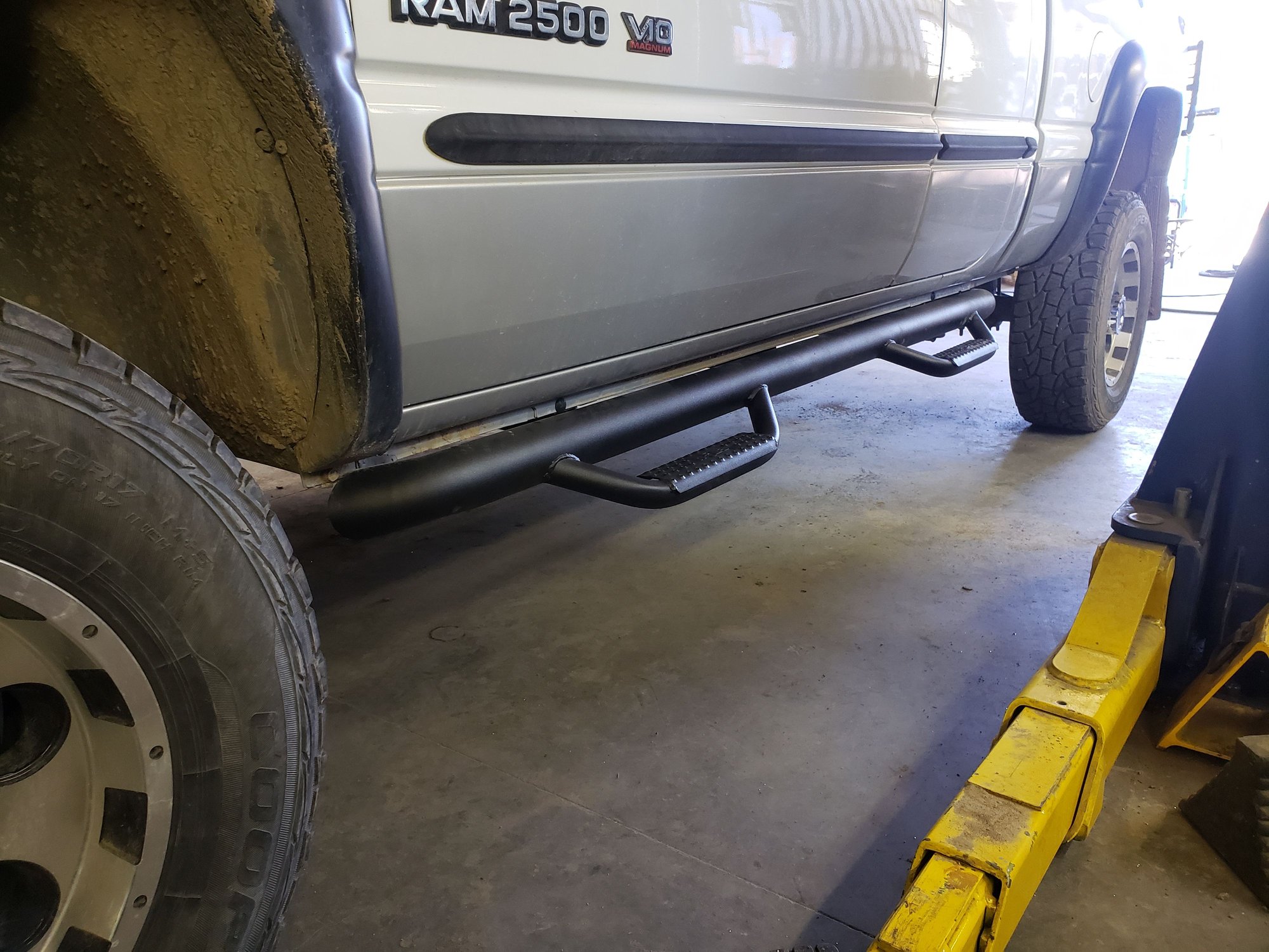

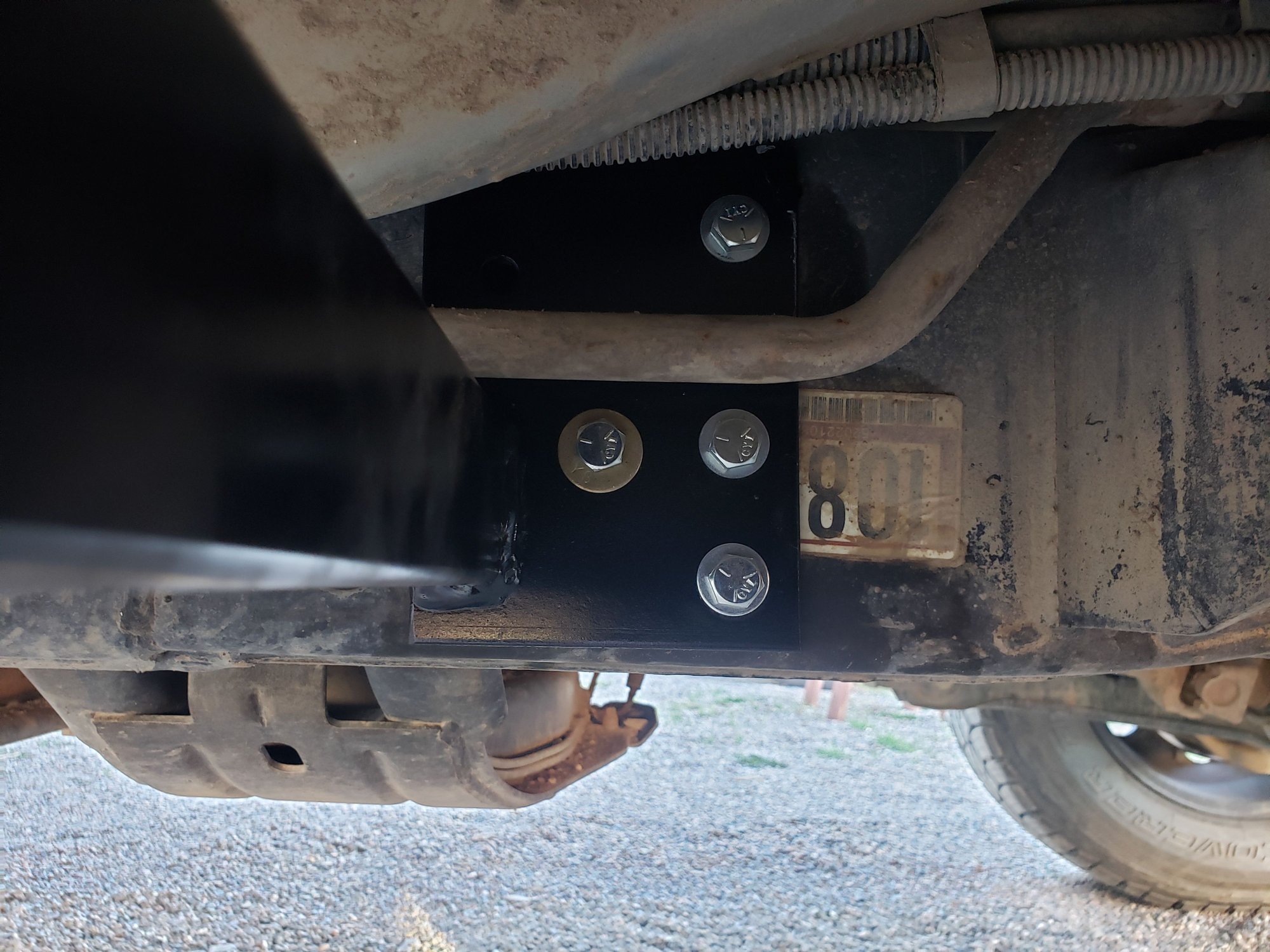

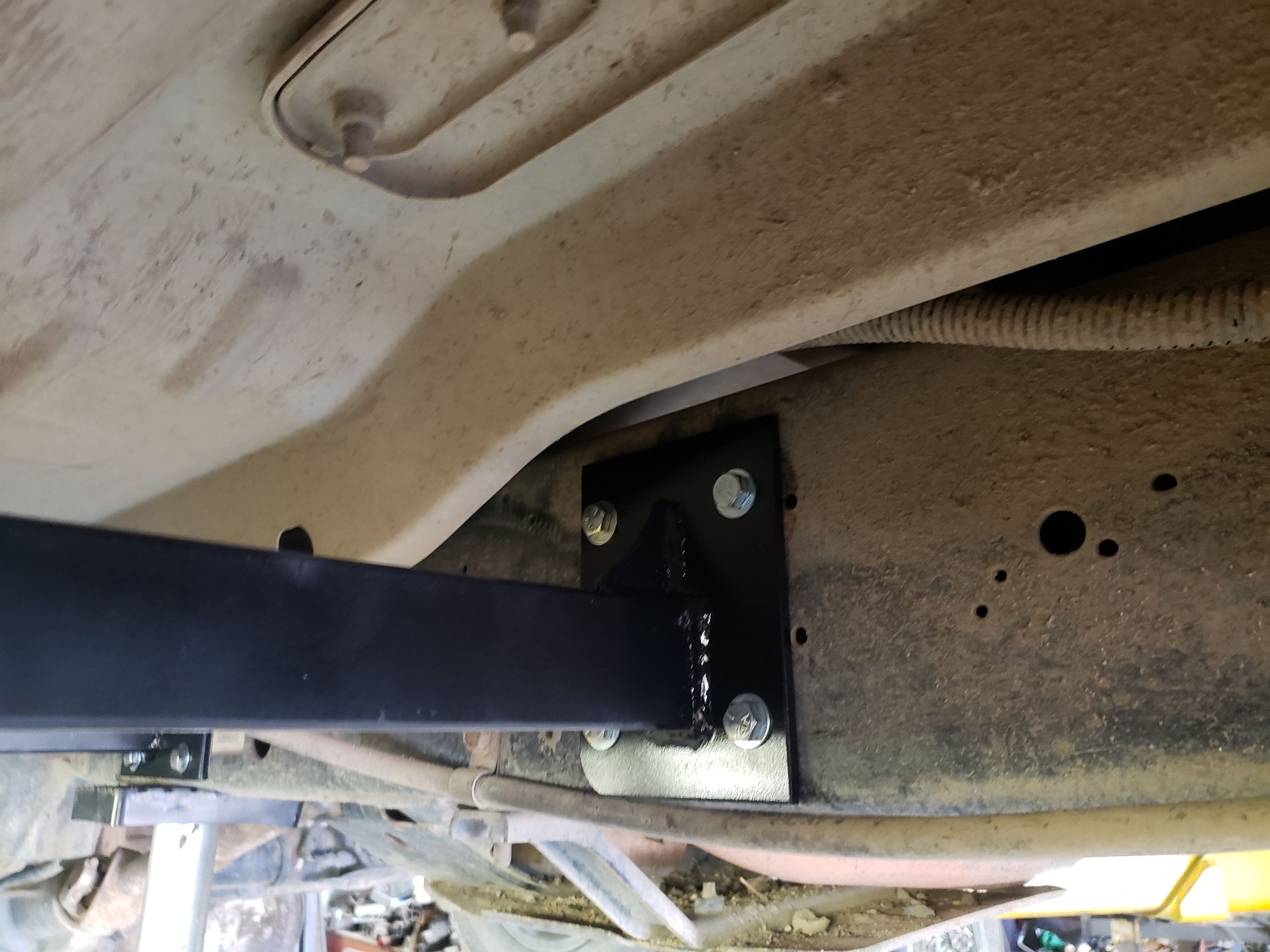

I installed some N-Fabs on a '98 2500 V10 today for a client. I had previously corrected some Iron Cross steps for him on his '07.5 CTD after the local Ford dealership drilled into his rockers in that case... problem was they drilled kinda-sorta half of a hole into his pinch weld and the bottom half of the hole was, well.....air. GEE, WHAT'S WRONG WITH THAT???
Anyway I actually tried to convince him the prescribed N-Fab method was probably ok if done properly, but he insisted I do the same as I had on his '07.5. Ok, it's not my money
Anyway, here's some general shots. The RH side sucked because each bracket had to be custom custom custom

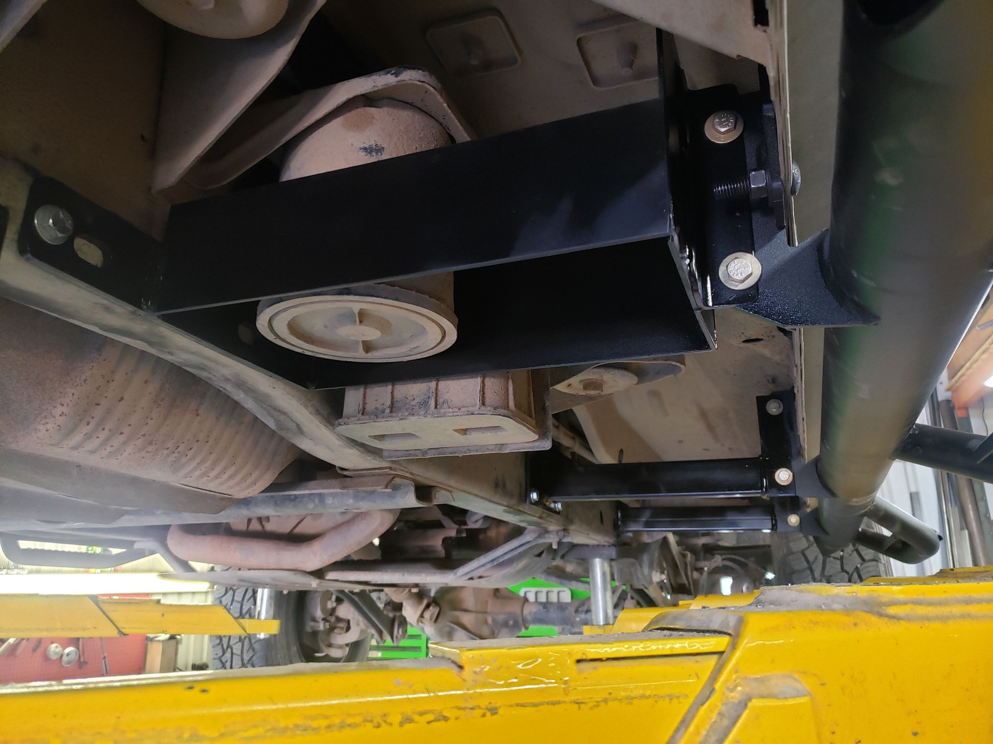

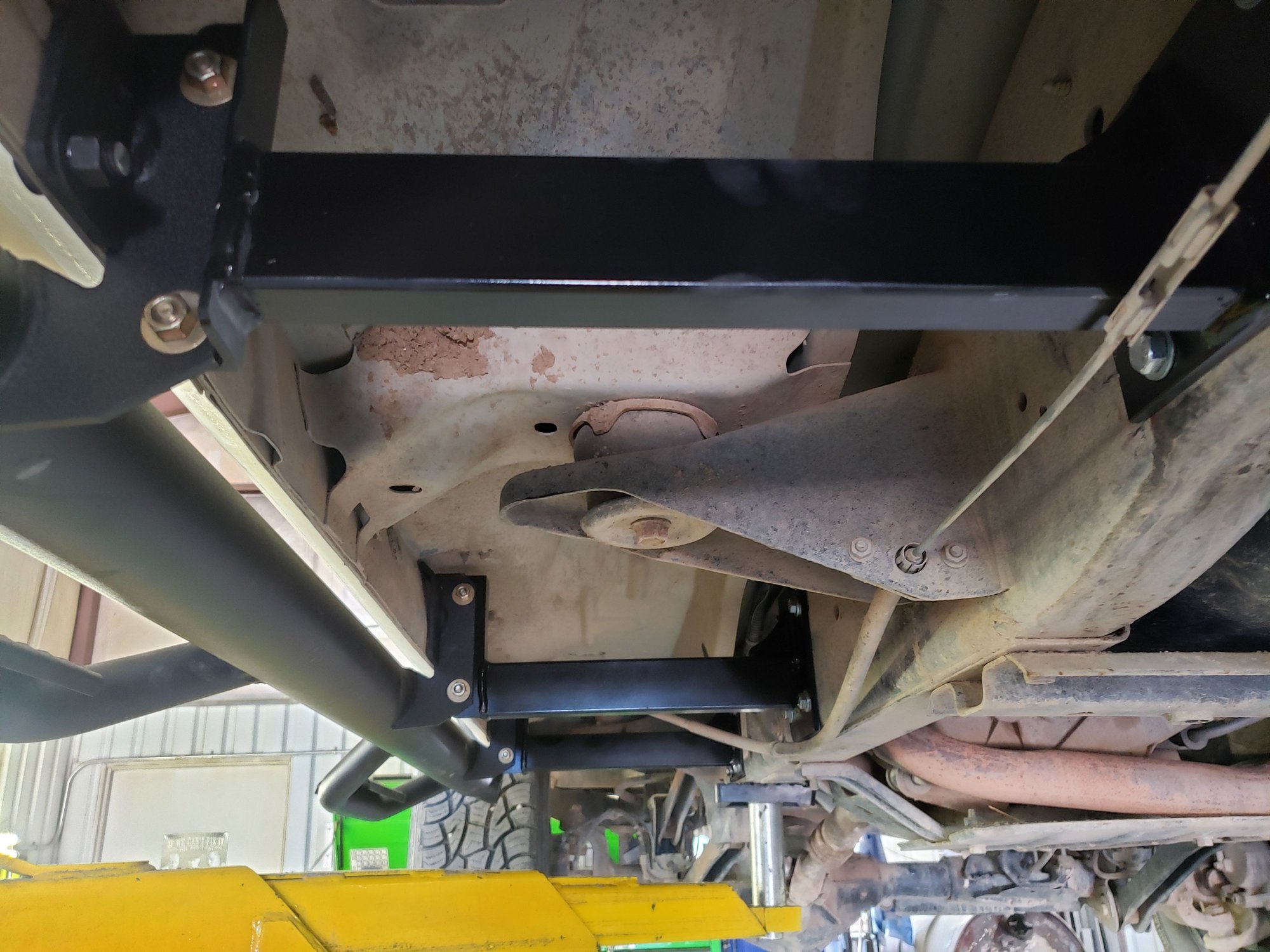

On both his '07.5 and '98 I drilled the frame and tapped 3/8-24 because the frame is boxed or mostly boxed
Right rear bracket accomodating ... EVAP??.... stuff
Right front bracket accommodating....AIR tube?....maybe?
General shot of right side, front 2 brackets
General shot of left
Gusseted whenever possible (er, edit: you can't really make out the gusset at the top of the 1x2" but it's there LOL)

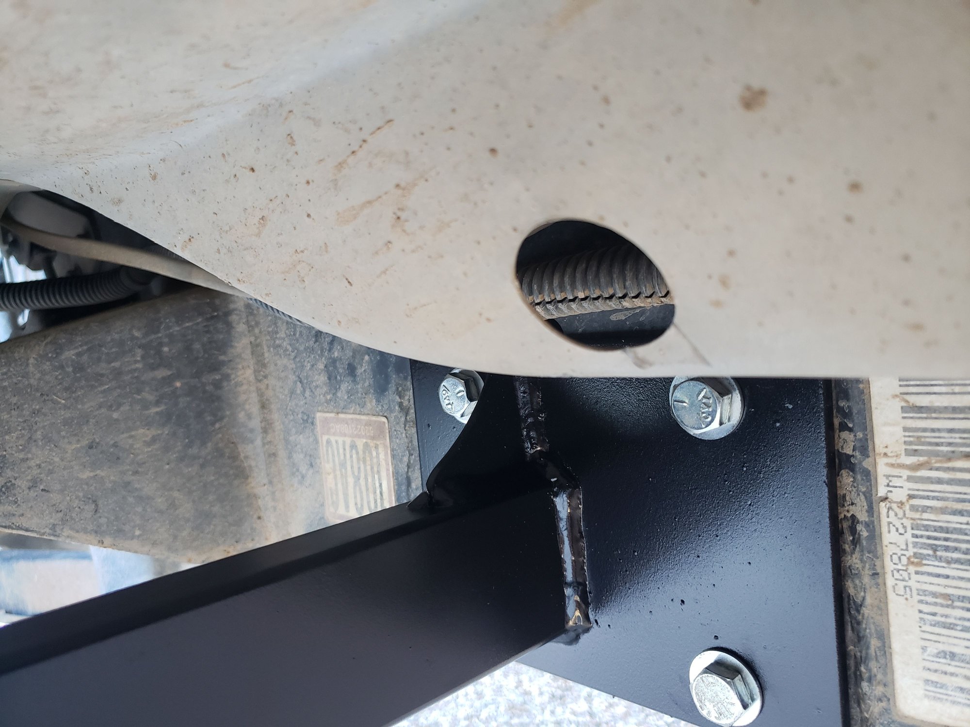

Gusset(s) (from A&A Manuf) kinda-sorta captured. Turns out trying to photograph black parts is like trying to photograph black dogs: it's all a blur with little detail!

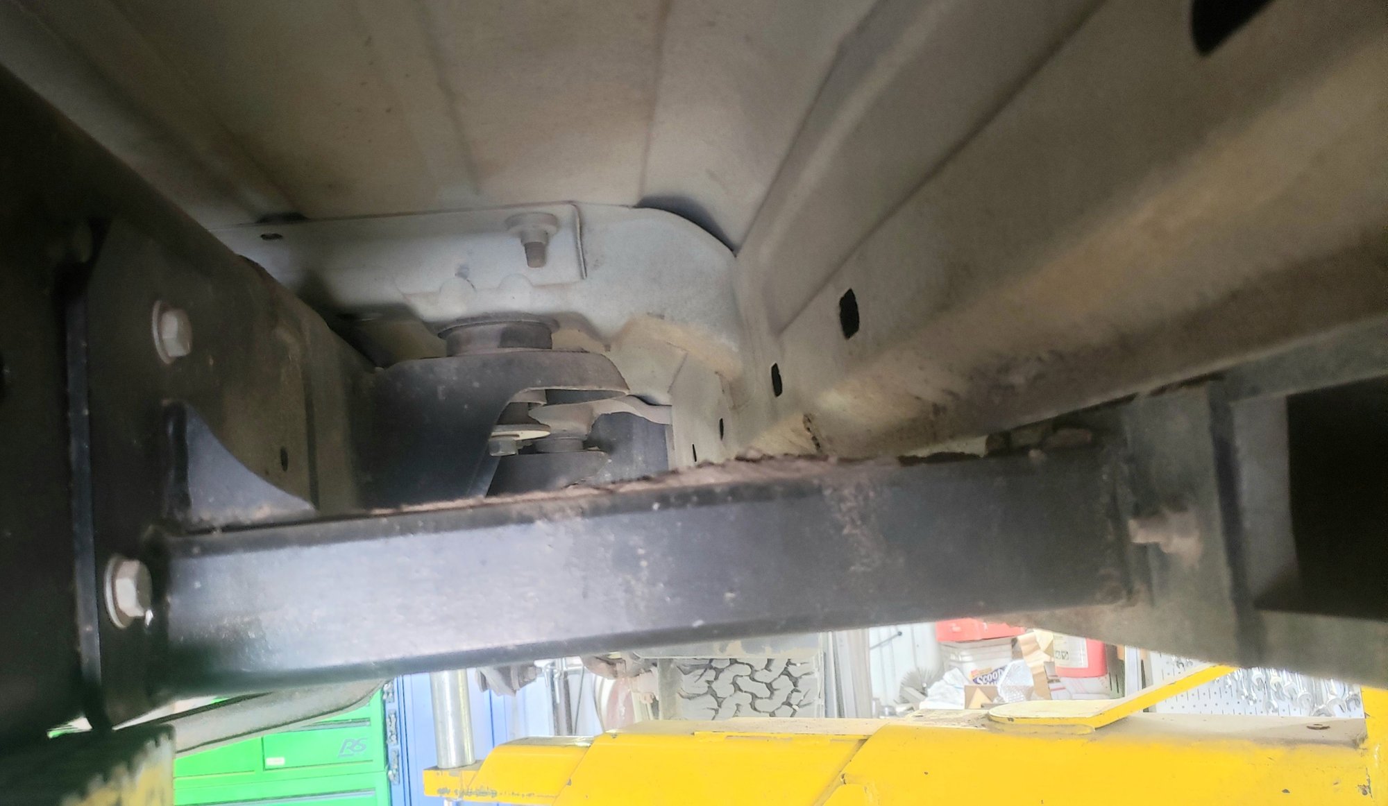

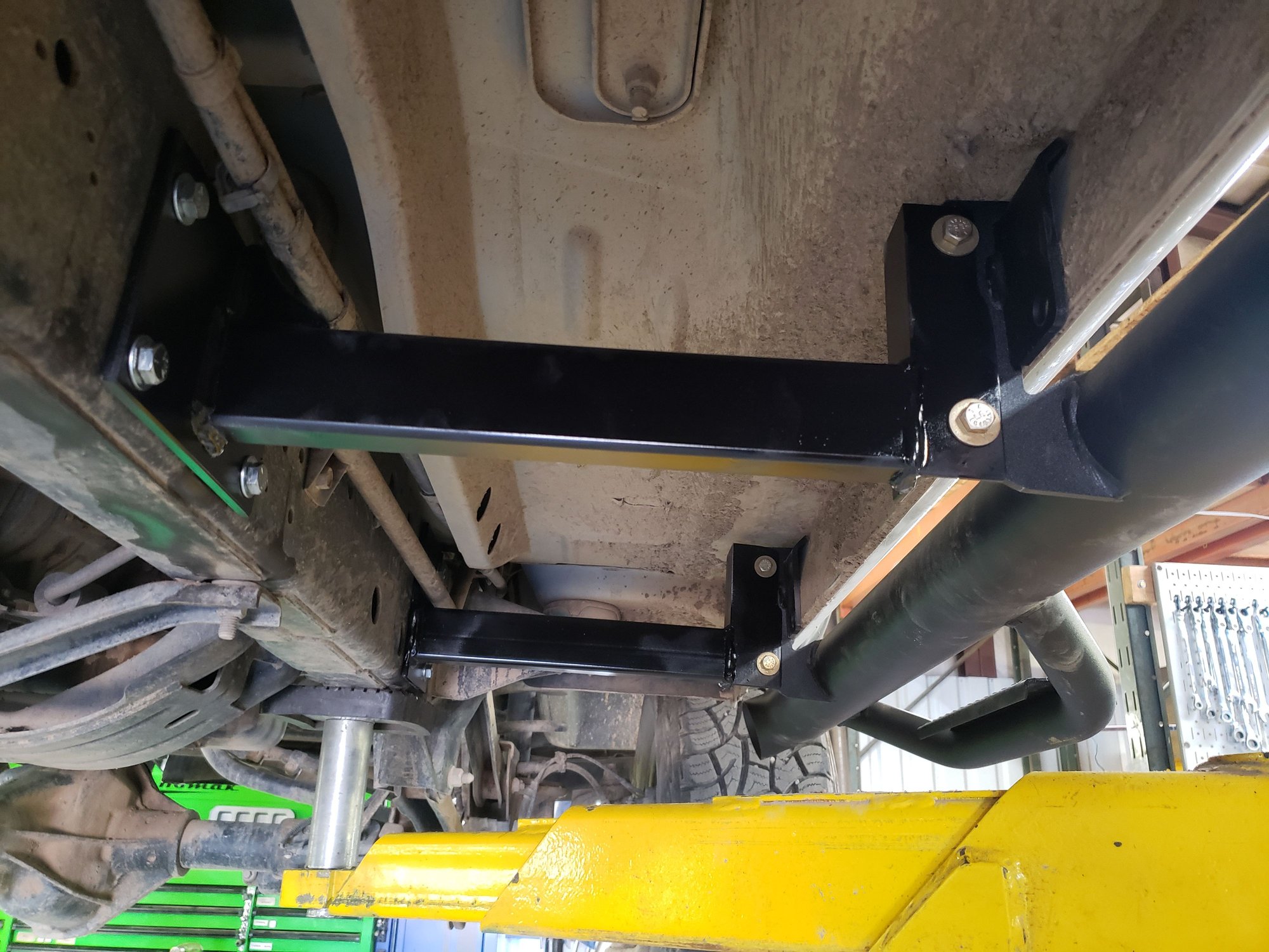

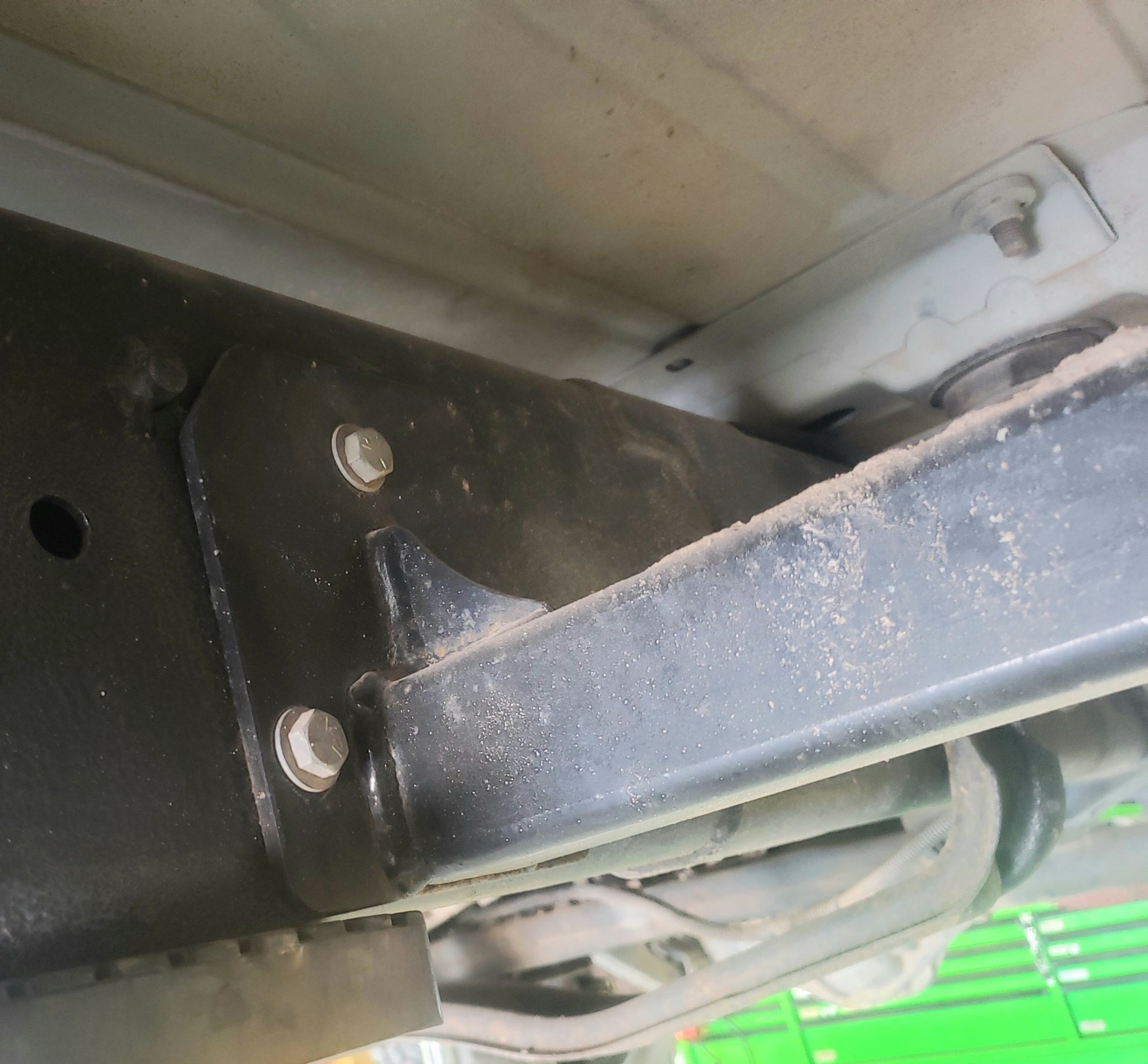

Quoting myself....I had the '07 back in the shop and snapped a few pics. The Iron Cross steps are only anchored with 2 arms per side and the framerails were actually much less cluttered meaning there wasn't really anything special to accommodate or fit around.
At the owner's request I did tuck the bars up much closer to the body; the original mounting from Iron Cross put the steps lower and you could see the half-holes in the pinch seam. It really did look shoddy this way.
Placement
Overall, RH side
Frame drilled and tapped 3/8-24
The only nice thing about the IC steps is this channel mounting system which allows you to adjust fore/aft and you also get a little adjustment up/down
It looks like it tore out from use but it actually rolled out of the local Ford dealership (who fancies themself as having an aftermarket shop) with several holes in the rockers like this. I picture several 16 year-olds with power tools....although the dealership charges $100/hr in their "aftermarket installation" shop
