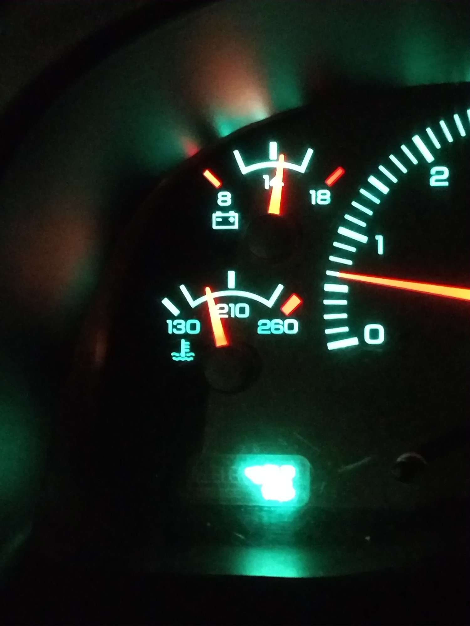

Was having heater issues about a week ago on a long drive and my temp gauge was fluctuation a lot. So I went and put a new t-stat in (195 unless the parts store screwed up). Put it in and put a rug over the radiator ( I live in North Dakota and its been below zero the past 2 weeks and its not going change) and secured it in place. but i was test driving today after work and the needle on climbs half the gauge then stays and doesn't move. And my heat has gotten worse and colder now. Heater core is hot and the blower motor blows. I can't take much more of this cold. Any suggestions for the lack of heat and possible over cooling? Btw 2001 Ram 1500 5.9 L Magnum
Here is a picture of where the gauge stays

That's pretty much where the gauge on my 98 stays as well. The gauge is NOT linear....... (I made the mistake of changing the thermostat, before actually plugging in my scanner, to see what temp the PCM thought the motor was......)
You probably have an air pocket in the heater core..... these trucks are notoriously difficult to get all the air out.

Gauge looks right. Should be nice and hot. Although when it's that cold, it can take an hour of hard driving to get any real heat. I've been through there in -20 deg. Door wouldn't even latch, ha. Took me from Selby to Watertown to take my coat off one year.

Thanks guys, I know the cold has been wreaking havoc on vehicles up here, most just can't handle -30, I'll try to burp the heater core and/or back flush it, but to back flush I'll have to bring it in because no out door hoses this time of year.
