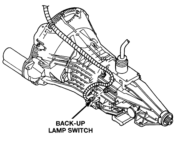

There is a backup lamp switch mounted on the side of the transmission, I would start by inspecting the wiring that connects to the switch.
and remove the switch, clean and test it and possibly replace the switch.
It should be just a simple normally open on/off switch.
What does it do with the, key on and engine off, when you put it in reverse and let the clutch out as if you were going to back up ?

I would guess the switch or the wiring, not the actual transmission. The torque is pulling on the wiring harness.

Sloppy shift linkage might do it as well.
