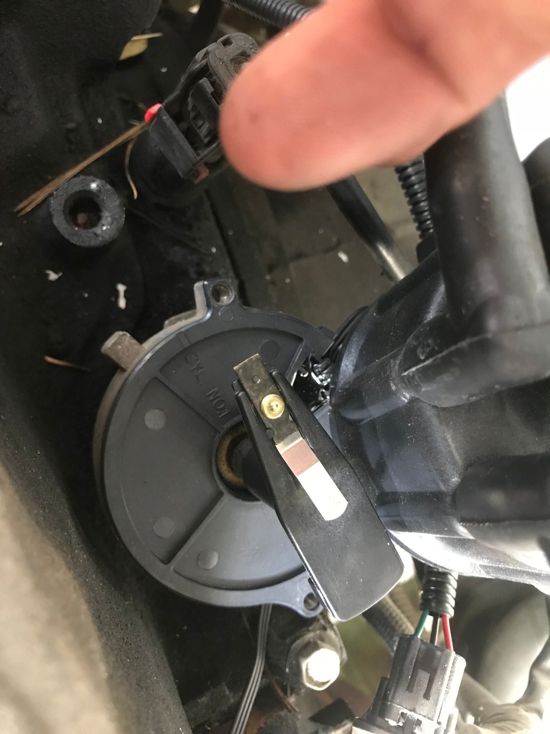

So I went back to confirm where the rotar is at tdc. Here’s a pic, I was wrong, it looks like it’s right on cyl #1 to me. I checked my firing order and adjusted my plugs on cap accordingly. It tries to fire but won’t get to idle and stay, just bogs out and dies. I have 45 - 50 psi at fuel rail, all injectors are good. Everything is new on spark side and have checked to make sure I’m getting good spark all the way around. To me it seems like a fuel issue. If I put a little gas in the intake it seems like it gives it a little more life but not enough to stay running. I’ve replaced both cam and crankshaft sensors as well, oh and the pcm is new. At this point I’m kind of at a loss completely

I've forgotten, have you replaced the crank sensor?

Is this the firing order you are using? I still think you might have bad gas.

That is the firing order I’ve been going off of yes, and I’ve pulled the fuel rail and all injectors, cleaned them all and the rail. And I filled the truck with 91 pump gas and added a fuel system cleaner to the gas
