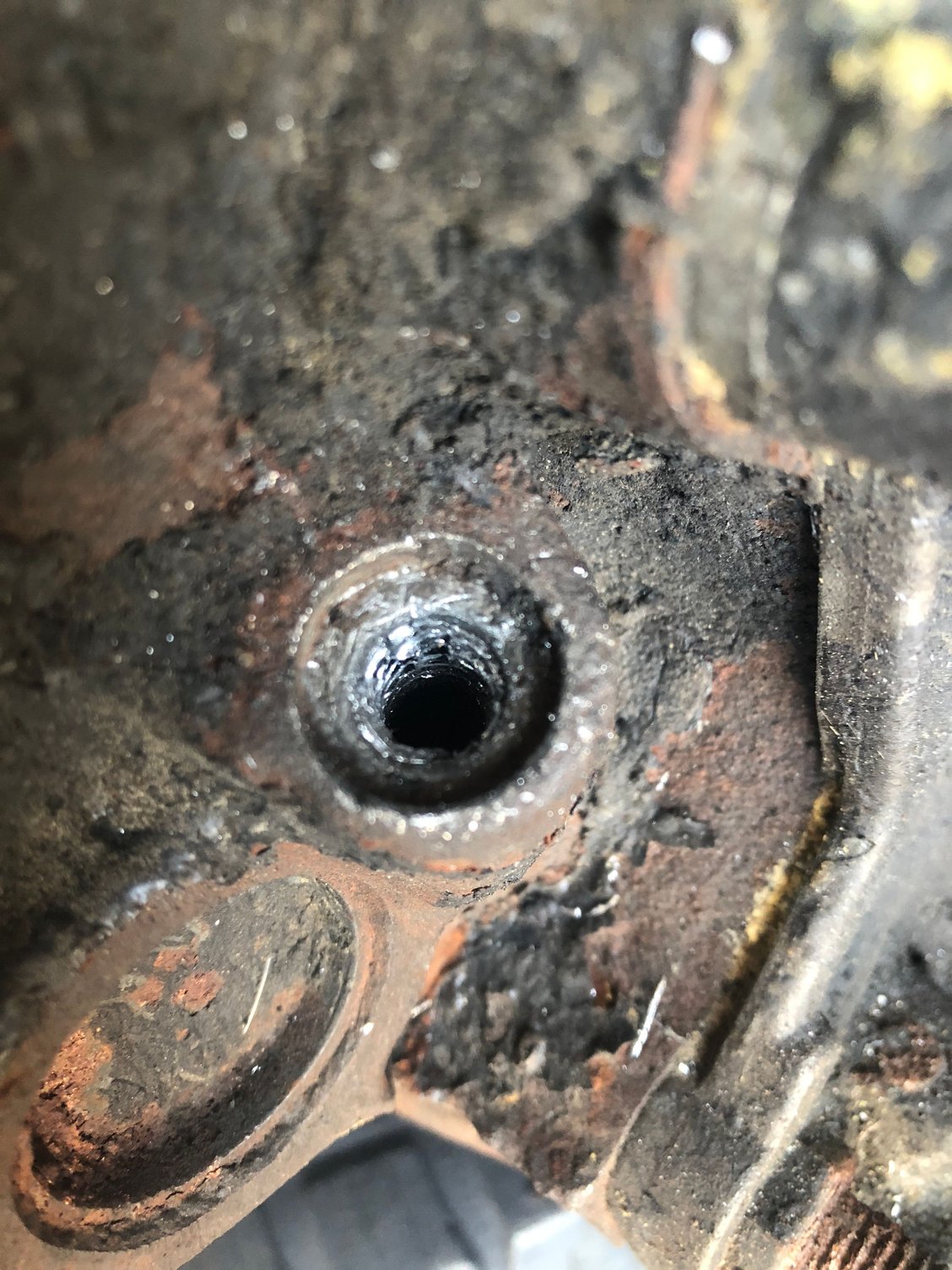

This is the dipstick tube, I’ve tried using an easy out but it started to strip the easy out lol, and it still won’t fit in there, so I’m at a loss of what to do for this problem. Any advice?

Is that the motor in the truck? Or the new one? (well, new to you at least.....) I might be tempted to drop the oil pan, and see what it looks like from the other side.
This is the “new” engine and I would do that but I don’t have an engine stand, just a hoist, and I’m not about to trust that enough to lay under the engine with it in the air, no thanks lol
Another question, if I leave a very very tight bolt in the dipstick tube, an easy out, would that be okay to drive with? I can still take it out, hold my dipstick there like where it normally is and check my oil that way, then just plug the hole again. Would that be an option that I could do?

That would be fun on a hot motor......
Harbor freight has engine stands pretty cheap. Under 50 bucks if you catch 'em on sale.

Cut a block of wood or steel tubing to fit between the top of the ram and the boom. Leave it down so the block or tube holds the weight. The engine stand would be the best though, but I've been through times where $20 seemed like 20,000, LOL.

Alright so I got an Easy Out plugging my oil dipstick hole for now, I got the rest of the motor ready to put in, and I just started putting it in today before I had to go to work. I'm having trouble lining up the motor mounts and not hitting the transmission while I push the motor back and low enough to get into the motor mounts.
