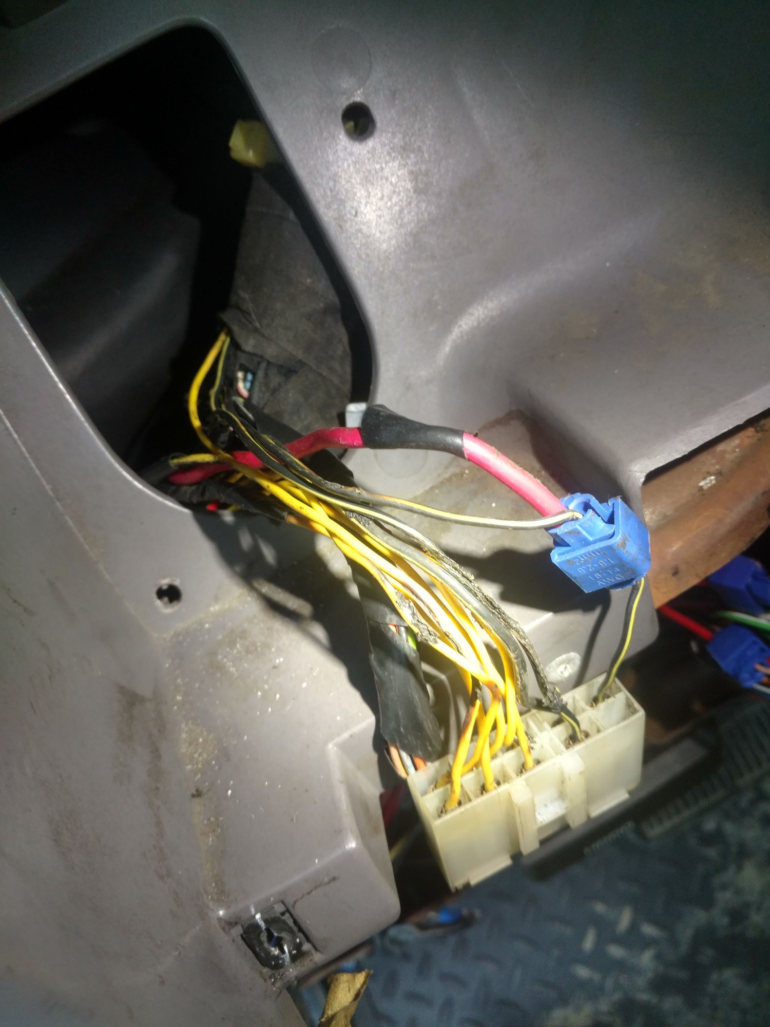

Well got both of them fixed! The 2nd problem was fixed by a new fuel injector on Cylinder #6. Used a BDW or BWD (I forget) and works great. Replacing the rest from the local company even the new one when I find out the flow rate. I'll keep the one I just bought for $41 as a side in the toolbox in the truck. 1st problem technically isn't fixed but it stopped. There is a joint connector behind the gauge cluster
when it is bent the problem occurrs if the plug stays straight it goes away. Going to dig in further when I'm bored. I'll keep this thread updated as I find out more. You can see the PO (who was a kid in his 20s) wonderful fix for wiring there is suppose to be another black and yellow woww in the blank spot
