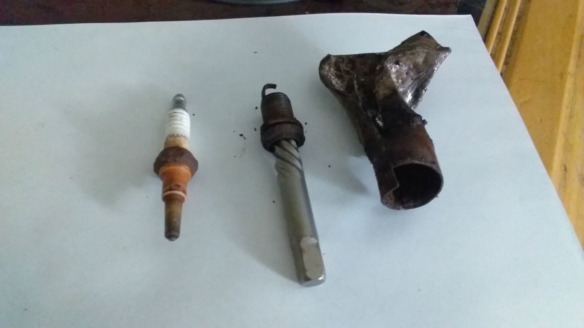

Old Jul 17, 2018 | 11:06 AM
tdvs38's Avatar
tdvs38
Joined: Jul 2018
Posts: 18
Finally got the heat shield off and it was a btch, no room to work on it but got it and used an easy-out and the threads came right out. Thanks for the input.
Old Jul 17, 2018 | 11:19 AM
tdvs38's Avatar
tdvs38
Joined: Jul 2018
Posts: 18
Champion plug. Bla
