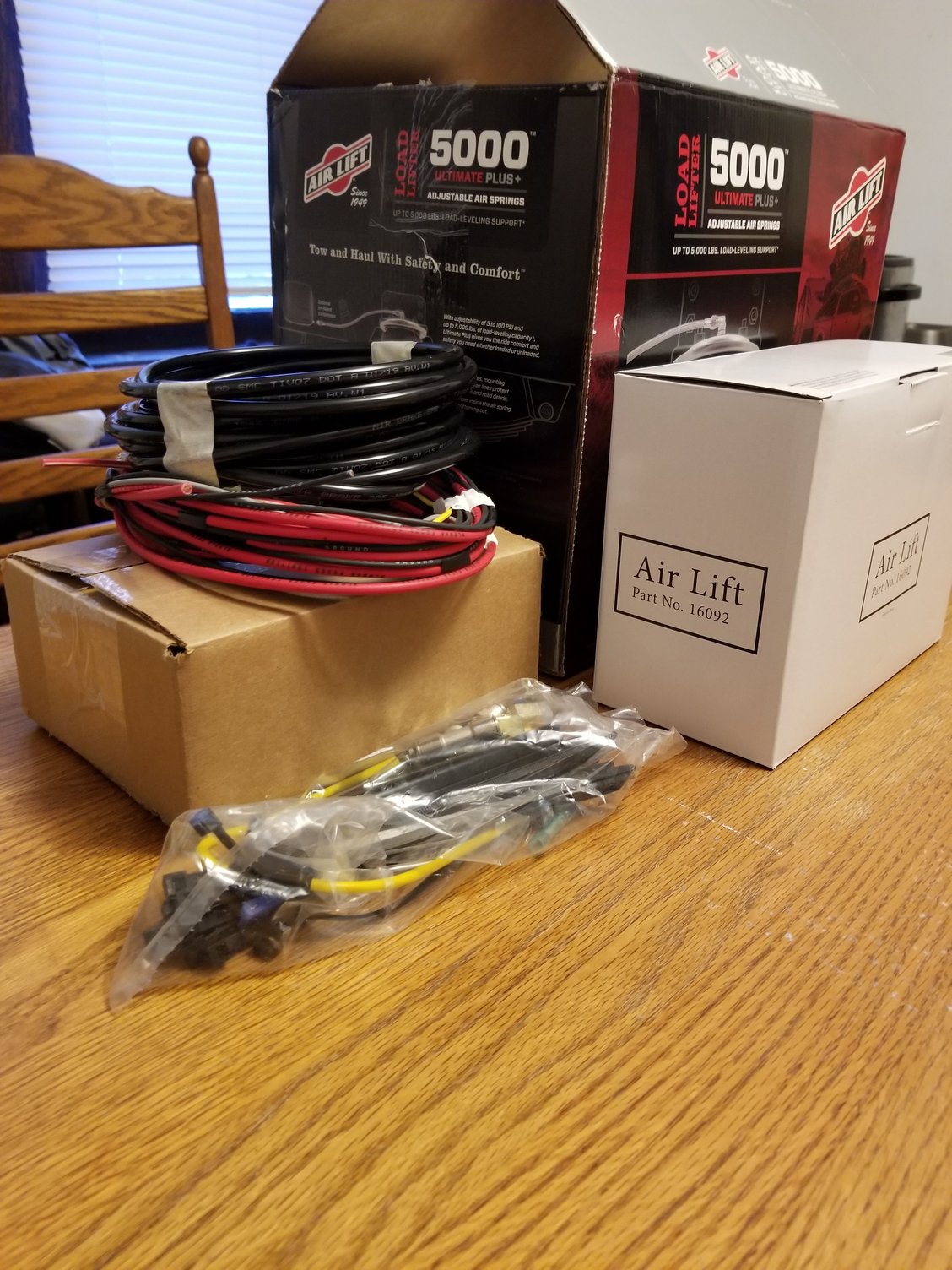

The package was...air bags for the rear with wireless air control and on board air!
