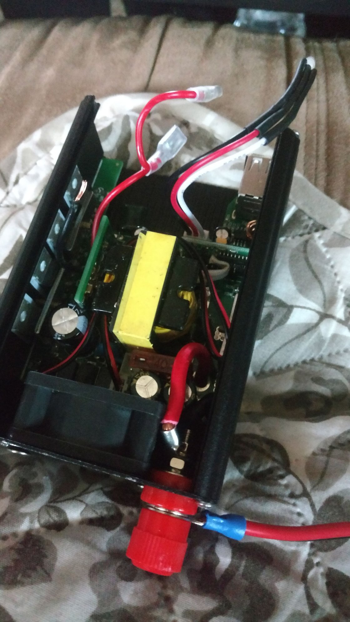

This is my take on a write up on installing a 3000W peak/300W continuous inverter from eBay in my truck
Difficulty: 6 out of 10
Knowledge need: Soldering Skills, Knowledge of Printed Circuit Boards, Wiring Knowledge
Truck: 2001 Ram 2500
DISCLAIMER: I AM NOT RESPONSIBLE FOR ANY SWEARING, FAILED RELATIONSHIPS, BEER DRANK, OR YOU BURNING YOUR TRUCK DOWN! Let's Begin!
Now the main body of the inverter will be mounted behind my dash. There will be a panel mounted to the dash under the 10" Alpine Radio and above the cup holders.
Please Note: I have an Aftermarket Fuse/Relay Holder and everything gets fused in their. Also my diagrams are crappy. My laptop took a crap on me and I ordered one. Once the gets here I will make a more detailed wiring diagram (Better then the FSM) and upload the mount into my CAD program. I make diagrams for all the accessories and they go into a FSM I made so if I ever sell the truck or take it to the shop they have diagrams to follow.
Here is the body of the inverter:
The only thing that will be mounted to the bracket. This was the hardest part as it wasn't made to be separated from the body along with the switch:
Here I am extending the LED, AC Plugs, Switch Wiring, and USB ports ( 1 1A & 1 2A). I use different color wiring with tracers for everything in the truck (nothing use the same combination) so they are easy to identify. I solder them covered then in electric grease and used adhesive lined heat shrink for a 100% water tight good connection:

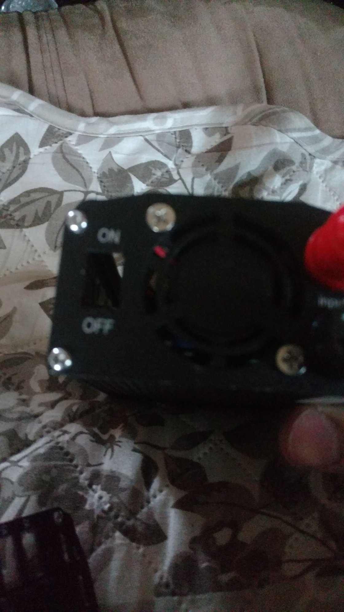

When the switch originally was (on the back):
Here I cut of the power outlet plug and extended those wires to be hard wired into the truck:

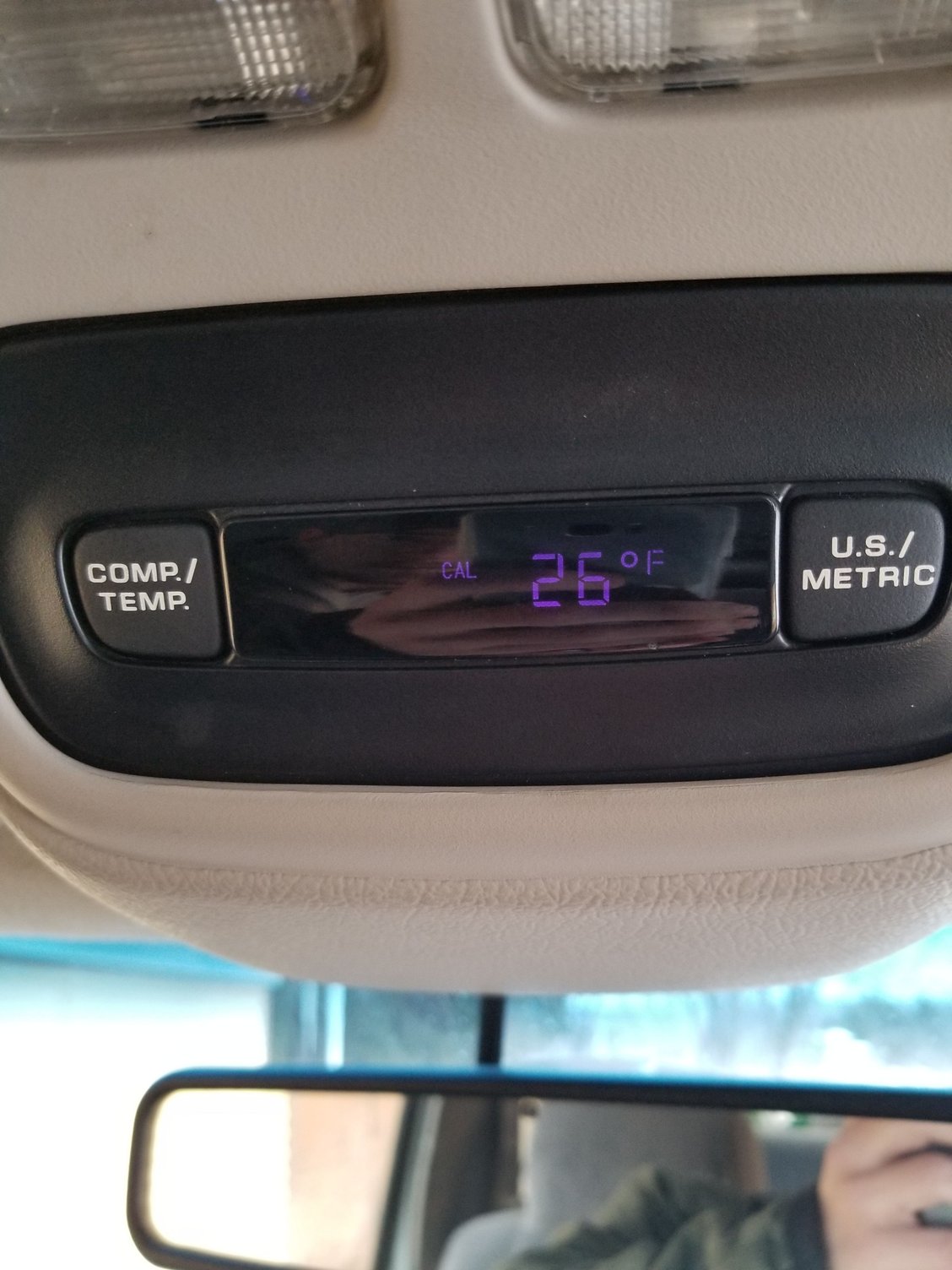

Finally changed my overhead console to purple:
Picked up a package today at the post office, anybody guess what it is?

How did you do that????
Old Mar 7, 2019 | 07:16 PM
  #110
MoparFanatic21's Avatar
MoparFanatic21
Veteran: Marine Corps
Joined: Nov 2014
Posts: 8,098
Likes: 318
Using a gel paper. It's mostly used to filter lights for theatres
