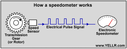

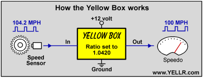

My speedo is off since I've put the 20" wheels on the truck. I was searching around to see how to adjust it, and found this trickery.... Thought you might find it interesting...
https://yellr.com/yb_home.htm
