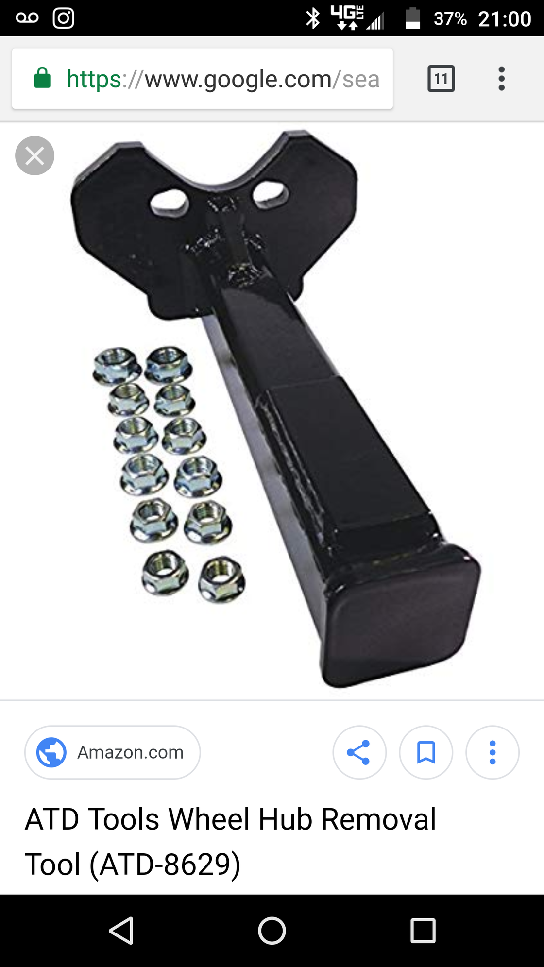

I use a Chisel and pound it between the axle C and the hub. The top on my hub has a notch in it (maybe for this reason?) But I go in there first using a 5 pound mini Sledge. They make a tool ghost removing hubs toy could make if you can weld. You bolt the part with the holes to the studs and on the square tubing hit it with a hammer (see where they welded a plate). Then before you install the new one use antiseize and it will come right out.
