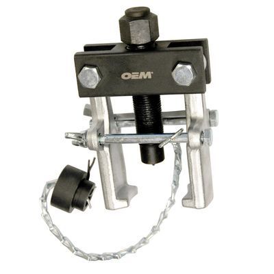

Anyway, rent a pitman arm puller and get crazy tension on the bolt, then start whacking. In between whacks, heat up the tie rod until glowing. If that fails, get new tie rods.
Yeah, know what that tool is... I just returned that tool about two weeks ago! The pitman I rented it for didn't come off either. I seem to have separation challenges over here. Haven't had time to do much about it, work keeping me busy this week. So with that tool clamped down, there will not be access tot he side of the tierod, where are you directing the blows?

Once the puller is on you whack the end of the bolt of the puller. The bolt should be pressing on the stud so it forces it out. Same concept on the pitman arm. I actually got my pitman arm off in a parking lot on my back. Was surprised since it hadn't been touched since 99! But the tie rod gives a little which distributes the blow and the angle is bad, I know. Might be best to pop the TR off after all.

I just picked up that puller again... I may just try to tap on the tie rod while applying pressure to the shock bolt, and see if I can get it loose, I'm wondering if there will be any room to even get the puller on there - let alone hit the top of the bolt.
