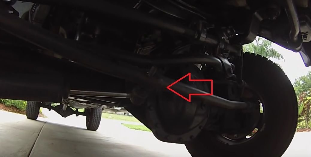

Its dark, so I just lazily screen grabbed on someone's video... You can see where the dampener mounting bolt goes through the rod. I suspect that I can't drive max vibration with the BFH while its on the truck. Haven't touched it today, but did source a 12mm bolt for the other side - it was rusty enough I didn't want to clean and reuse.
I don't have an oxygen acetylene setup, invested in plasma instead. I was kicking around the idea of using my TIG, and put 200 amps on the bottom side of that bolt - that'll surely get it a little hotter than propane.

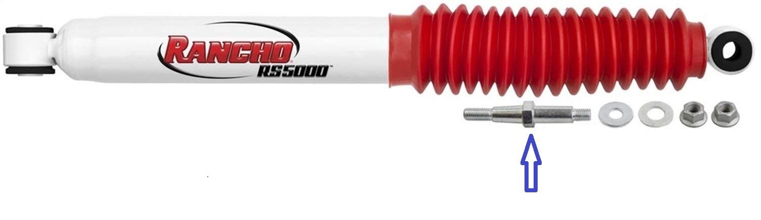

The existing mount doesn't have a spot to stick a fork in there. The new bolt does, and flat spots to twist it as well.... Maybe I could put a couple flat spots on it and get a wrench on it and start twisting it a bit to get it unfrozen...

Thanks for the clarifying photo. I think a quality long barrel air hammer with a punch or hammer end in it would take care of it.

Good suggestion... but not sure I have room for my air hammer in there, I know the IR composite impact wrench didn't fit. Truck is stock 8800lb height.... the picture is from someone who added 6" lift prior. Also watched the video a bit longer... side note he makes is he put on all brand new MOOG components a year ago... so that is probably why he had a easy time (he hit it 12 times and it dropped out).
