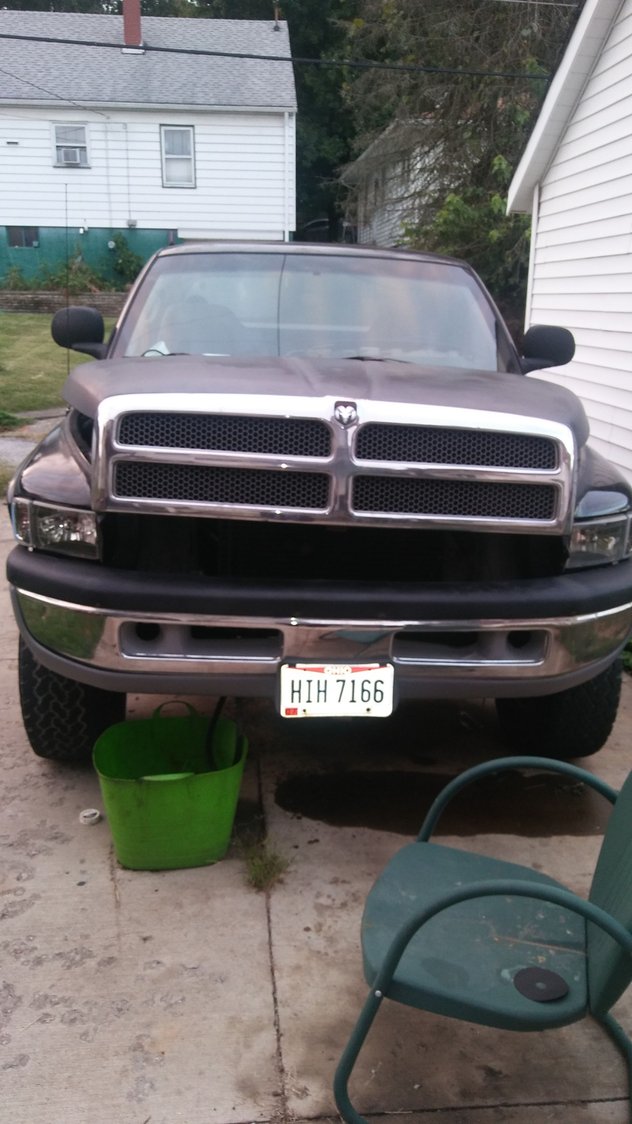

So heres the deal i blew up my 360 magnum its toast anyways i got this LA motor from a dodge charger for next to nothing with an edelbock intake and carb and aawj heads I thought everything wold pretty much transfer between the got to the intake was going to use the rams fuel injected intake but sadly it just dont quite line up almost so i was wandering what I would need and have to do to make the conversion to carb.
