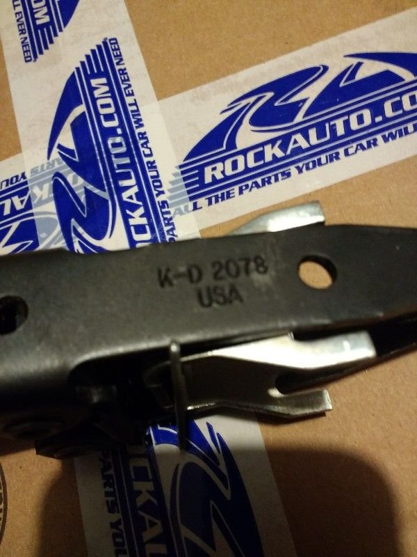

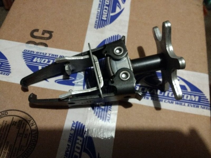

I was near the toolbox, so here is the tool I bought years ago. This one worked nice for me, on a few engines.

Maybe get a better version of it, like the one pictured in fj5gtx's post. That looks EXACTLY like the one I use.
