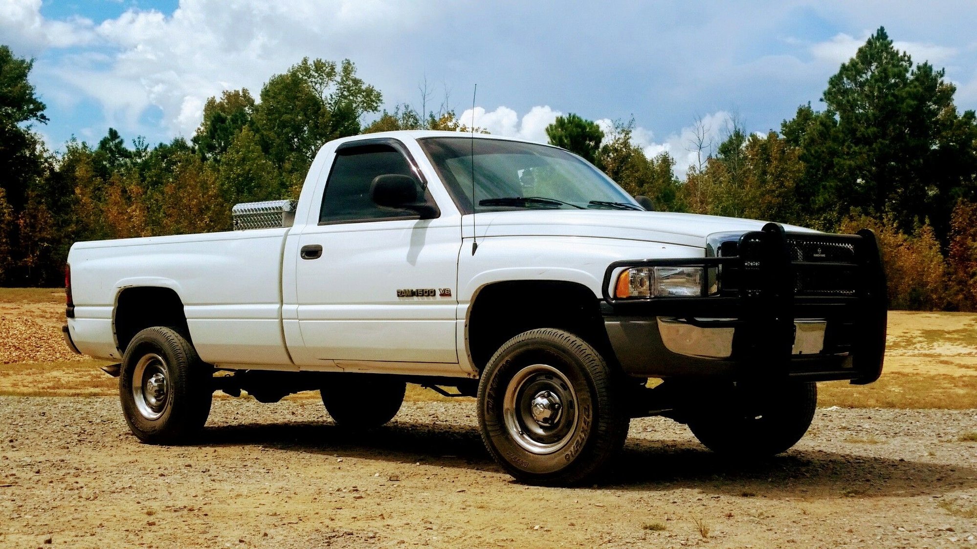

This is my pickup after the ranchand, but why does all rear lift block kits have the pin on top of the block when mine needs to be on the bottom?

I have installed the blocks already, truck sits down in the rear, just a wee little bit, looks good to me but their again I have only drove it about 500ft. The truck is at 41in from the floor to the fender all the way around. I don't know what to do, the blocks on ebay or anywhere else have the pin on top of the block too, but I need it on the bottom.
