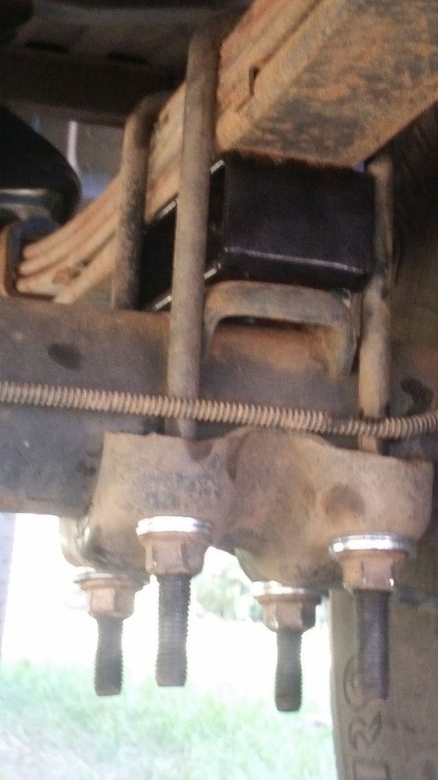

Call whomever you got them from, verify they are correct. (which might be an exercise....... if there aren't any markings on the blocks themselves.) Considering they wanted you to stack the blocks, but, doing so would have one block angled off from the other, that strikes me as a recipe for disaster. If the blocks shift due to the angles they are at, relative to each other, you would lose control of the rear axle, and 'bad things'™ would quickly follow.

How about some photos of the blocks so that we can see what you're working with? Have you contacted the Rough Country with this issue?

Here are a couple of pics, Im gone get new u bolts and put the oem blocks back in. I will contact rough country and see what's up.

Here are the blocks I got with my kit

Who knew that rear axle u bolts are so hard to find locally lol, anyway I just cleaned up the original u bolts and reinstalled everything back the way it came. Thanks for the input guys!
