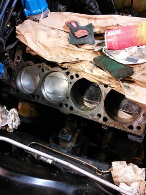

Alrighty boys, my 5.9 has 111k on it. Recently changed the plenum and added the new thicker plate. Shortly after that I added new plugs and scoped the cylinders and saw coolant. Figured the junk stock heads had a hair line crack, so put new eq heads and did the whole job over again. About 1000k after doing the work I checked my oil, down about 1 quart. I am running mobil1 synthetic 10w-30. I scoped the cylinders again 1 and then went to 7 & 8. 7 & 8 are starting to show carbon on top again 1 was ok. I cleaned the crap out of all the pistons tops when I installed the new heads. I have a new Mopar PVC.

Picture of 2 of the pistons cleaned earlier in the year.
