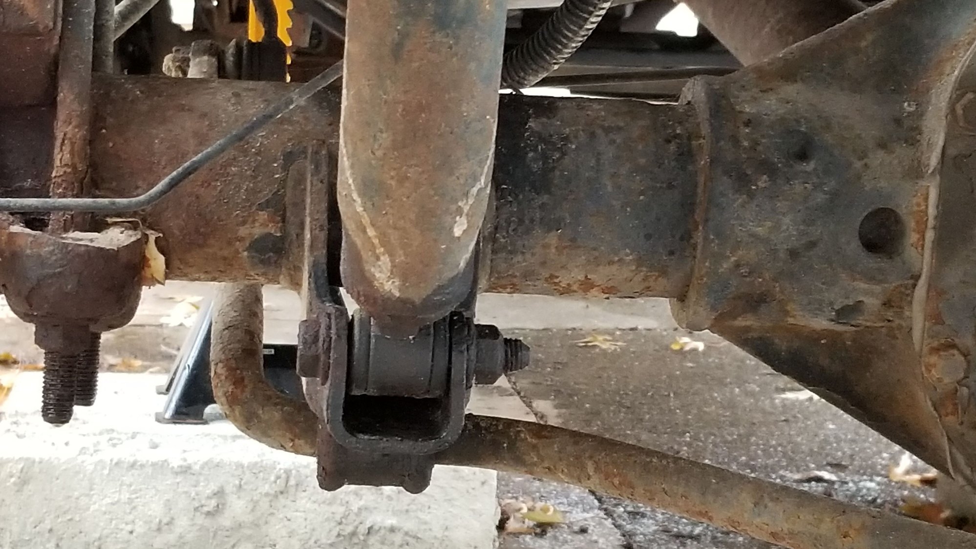

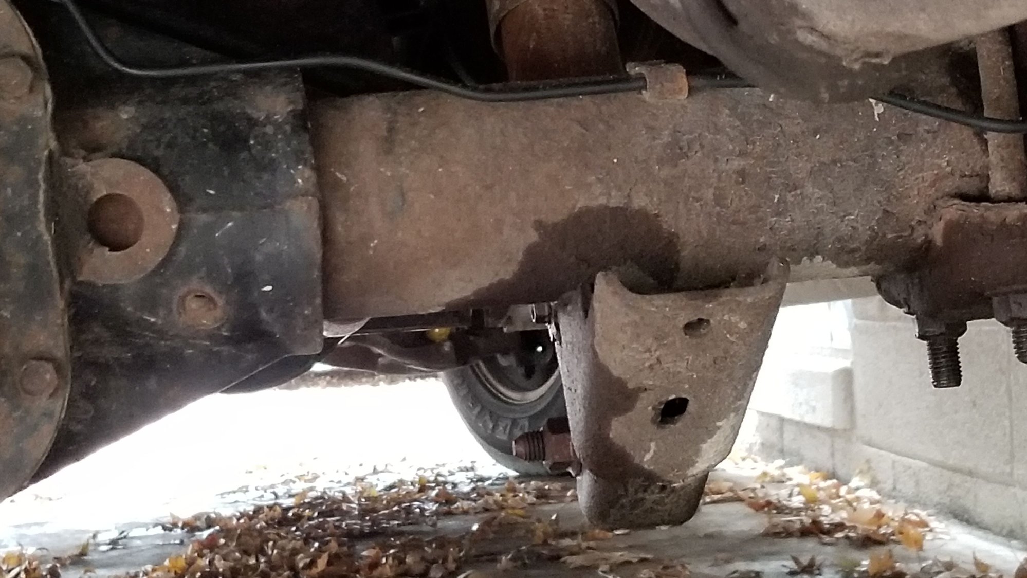

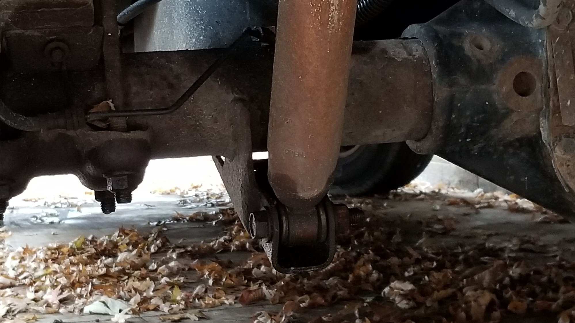

Anyway, I was looking at both axles and noticed the donor 4.10 Dana 60 has shock mounts that sit parallel to the ground, whereas the current 3.55 Dana 60 in my truck has mounts that are welded angling toward the front (LH) and rear (RH). I'm wondering if the sway bar is going to be able to mount back up to my current truck. I'm also wondering if the camper special package (which I think the donor truck has) got a specific rear axle with these mounts welded parallel to the ground to compress the shocks a bit more due to the factory lift blocks. Unfortunately, the donor axle will probably cause both of my rear shocks to be slightly more compressed at all times.

Good eye on checking your rear shock mount configuration. That sway bar should connect up fine on your truck, as long as you have the sway bar link mounts on your truck's frame. Have you pulled the Dana 60 4.10 rear from the donor truck? If not, be sure to grab the sway bar link frame mounts and bolts off of it - I had to find those frame mounts and it took some serious searching (they are NOS), as I picked up the rear sway bar used and had to purchase the rear sway bar links and the sway bar link frame mounts + hardware separately.
BTW, if you haven't already done so, be sure to purchase some new U bolts - those look pretty rusty and some may break during the removal.
