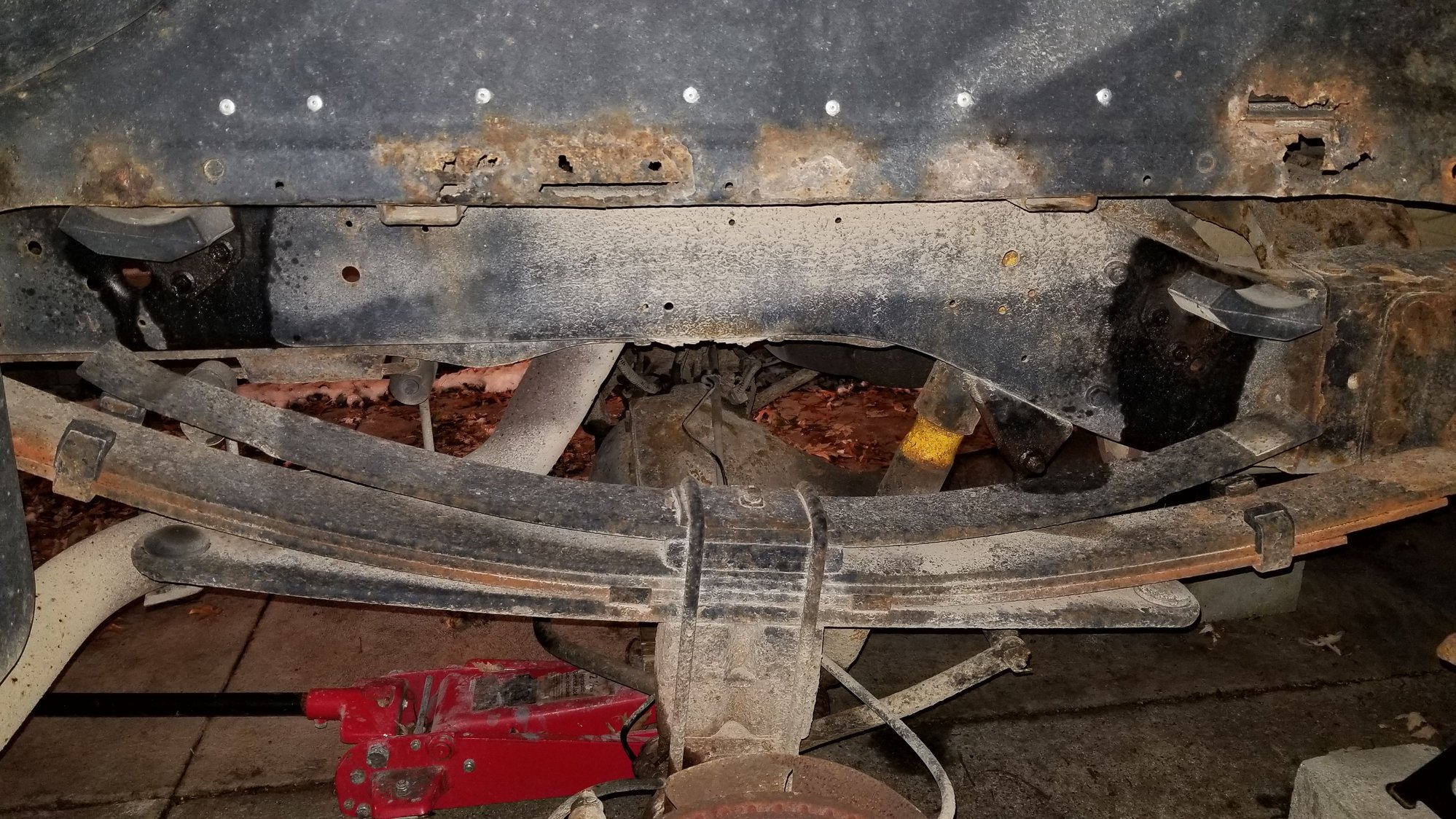

Picture of the sway bar and helper leaves I'll be getting out of the donor truck:

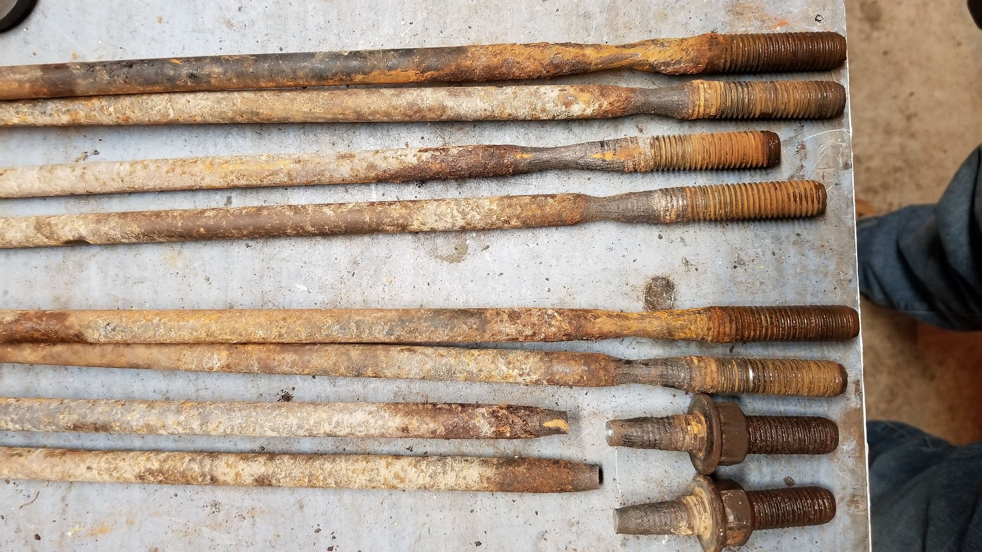

Since I also took the overload spring stops and sway bar brackets, I had a lot of hardware to remove from the donor. Here are some of the gnarly piles of garbage I ended up with. The timing of the project is actually really good, since I'm not sure some of the U-bolts would have lasted another winter. I drilled drain holes in the plates that cup the bottom of the axles to (hopefully) extend the lives of the new ones.
Replaced all the hardware with grade 8 nuts and bolts. 2WD swaybar links are a couple inches shorter than 4WD links, so I picked up a set of those as well.

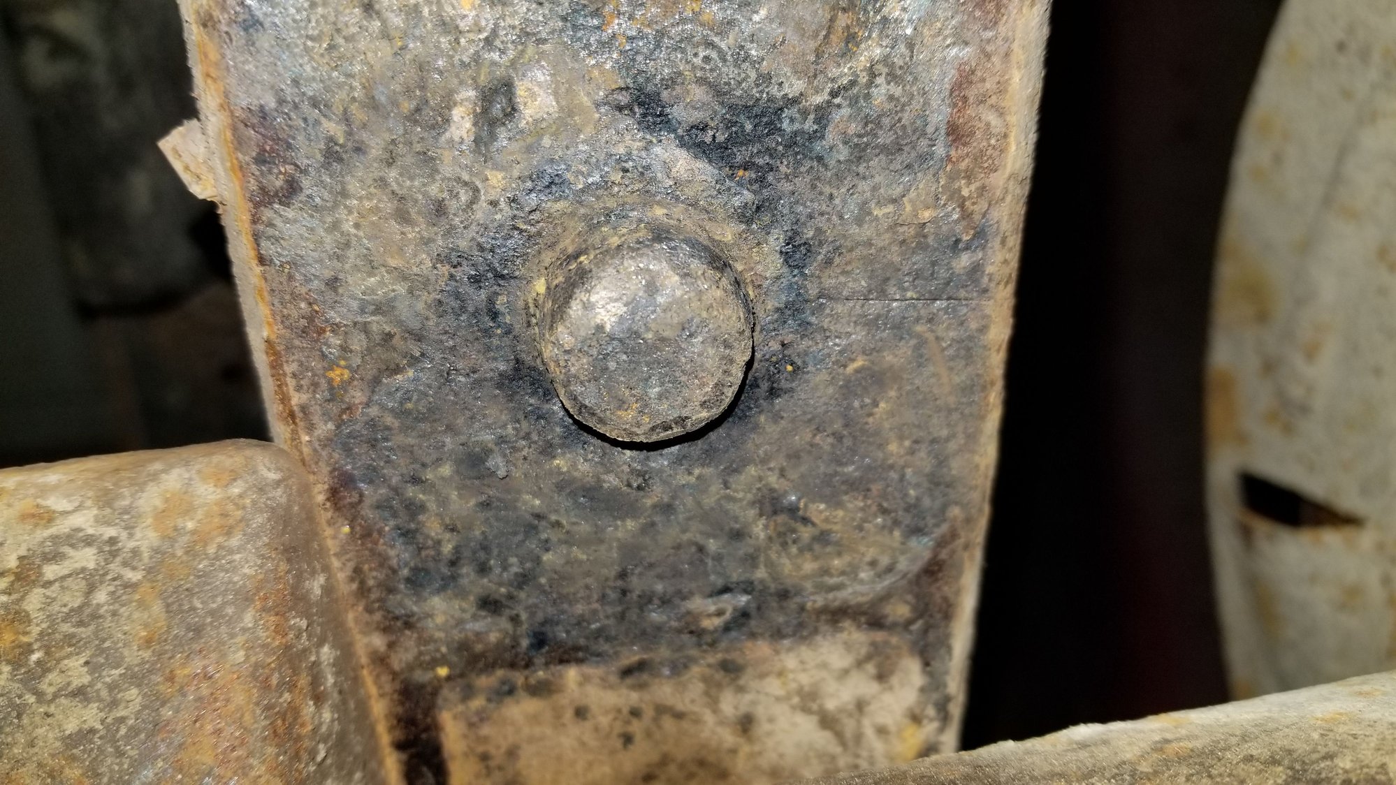

While I was lowering the center pin that comes through the bottom leaf into the perch, I noticed a hairline crack on the outboard side. Earlier in the day, I had been banging on the bottom of the spring with a hammer to remove some of the loose rust. Nothing crazy...I was just using an 18oz hammer. Could I have possibly caused that crack by hammering on it and is leaf spring steel that brittle? I doubt that it is, since the springs need to flex haha. I'm bummed about it though, since I replaced that leaf pack only about 4 years ago with a replacement from SD Truck Springs.
Next question: Do I even worry about it? That bottom leaf is technically an overload as well and with the overloads I just added to the top end, that bottom one is rarely going to see any action. It will just be in compression the vast majority of the time.
Old Dec 13, 2018 | 10:02 AM
Posts: 87,483
It wouldn't hurt to change it out, but, if that leaf rarely sees any weight, it's probably fine. Just keep it in mind when loading up the truck.

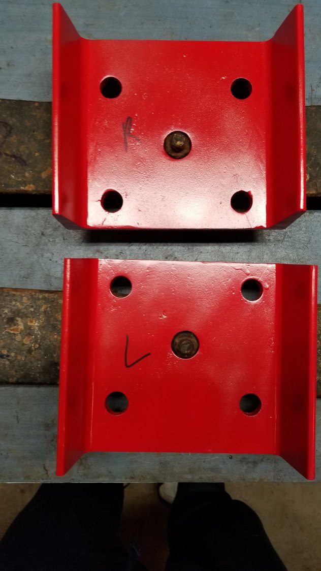

I wanted to make a final post about one of the problems I encountered when torquing my new U-bolts down. The donor axle I put in my truck had experienced so much rust/pitting that the axle tube was essentially a smaller diameter than it used to be. This caused the plate that attaches around the bottom to keep wrapping upward. I couldn't hit torque on my u-bolts and they kept bending outward. You can kind of see what was happening in this picture (and if I kept torquing, they just kept bending).
So I did the ol' U-bolt flip. Bought some 10" long, 3.5" wide round bolts and fabbed up some top plates from 0.400" thick, 7" wide U-channel. There are a few sets of Ford plates out there that will work, but why use some wimpy 0.250" plates when you can fab your own super heavy duty ones?! If anyone ever goes this route, just be careful about the proximity of the inside edge to your frame. It gets pretty close and I ended up having to cut a bit more off after I made them (one of the reasons they're lopsided).
U-channel I used vs. Ford plates
Finished product
Pre-installation
Installed
Upgraded to 5/8" U-bolts. I'm very happy with the end result and am confident that I have a setup that is going to keep my spring pack well attached to my axle for as long as I own the truck.
