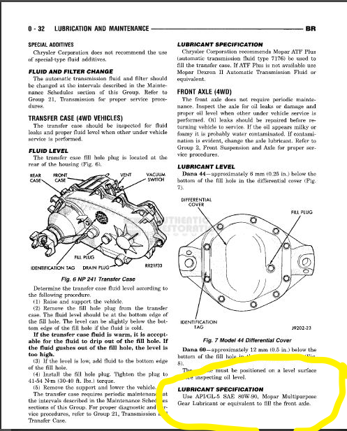

Here in the service manual it says the front takes 80w-90

Meh, my Chilton says 75 front, 80 rear, but it's not that big of a deal. It's like putting in thicker engine oil.

It won't hurt a thing, I run 85w140 in all of my differentials, the thicker gear oil provides better protection and quiets it down some.

My 2001 calls for 75w140 in front and in the rear either 80w90 for standard use or 75w140 for heavy duty/ towing.
i wouldn't worry about it
