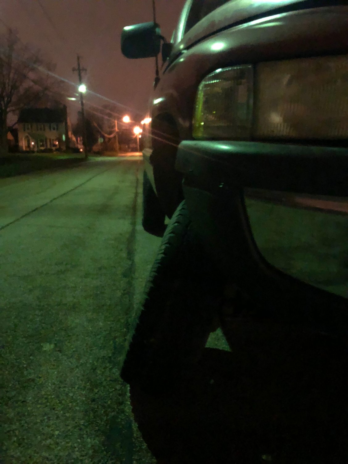

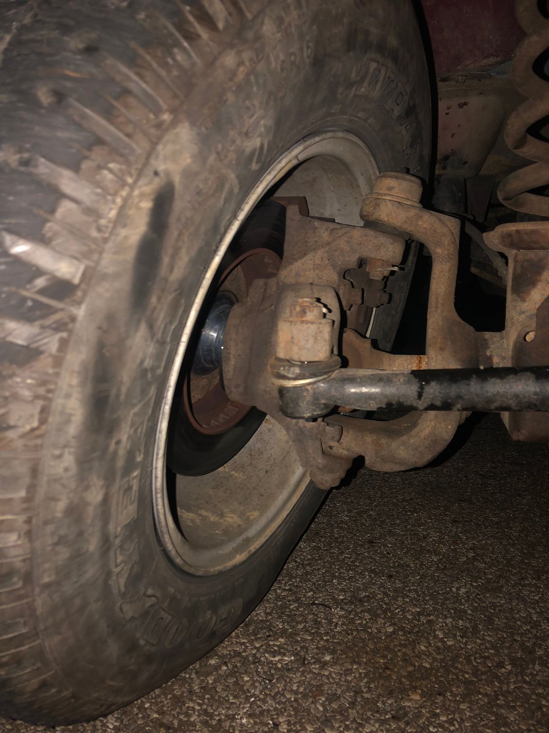

Well, I just got off the highway (thank god) pulled onto my street and this happened, noticed it, got out and saw it, but I had to get it home so I drove on it for another .5 mile I’m guessing....
At this point am I better off getting my money back out of it (as much as I can at least) and buying a different dodge? I love the brand, just not this specific truck anymore.
what looks to be the issue? I’m guessing the wheel bearing separated from the hub? I’m over all these problems....damn Problem Child

Wow. That's not supposed to happen....... Was it making any noise before it failed? Usually, they will be growling pretty loud long before they get to that point....
And yeah, that just the hub/bearing unit. Replace it, and you'll be good. I would be very tempted to take a very close look at the other side as well.

Ya, that thing was trying to tell you it needed help for quite a while & you weren't listening until it was too late. Be very careful & look over your brake caliper & holder, as you may have f*cked it up when the wheel went wonky. The caliper is the only thing that kept the wheel from coming completely off & taking the axle with it.
You don't need any special tools to fix it other than that big *** socket for the axle nut and a 12 point 13mm socket for the 3 bearing bolts. make sure you loosen that big nut before you jack it up, or use an impact driver. Since the hub will certainly fall out of the bearing housing when you remove the brake caliper, you need to use a big *** hammer and a big chisel to wedge between the bearing housing and the spindle.

Gotta be more in tune with your vehicle, friend. That thing had to be sounding like an airplane for a while. Definitely do both sides as the other is probably getting ready to let go too. I replaced my fronts with Timkens last year. 2WD is super simple. Word of advice when replacing, use a torque wrench when tightening. If you go too tight, you end up wearing out the bearings faster and you don't want to be too loose either. Quoting myself from my old thread, I drive a Dak, but I think torque is the same.
Just updating on the final outcome.
I ended up getting the Timken HA599528 wheel bearing hubs. I also caught a steal on front and rear EBC USR slotted rotors on Amazon. Installed them all this past weekend and the change is remarkable. Changing the hubs was very easy as I didn't have to deal with front axle shafts (2WD). One big axle nut (36 mm) and off they came. No cotter pin, no nothing. Torque was 185 ft-lbs. The noise is completely gone as is the weird tracking I would get during sweeping turns. Both old bearings were dry as chip, when spun by hand.
