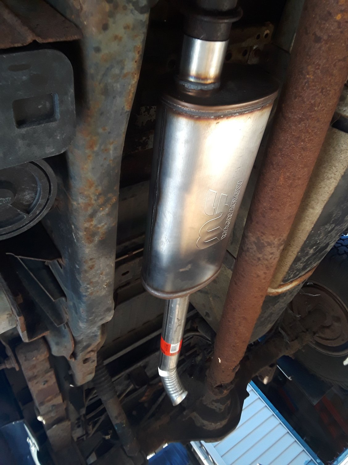

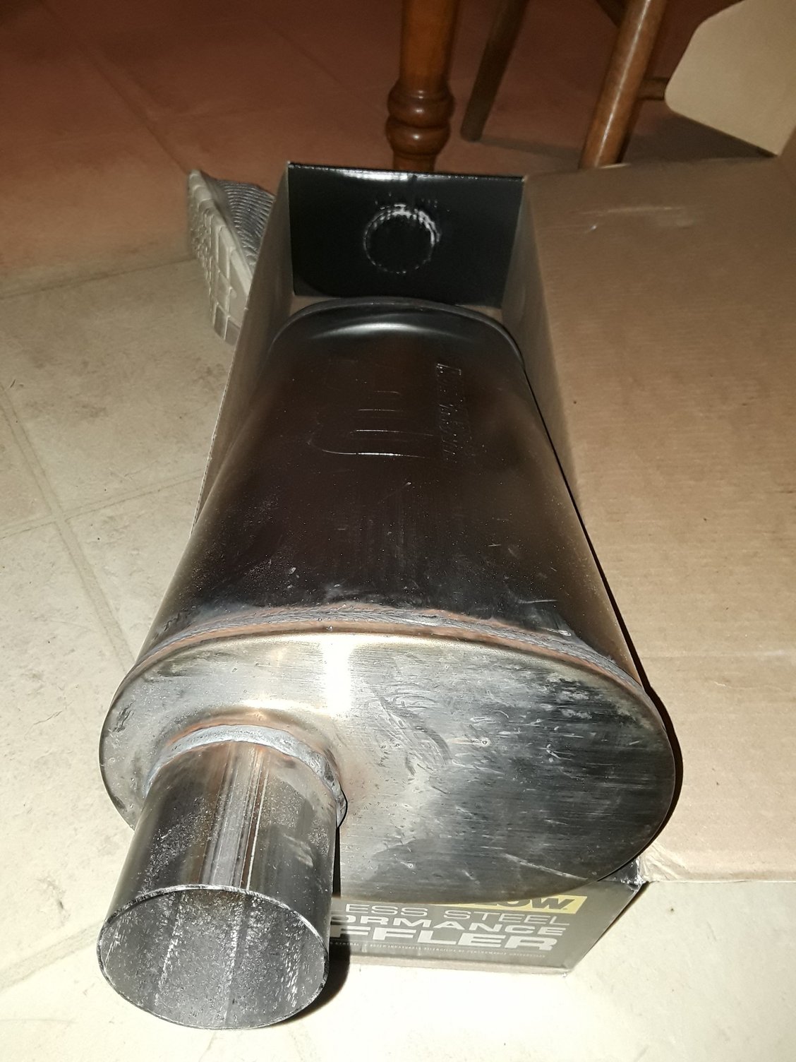

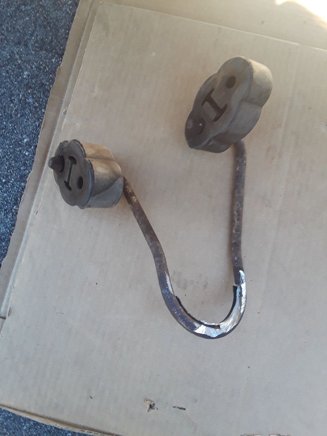

I installed the magnaflow muffler today... the old one seemed sorta loud and I thought the new one was gonna be too loud... it was actually quieter than the old one... hmmm... seems the old one had a good size whole. Funny!!!! But I do hear that low rumble they are famous for... not aggressive...no drone... whether I get increased HP or MPG I guess I don't care really after all.. I got a new muffler, and I did it myself with help from you guys on this forum..thanks... I didn't weld, used the factory hangers and bolted right up.... I cut the rear hanger off the tailpipe and grinded it down and the 24 inch turn down pipe I used
Magnaflow 12256 and 24 inch turn down
Rear/middle hanger cut off from factory tailpipe
Grinding, deburring and smoothing out cut hangar
Hanger ready for reinstall
fit right in... that I will get welded tomorrow... the other connections, I used clamps only and seems secure and no leaks.... I'll re check it later on..thanks again.
