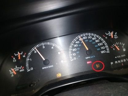

Now that I think about it, actually doesn't matter what the tire size if the speedo is uncorrected. My truck is a 2000 3/4 ton with 4.10s . Has 33" tall tires on it now, and the speedo tends to be 10% low. But with the speedo uncorrected, OverDrive enabled, and going 55 on flat, first pic. Second pic at 50 mph (a little slower, I sux), OverDrive disabled. I think this is proof that there is no way your trans is in OD. You've been into the engine, front axle, and now you get to explore the transmission... at least you don't have to go looking at the rear axle !
