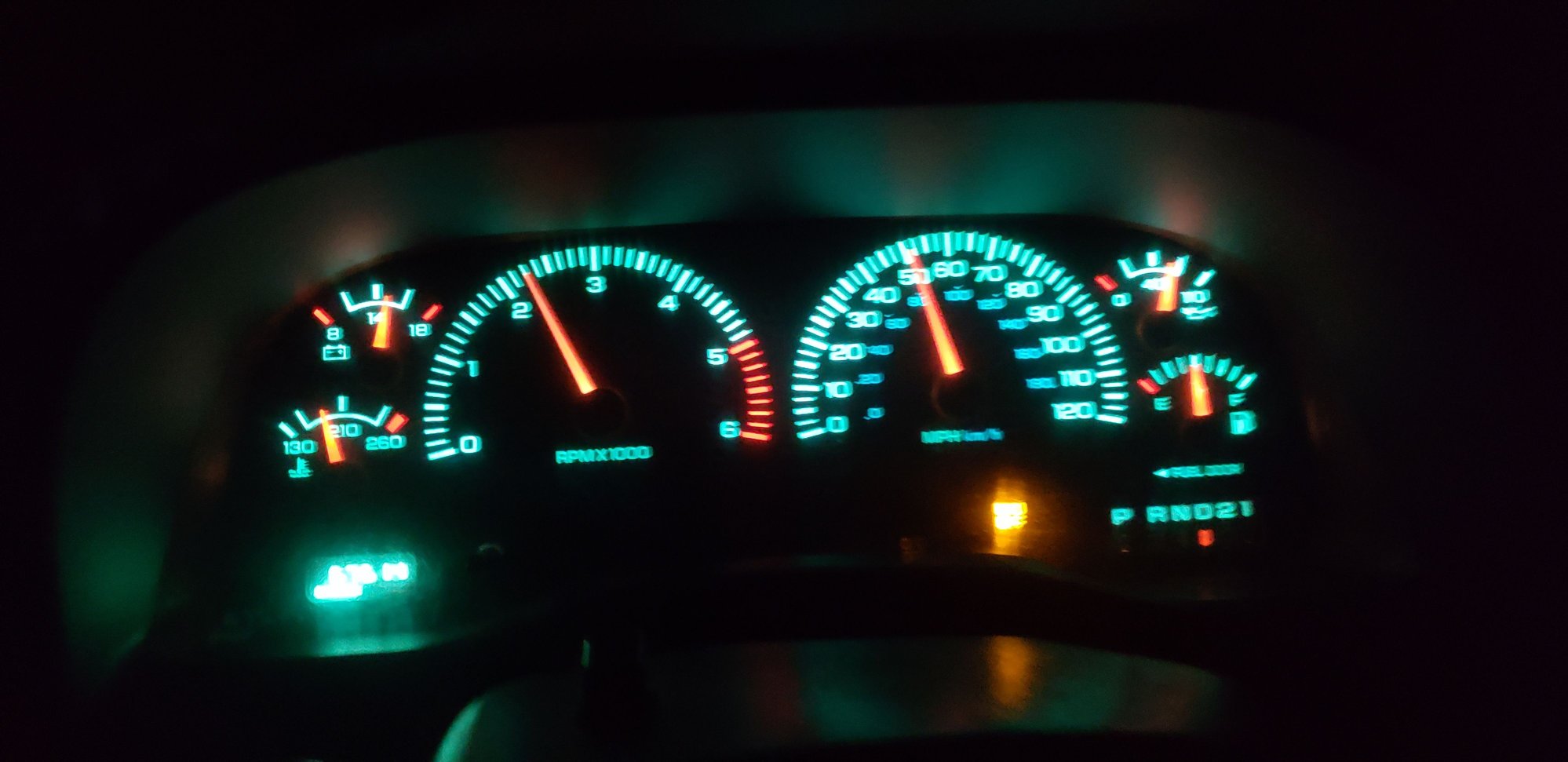

Overdrive button not pushed in. Turn truck on and drive.

Overdrive button pushed. Overdrive light shows its off. Rpms drop.
