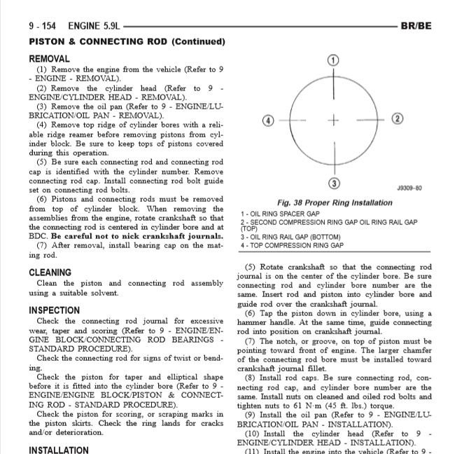

Can someone please provide me with the proper torque specs for the rod caps? I think autozones website said 45ft but I’d imagine there’s an angle as well. I got my plastigage and I’m ready to get into it today hopefully. Thankyou

This is moving pretty slowly Lets get the lead out!
Why are you not using the Factory Service Manual (FSM? Here is the page you need out of the 2001 FSM I downloaded from the DodgeForum. Note it says 45 ft/lbs on step #8.

Default whooops, v10 not 5.9 mag.. but same torque
Sorry wrong page, but right info... step 10 here.
