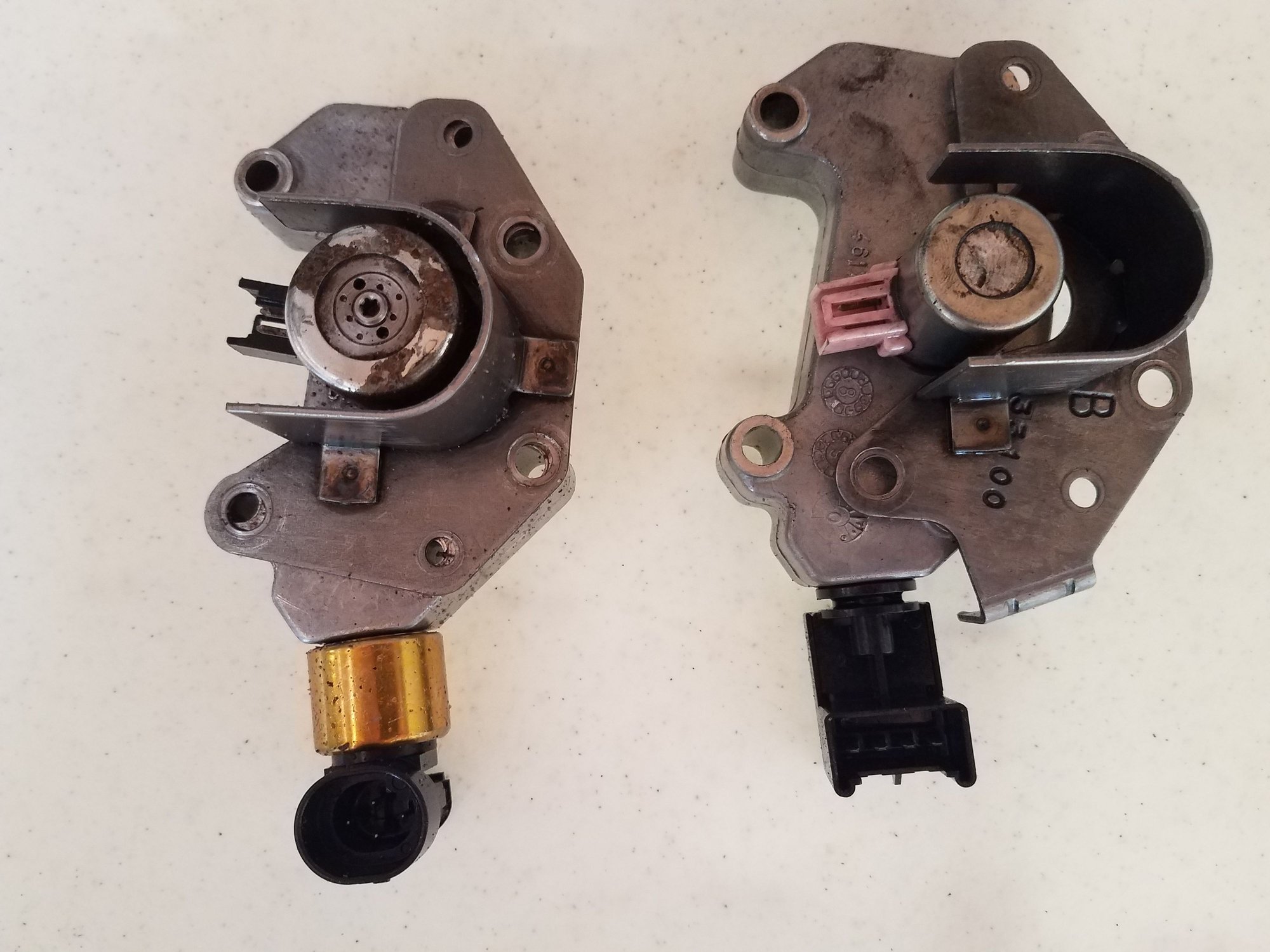

Sounds like you get sensors for a 00 and up trans. They are not compatible with the 99 and older PCM. Easy fix there though, just change 'em out for the correct sensors. (governor pressure sensor, and solenoid) Need the correct retainer for them as well. I believe the internal connectors are different, so, you may need to the O/D and TCC solenoid set as well.

Hey You,
You were absolutely correct. I finally got to drop the tran pan and get a look at the solenoids. I am attaching a photo of the two governor body assemblies. The one on the left is from the original transmission of my 96 dodge ram 1500 5.9L 4X4. The one on the right is from the crate transmission.
I found a source to splice in a new connector for the wiring harness, which seems much simpler than dropping the transmission, and separating the overdrive housing just to be able to drop the valve body to replace the external connector.

Well Boys and Girls, Hey You is correct again.
I dropped the valve body and changed the solenoid wiring harness and the pressure sensor and governor solenoid. My biggest worry was getting the parking rod back in but everything just slipped back into place.
Obviously this corrected the lack of overdrive and the trans temperature light issues. However I still have a stutter around 45-50 mph.
