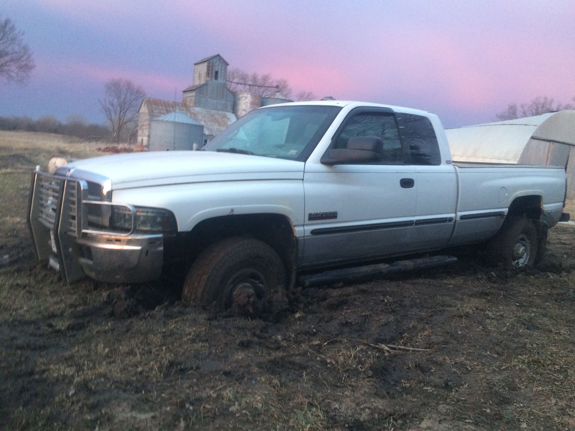

1999 2500 5.9L Cummins Automatic, everything stock. In need of some help, so Front driver side axle snapped just distal to the splines, due to the way it snapped it shoved the broken end hard into the spider gear. Anyway I am unable to remove the 5 inches of broken shaft from the spider gear. I am able to remove the shaft on the other side and spider gears without a problem, just stuck on drivers side spider gear. Any advice or ideas would be greatly appreciated, thanks.

How in the heck did that happen?? Can you pry it out?
Lol got it really stuck in the mud.

That had to be weak to begin with as they don't normally break there
