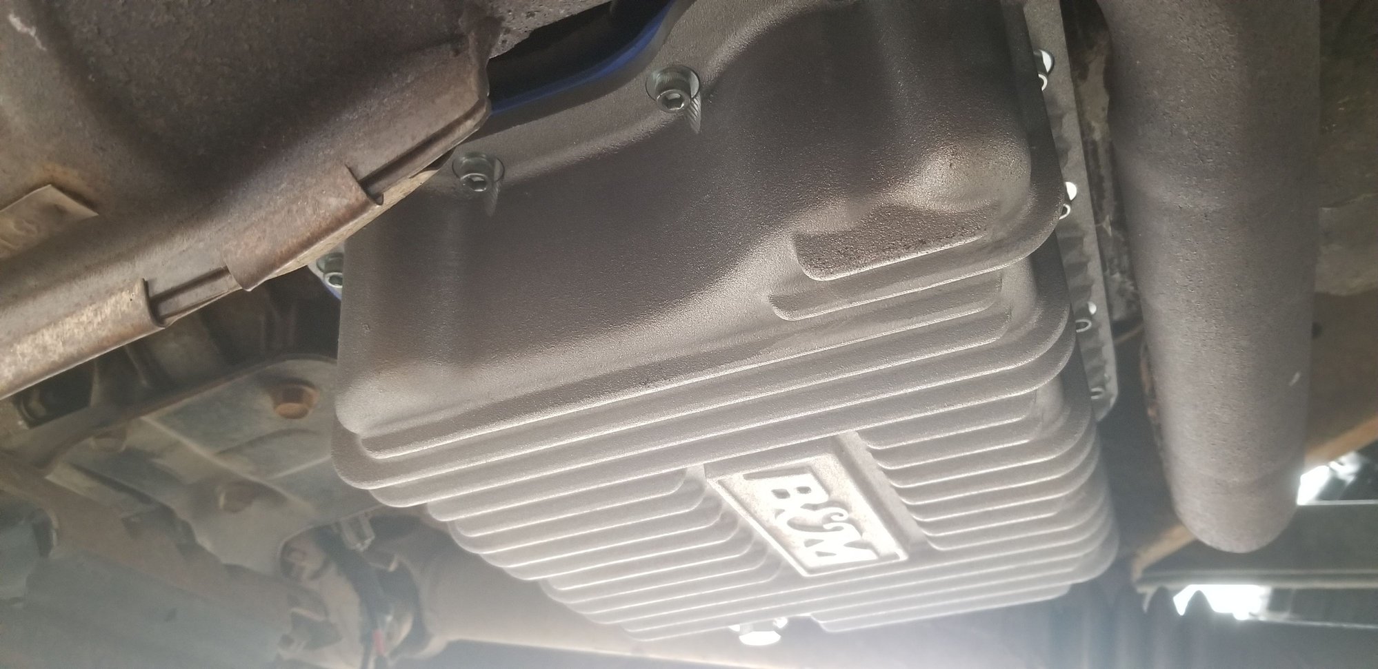

The real question is how long is my tranny going to last running those tires with 3.55 gears?
I just installed a deep pan. Looking into the trans cooler next

Keep the trans cool, and you should be OK. External cooler is a good idea. Temp gauge wouldn't hurt either.
What is best way to run the coolers? By pass or after it comes out the rad?

I always plumb the cooler in line after the radiator.
Right on! Thats the way i want to go.
Why after I wonder? (unless running thermostatted...). I was under the impression (but have never checked personally with measurements) that the radiator cooler would serve to warm the fluid and help maintain a constant temp when it was cold out and so should be last before going back to the engine? Of course it wouldn't matter if you were running a good thermostatted bypass...
