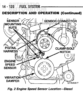

Engine Speed Sensor - PCM input, magnetically senses the notch in the vibration damper as it spins.
Page 14-120 of the service manual.
Ah it's a diesel that explains it.

I replaced the sensor and everything works perfect now.
To be optimistic...
I now know a lot more about this truck and own a spare PCM in case mine ever fails.
