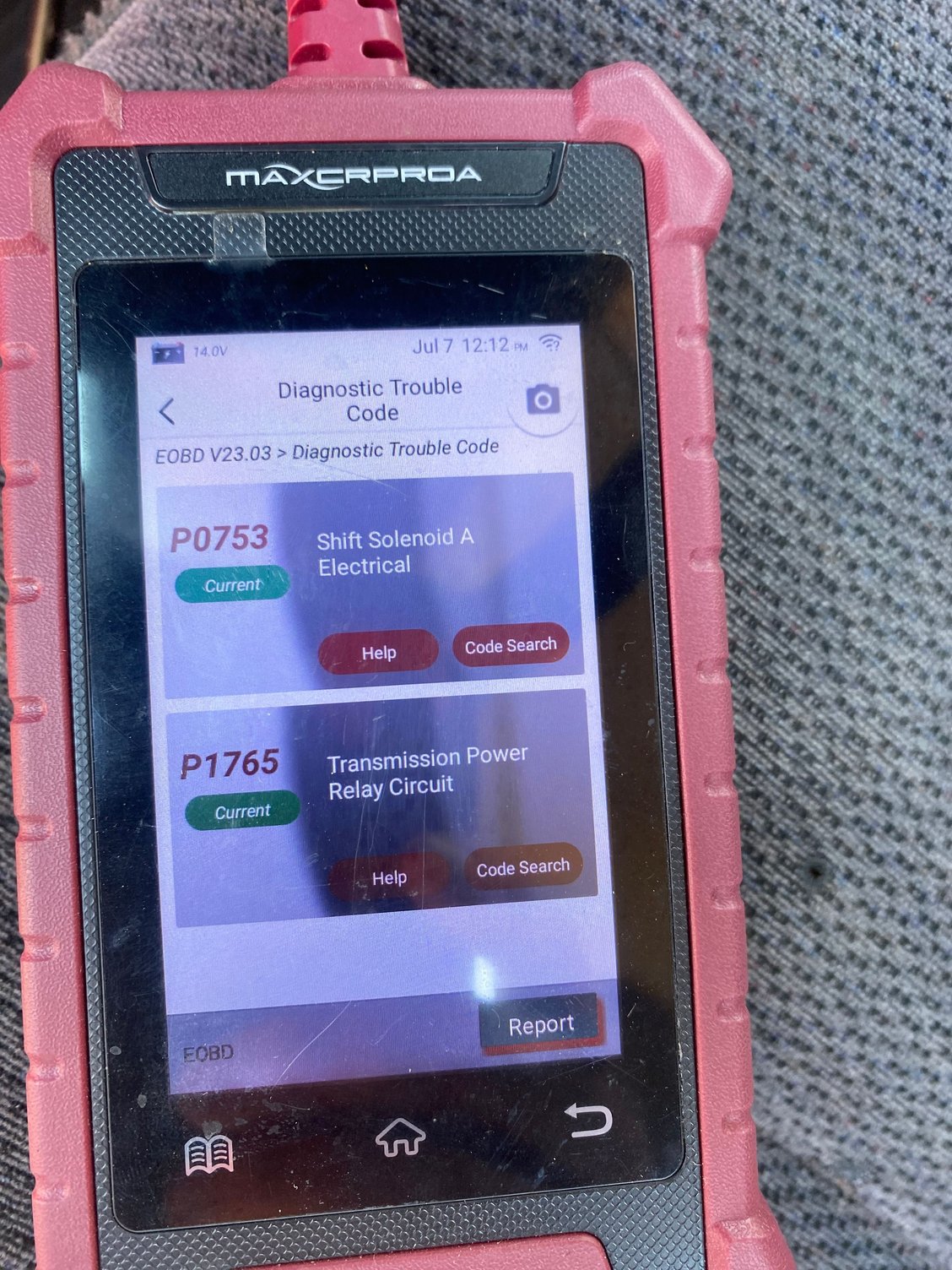

Default P0753 and P1765 codes are showing seems to be in limp mode not shifting correctly
Originally Posted by LunaEros
Does anyone know Hydrashocker's test of pulling the 8 pin connector I've seen him say to test if it is an electronic or mechanical problem?
"There is a way to see if your issue is electrical or mechanical on your transmission 42-44RE. Testing instructions for 42RE, 44RE, 46RE, 47RE.
By doing this you will not have an automatic transmission, you will have to shift it completely manual and you will have no Overdrive!
Get under truck on the drivers side and unplug the 8 pin harness from the transmission near the linkage input into the trans, (this is the main plug to the transmission). Start your truck and back out or what not. Now drop the gear shift selector without stopping all the way down from reverse (or Park) to 1st and hit the gas. You should be going now running in first gear. Now shift with the selector to 2nd gear, then into Drive. If everything shifts fine then your issue is electronic, if it shifts the same then it is mechanical.
If the problem is electric:
1. Replace the Output Transmission Speed Sensor.
2. Check the 8 pin harness you disconnected for corrosion.
3. Replace the 3-4 shift solenoid."
I am wondering if anyone knows if pulling the trans control relay in the junction block would accomplish the same thing.
I've also read on here that if the problem is electrical that the relay can be jumped to bypass it as a semi permanent fix until it can be fixed.
Really hope someone is on since I kinda need an answer now.
Old Jul 8, 2024 | 02:47 PM
Posts: 87,548
Likes: 4,230
1765 Needs to be addressed first. None of the solenoids in the trans are gonna work if they aren't getting power.
