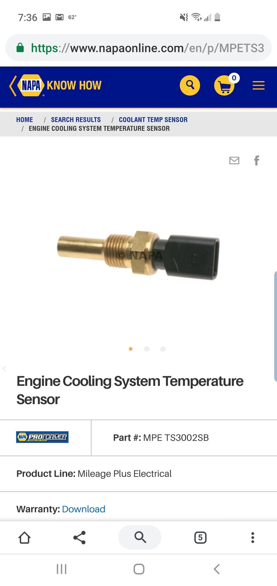

Not sure but used one of these two sensor from napa auto if that helps with brand issues or if you guys have any suggestions of what brand and where to get from

Of course I clicked on the same picture but the other was a echline ignition type of sensor I'm would assume to find someone who carrys comman name like Bosch
