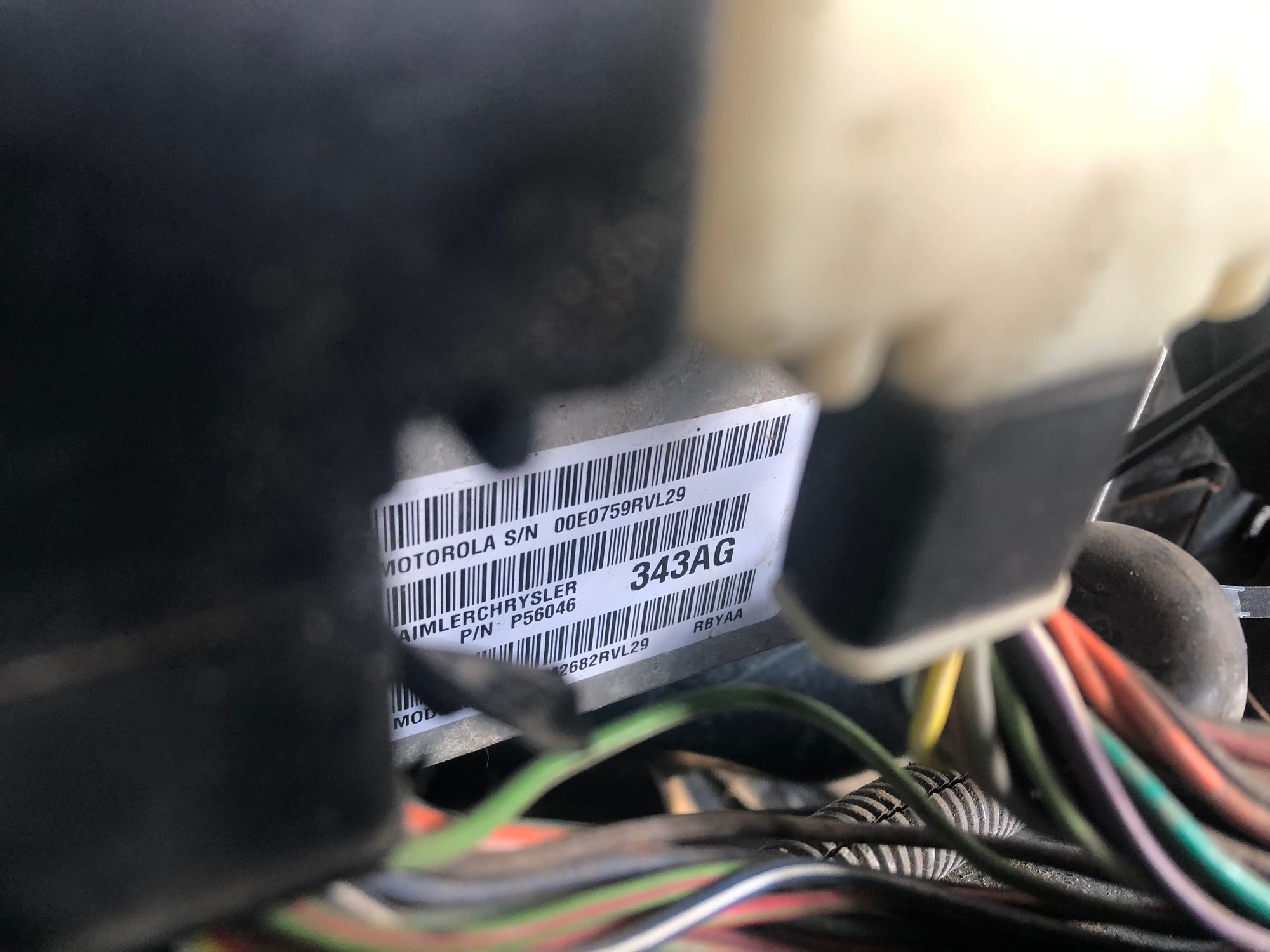

I don't think thats the part number for the PCM, maybe the software revision installed?

Part number is P56046343ag. The ag is just what revision it is. That label looks awful clean though.... Did you wipe it off to make it legible?
Nope, that’s just how it was. Seems pretty clean. I’ll go look at the cam sensor now and see if that has any rough looking wires or maybe isn’t plugged in all the way. Probably not but I’m tight on cash, won’t be able to get that sensor for another week and a half

Original PCM as well?

How can I tell if it’s original or not?
Might be a dumb question, sorry lol

I'm going to guess you haven't changed it. That label looks awfully clean to be original though.... How long have you had the truck?
Since July 1st

Well, since you are getting a code for VIN mistmatch.... I am going to guess that the previous owner swapped it out, trying to solve some issue......
