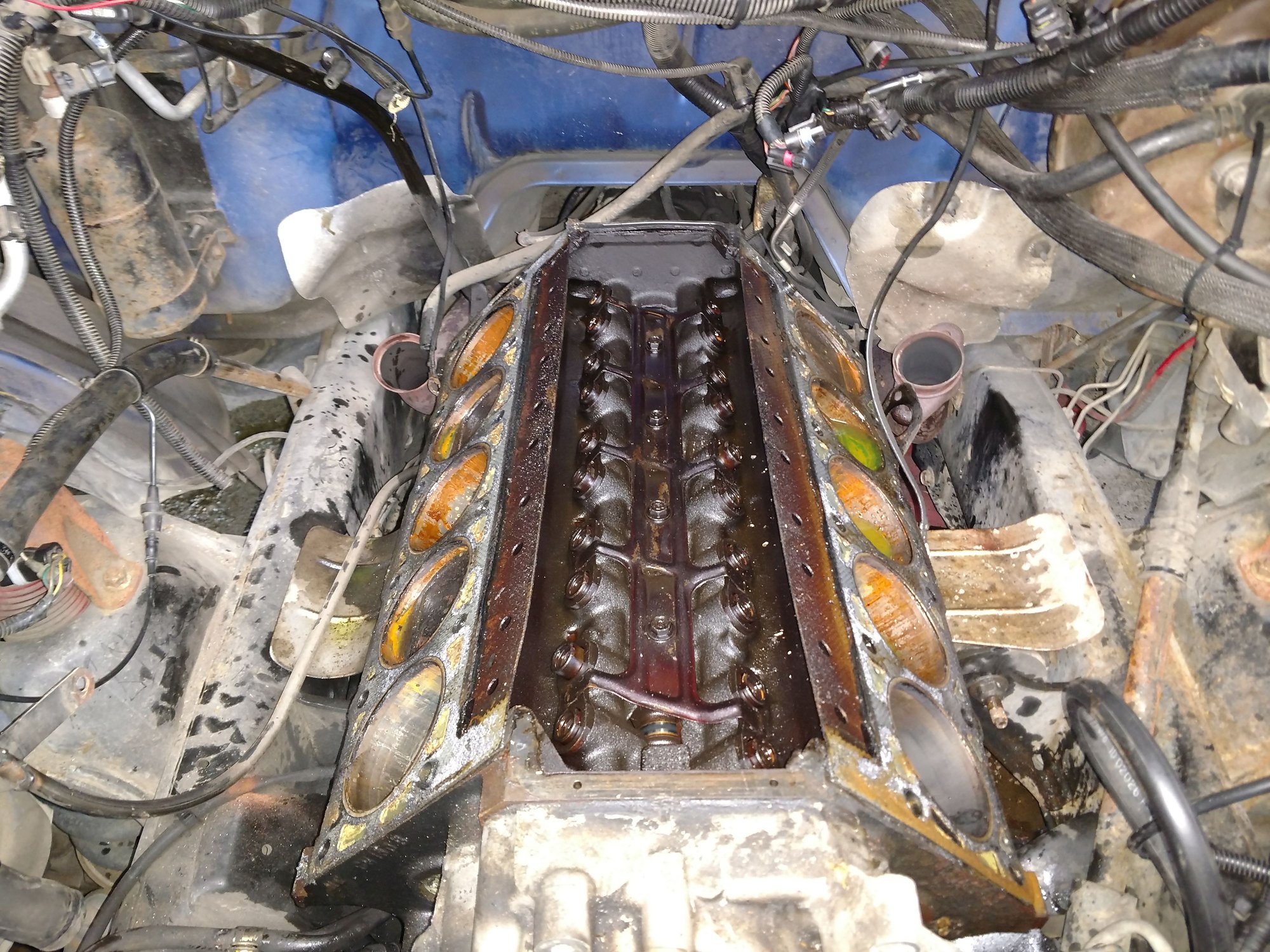

As far as the manifold? HeyYou, you said if the manifold leaked the two front cylinders would be the only ones with water in them? Odd because they were the only two that didn't have water in them?
Look at the front two cylinders. Clean compared to the other 8? Does that just mean it started flooding from the back and didnt run long enough to get to the front two cylinders?
Old Feb 18, 2020 | 04:41 PM
  #265
Posts: 87,475
Looking at that, it isn't the intake that is the issue. There *might* be a coolant passage at the back of the intake, (you would be in a better position to know. ). But, even so, if there was enough coolant getting into the intake to start flooding successive cylinders, you would have ran into hydrolock LONG before that happened. Gotta be head/block issues.

How about this? Those heads you sent me a picture of off eBay are $300 and that includes shipping. Ship to Seattle and put on the boat? Your saying most likely the manifold is fine? Because I saw one on eBay for $100. The heads came off an engine that dropped the lower end? How do I know the heads are ok?
Old Feb 18, 2020 | 04:48 PM
  #267
Stitch Mitchell's Avatar
Stitch Mitchell
Joined: Jul 2019
Posts: 279
From: Ketchikan, alaska
So bolting different heads to this block. Isn't necessarily gonna fix anything if the block is jacked up? How do you check the block? I straightedged the heads and there was nowhere that the feeler guages would slide under. That straight edge was sit n flush on both heads. I did about six different points on the heads. Four straight across them and two crisscrossed.
Old Feb 18, 2020 | 04:49 PM
  #268
Posts: 87,475
With used heads, you don't know..... and I suspect when the seller found out where they need to be shipped to, he would change his tune about shipping, right quick. The trick might be, find someone you trust, with better resources available, have THEM buy the heads, and have them make a trip to the machine ship to be rebuilt. (including check for straightness, etc.....) THEN have the known good heads shipped up to ya. If you go that route, I would be REAL tempted to spend the money on a mechanics straight-edge, and verify that the block surfaces AREN'T warped, otherwise, you spend several hundred more dollars, and are still without a truck.......
Yep, same numbers I found on engine/core charges. It really wouldn't surprise me if it would cost more than the 400 bucks to ship the dead one back from where you are......
Thinking about it, if you have a cooling system pressure tester, you could pull the top half of the manifold off, and pressurize the cooling system, and see if you still get coolant out the spark plug holes, and if you see any in the intake.
