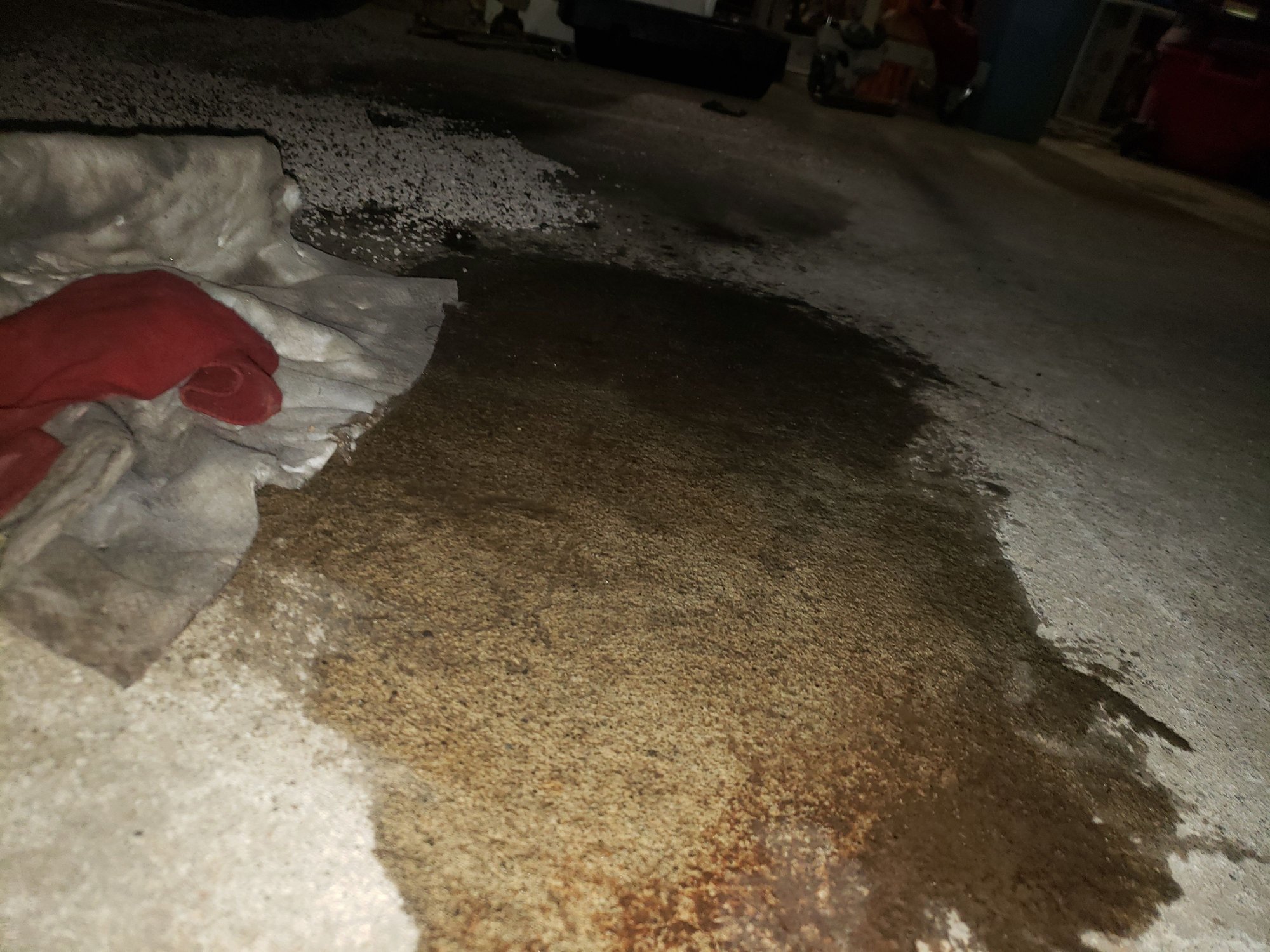

Big puddle of fuel under the truck??? Wtf now?
Well??? the fuel rail has zero pressure. The hard line under driver seat basically is leaking. I pulled it off and cranked it over a few times to see if it was plugged and fuel spewed all over. I cranked on it a few times to try and clean out the line. I just wonder if what ever was plug n it is now plugged the injectors? I had to use my original fuel rail because the hacks that removed the donor engine destroyed the rail on it! In to much of a hurry to simple remove 6 bolts and take the rail and the injectors off!! Hmm? There is a black plastic ring with a yellow O ring on it between the hard line clip and the braided fuel line going up to the fuel rail. wonder if change n that O ring would keep this from leaking?? HELP!!!!! (As i sit here stink n of gasoline and shaking my head!!)
