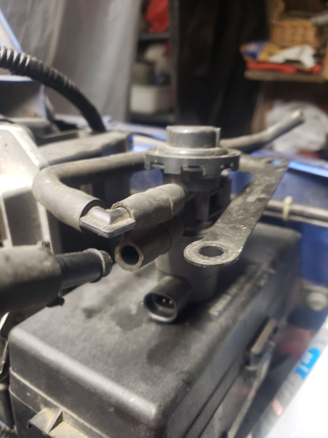

Found it!! that lines goes to the can tjat hooks to the throttle body!!! Man HeyYou!!! cant thank you enough! Taken lots of the guess work out of this project!!
Every one has a home to go to tonight! Thank you Jesus!!
Old Feb 28, 2021 | 08:54 PM
  #392
Posts: 87,483
Yep. Purge valve. Awesome.

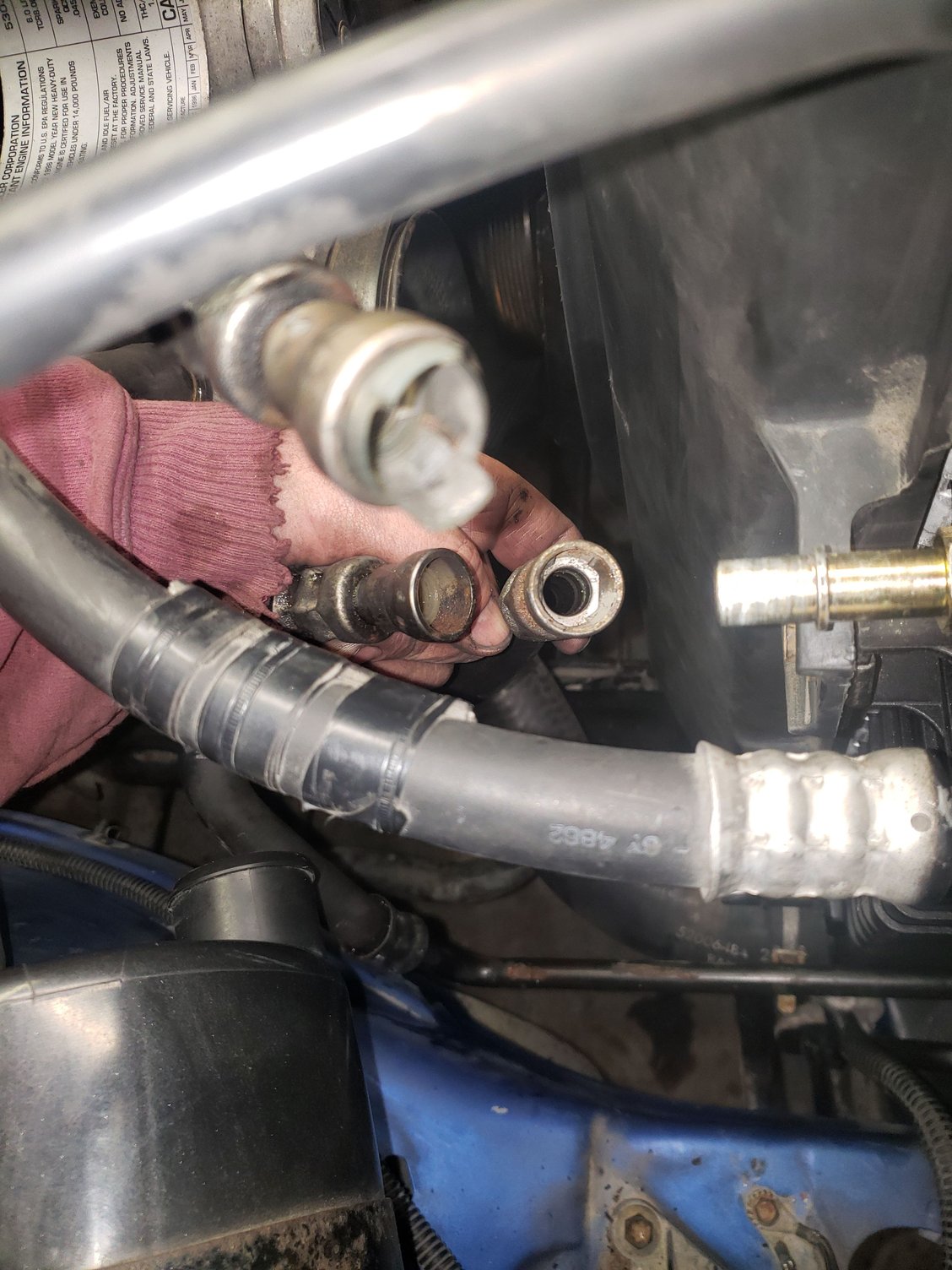

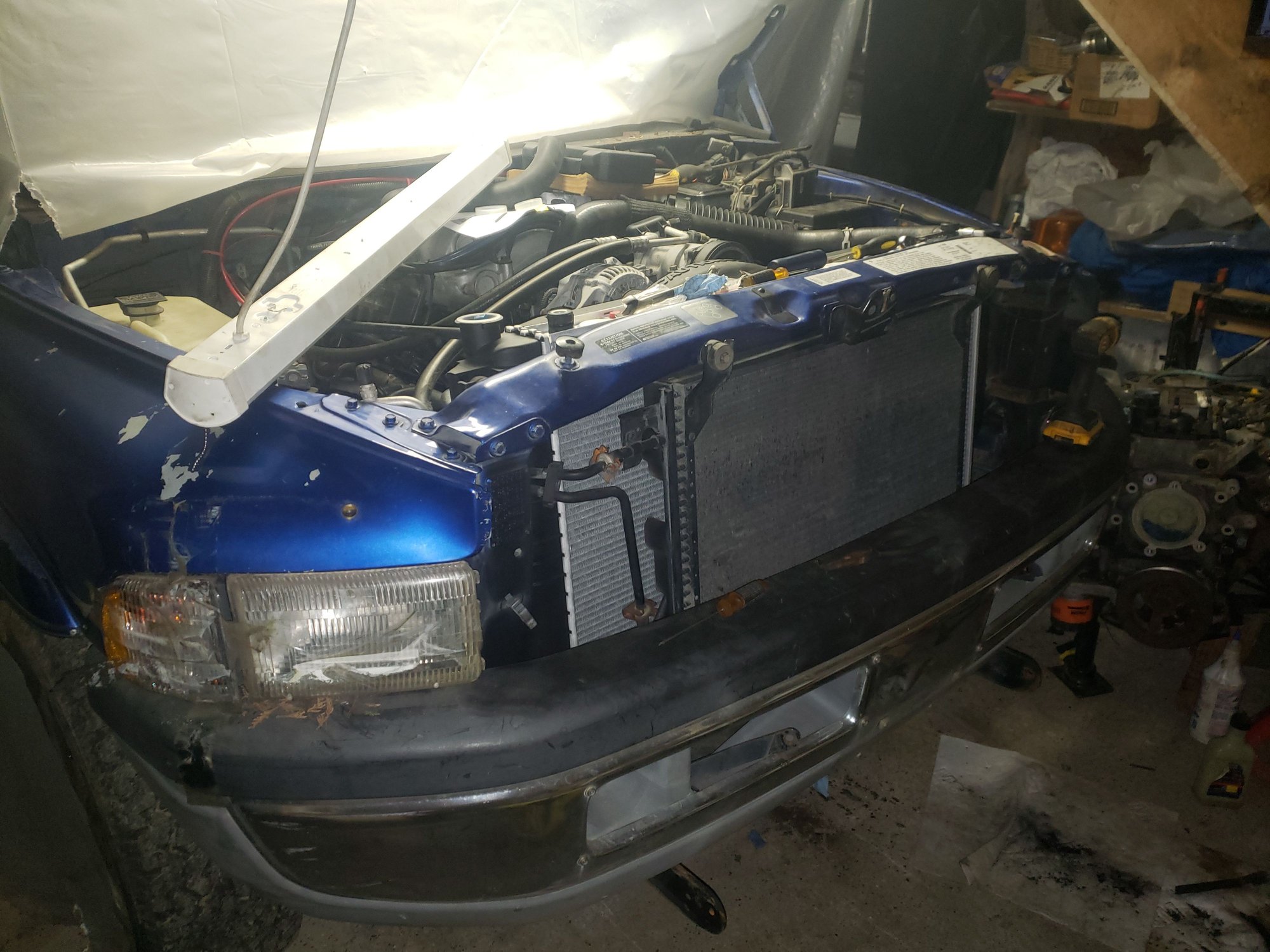

Pulled an all nighter! im stumped? i installed a new radiator. this rig has an automatic trans with a trans cooler. so theres 2 lines coming from the trans and theres 2 nipples on the radiator. theres also 2 lines coming from the trans cooler! so theres 4 lines and only 2 hookups? Im totally brain fart n right now? guess that what happens when you pull an all nighter? But? where the heck do the trans cooler lines hook up? didnt pay enough attention when i was rip n this thing apart? usually theres an obvious spot to hook things up? mercy sakes!!
Everything but the trans lines are in.
Old Mar 1, 2021 | 08:17 AM
  #394
Posts: 87,483
Line from trans (from the front of the trans) goes to lower fitting on radiator. Upper radiator fitting goes to external cooler, line from external cooler goes back to the trans.

Theres 3 trans lines. The 4th one is point n down next to the lower radiator hose. First time i ever messed with a trans cooler! Its quite apparent!!??
Old Mar 1, 2021 | 08:42 AM
  #396
Stitch Mitchell's Avatar
Stitch Mitchell
Joined: Jul 2019
Posts: 279
From: Ketchikan, alaska
Ok, had to stop and think about the flow. Kinda like when I do electrical. So the bottom one brings fluid from the trans to the radiator nipple. fluid flows up to top nipple on radiator where line from cooler hooks up. fluid flows thru cooler. Then returns back to other trans line back to trans!?!? Makes sense! even sleep deprived! however, bottom line from trans to radiator nipple isnt going on? all the rest snapped right on! thanks HeyYou!!! AGAIN!! 4:41 AM here in Ketchikan, Alaska! supposed to snow for 4 days!?

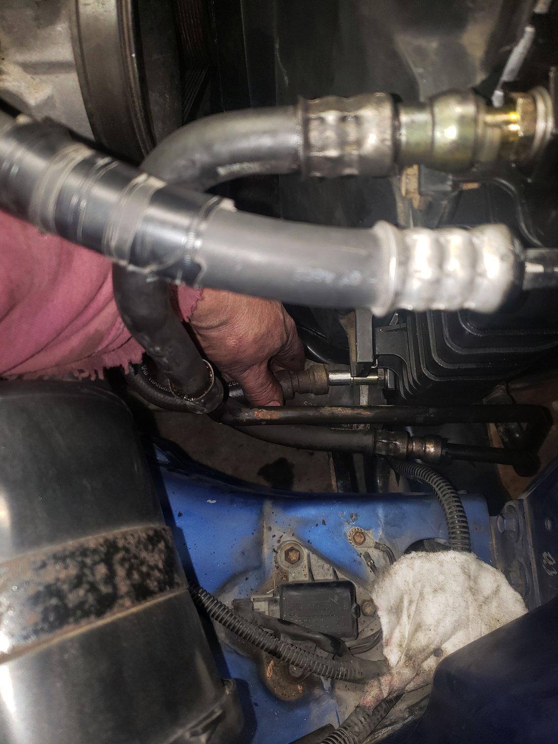

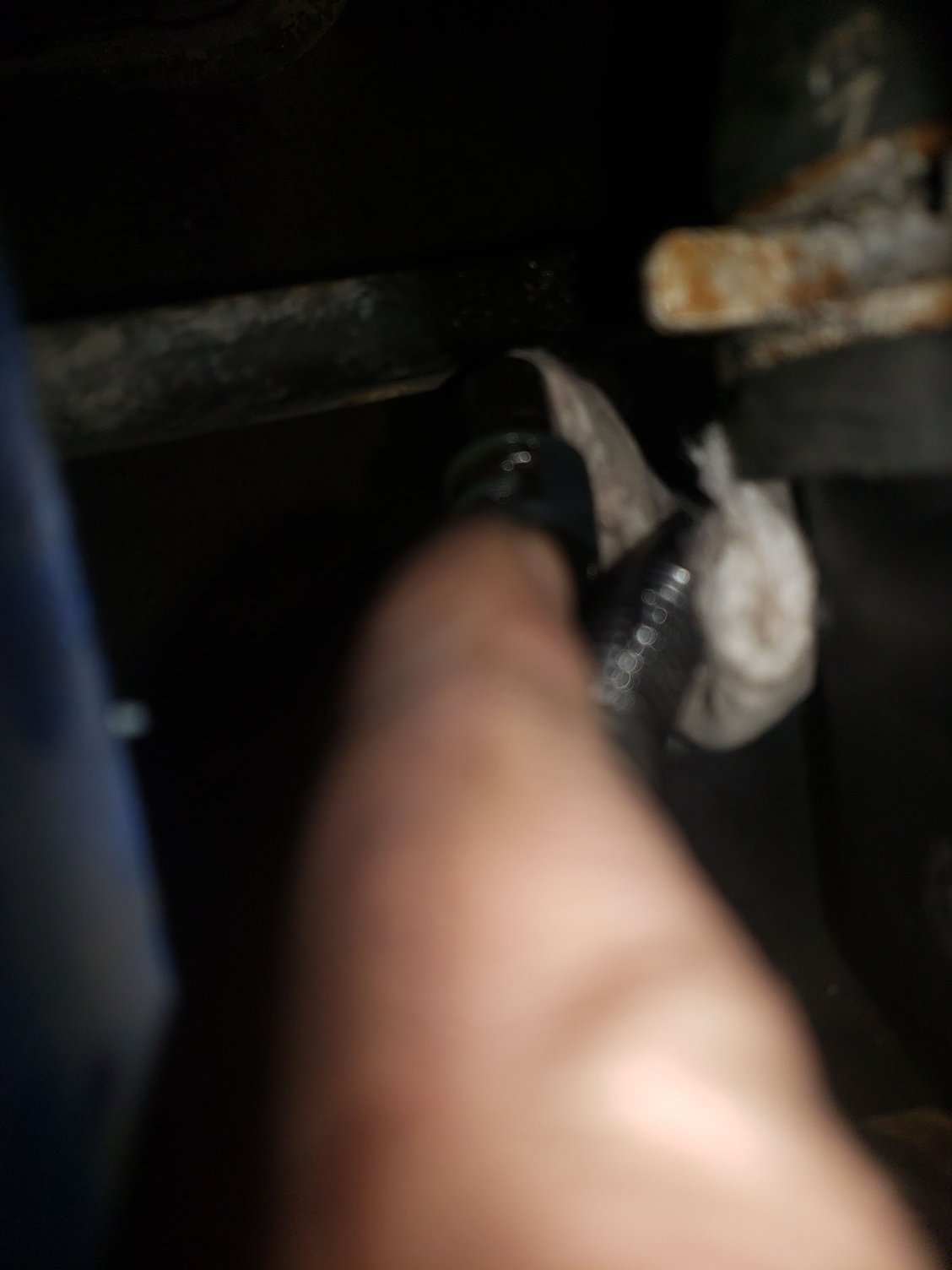

All lines on except bottom one. Main feed line put n up a fuss!
Old Mar 1, 2021 | 06:11 PM
  #398
Posts: 87,483
Yeah, that one can be a pain. Not like you got a lot of room to wiggle around down there. But, it *should* just push right on, and lock into place. Is the lock ring out of place inside the fitting?
I checked the line and even filed the new fitting down a bit. There isnt much pressure on the trans lines is there?
