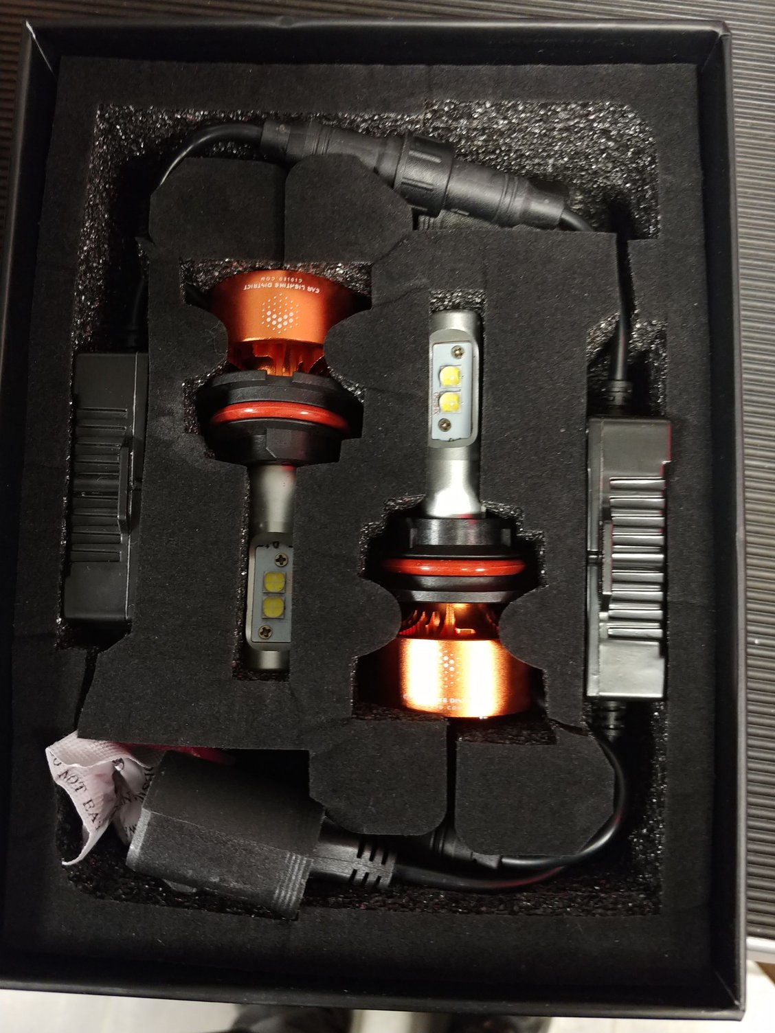

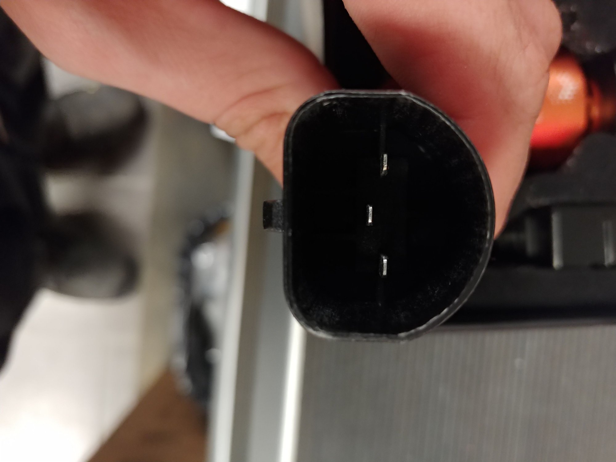

Here are some photos of the ones i put in.

I wouldn't have too much faith in what the website lists. As a test I looked up the bulbs for a 2000 Ram Sport model which uses 9007 and low and behold they list the same bulb as they do for non-Sport models (9004). That and the fact that there are two different and incompatible bulb types listed on the packaging is a dead giveaway they just go by whatever the Chinese manufacturer sends them.
I'd test the bulbs to make sure they have the correct pinout, see here for details about 9004 vs 9007 bulbs: https://sparksmith.com/blogs/news/do...and-9007-bulbs

Finally got time to look into this last night. Turns out the guy that installed the light didn't put them in properly and were pulled out of the housing slightly causing a bad reflection. They work just fine after I locked them in place. Pinning in the bulbs isn't a problem. Spent about 45 minutes trying to figure out if it was. Shoulda started with playing with the housing. Now to decide if I want to bother getting the DRLs to work. Thanks for the help!
