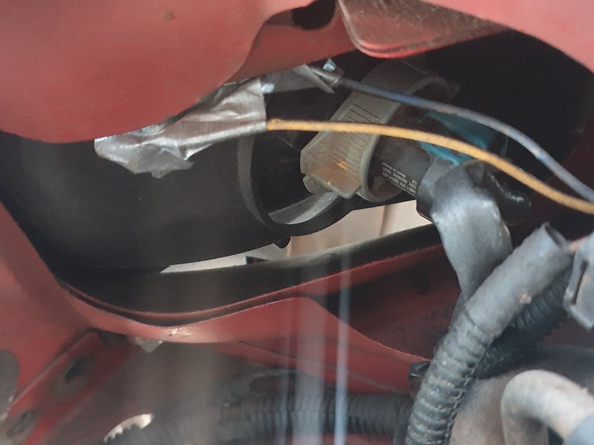

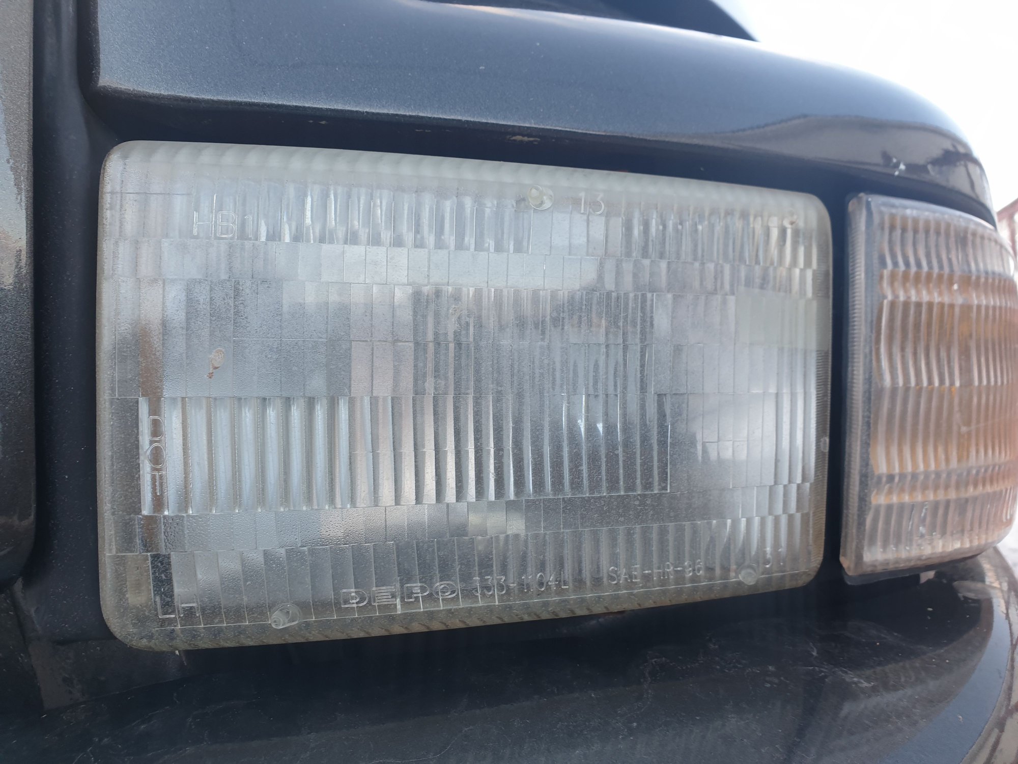

Ok so I have a few pictures of the headlight, the truck has the big cut outs for the 2 bulb headlights and in the pictures you can see the cut off wires that were suposto go to the other plug, I believe it is a actual sport but since it is a states truck and I'm in canada I can't get a build sheet for it!!

I don't see a sport grille but the bumper is plastic so must've been wrecked and they just went to the junkyard quick.
