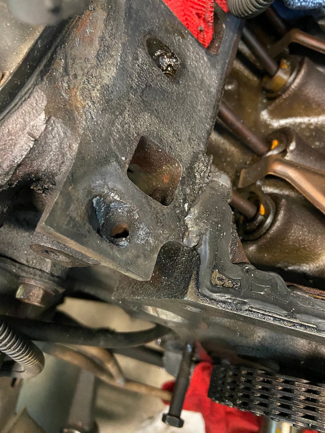

Is this stuff around my intake bolts why the broke off

Better picture of retapped manifold bolt hole
Post extraction on passenger side

Wouldn't hurt to run a tap down ALL the bolt holes for the intake..... makes sure you get proper torque readings at reinstallation.
I little oil on the o-rings makes reassembly a lot easier.
