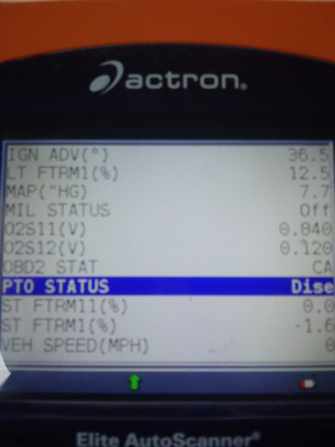

Old Feb 26, 2020 | 01:53 PM
  #24
chris bioski's Avatar
chris bioski
Joined: Feb 2020
Posts: 26
From: Connecticut
This is what I got at idle

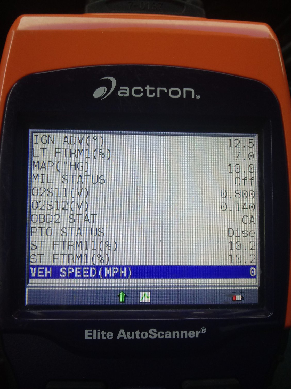

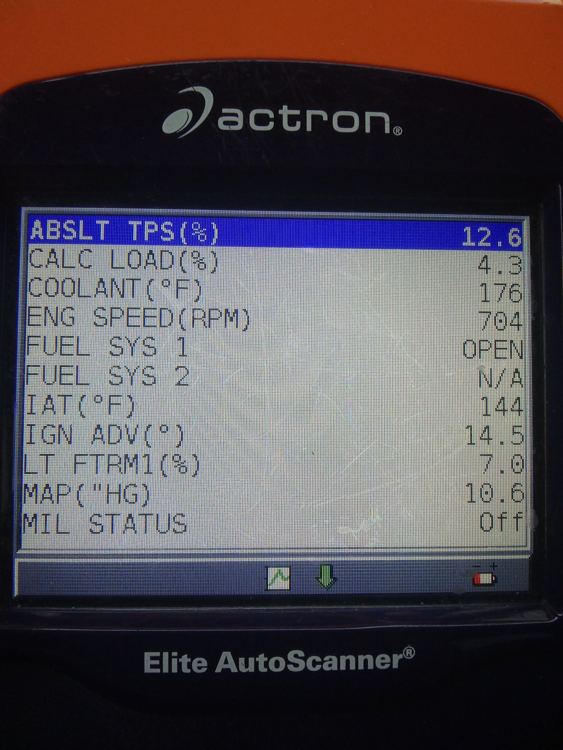

Old Feb 26, 2020 | 01:58 PM
  #25
chris bioski
Joined: Feb 2020
Posts: 26
From: Connecticut
At idle

From: Connecticut
At about 2000 rpms idk why it says disel

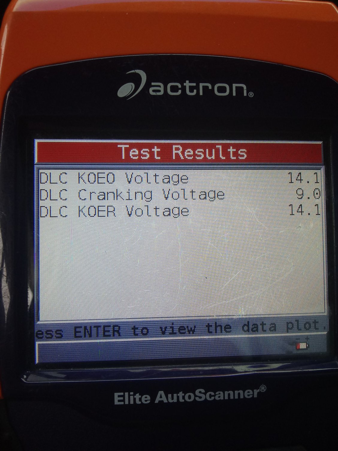

From: Connecticut
Charging system test
Old Feb 26, 2020 | 03:39 PM
  #28
Posts: 87,468
Likes: 4,221
Still in open loop at 176*?? That doesn't seem quite right....
Old Feb 26, 2020 | 03:42 PM
  #29
chris bioski
Joined: Feb 2020
Posts: 26
From: Connecticut
I've been driving it all morning pulled into the parts store grabbed the scanner hooked it up and that's what it says what does that mean?
Old Feb 26, 2020 | 03:43 PM
  #30
Posts: 87,468
Likes: 4,221
What temp thermostat do you have in there??
How long had it been sitting idling? What was ambient temp at the time?
