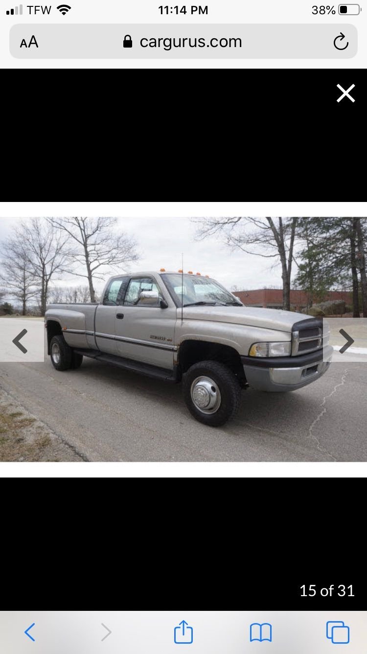

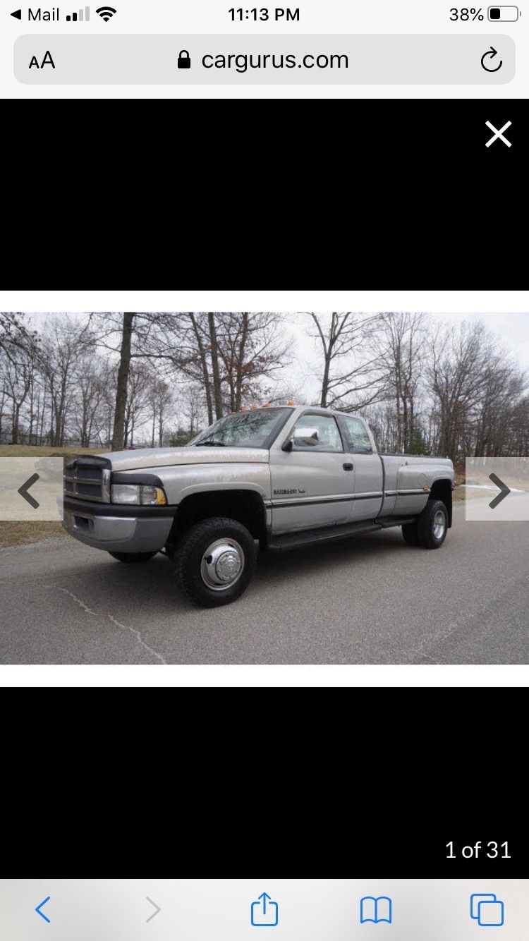

Hey just picked up a 95 dodge v10 4x4 3500 club cab. Truck has 110k and two owner. Guy I bought it off took it in on trade. Truck is in beautiful shape for age. Unfortunately the truck has a little tick that I wasn’t worried much about. I made the mistake of reading into it and now I feel like there could be a million things it could be. I did an oil change with 10w-40 after reading that may help. It didn’t. I am planning on doing plugs and wires this weekend after I read that it could be spark knock? I’m really hoping it doesn’t need a motor or a rebuild but not worried about it if it does. I picked the truck up for $3500

Also truck is verified two owner. Original owner bought new in 95 and only towed to Florida in winter season. Truck has always been serviced and taken well care of. He just traded it in last month.
