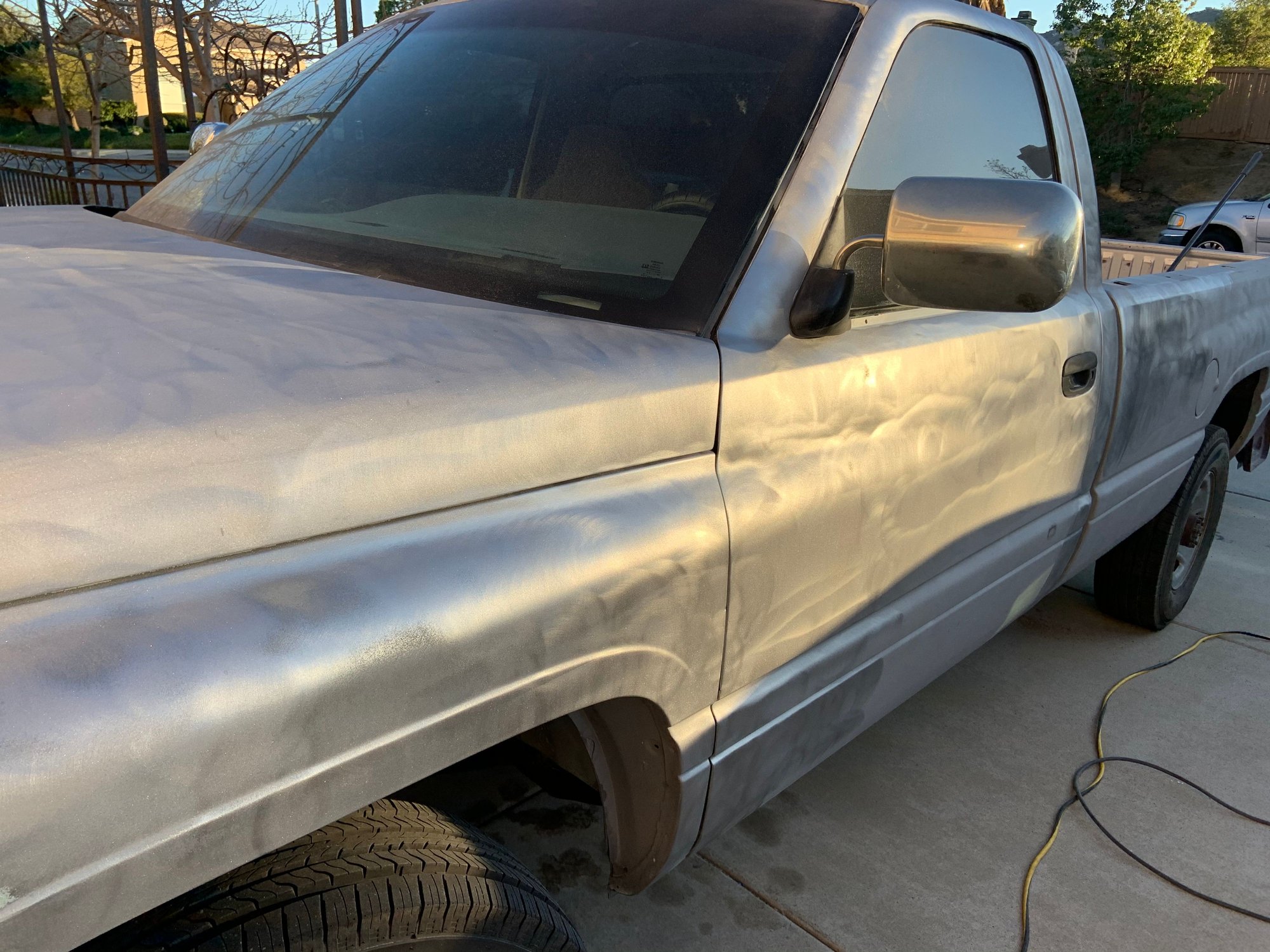

So I am starting this thread a little late, but better late than never. This was a family truck my Uncle left me when he passed. He was a second dad and I want to honor him by breathing new life into the rig. Three months have passed, a lot has been done....

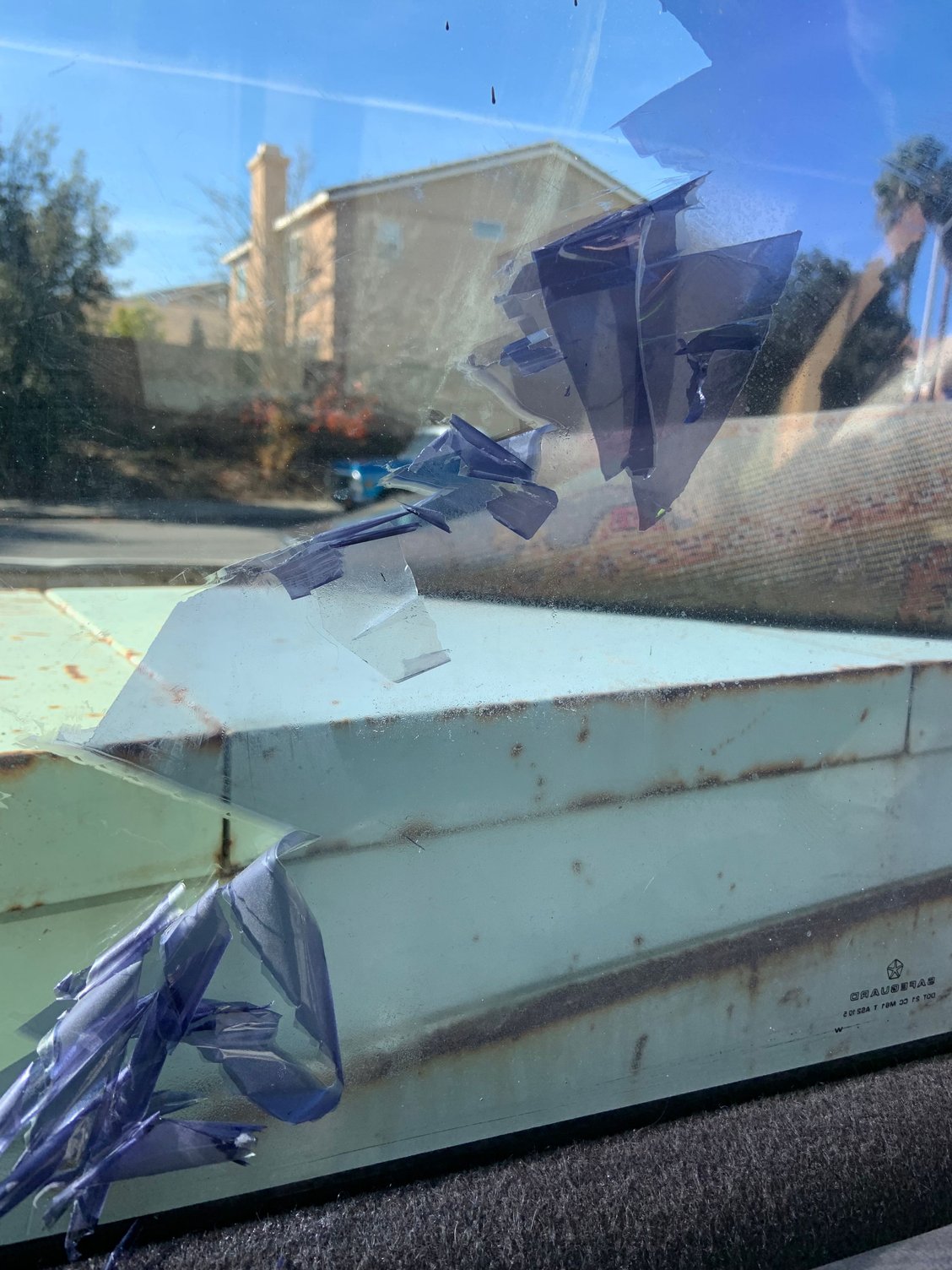

Old tint being stripped off.
New ceramic coat limo tint, 30%
Pick a part scores, goal is keeping the build under 6k total. Scoring used parts wherever I can.

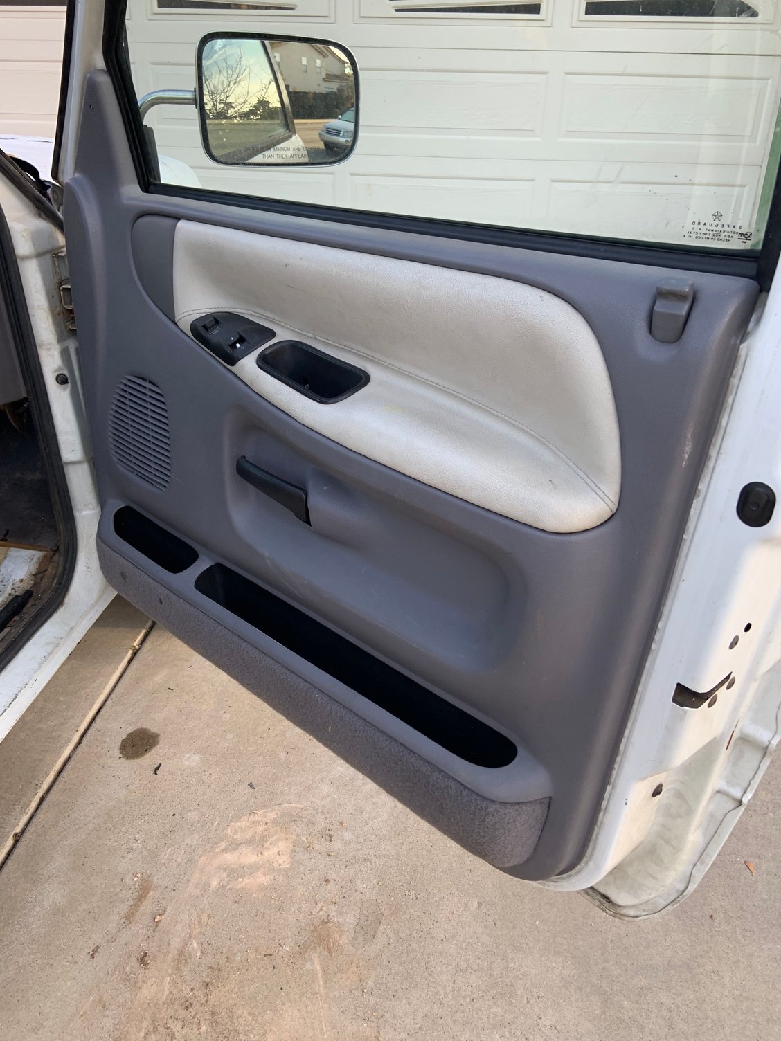

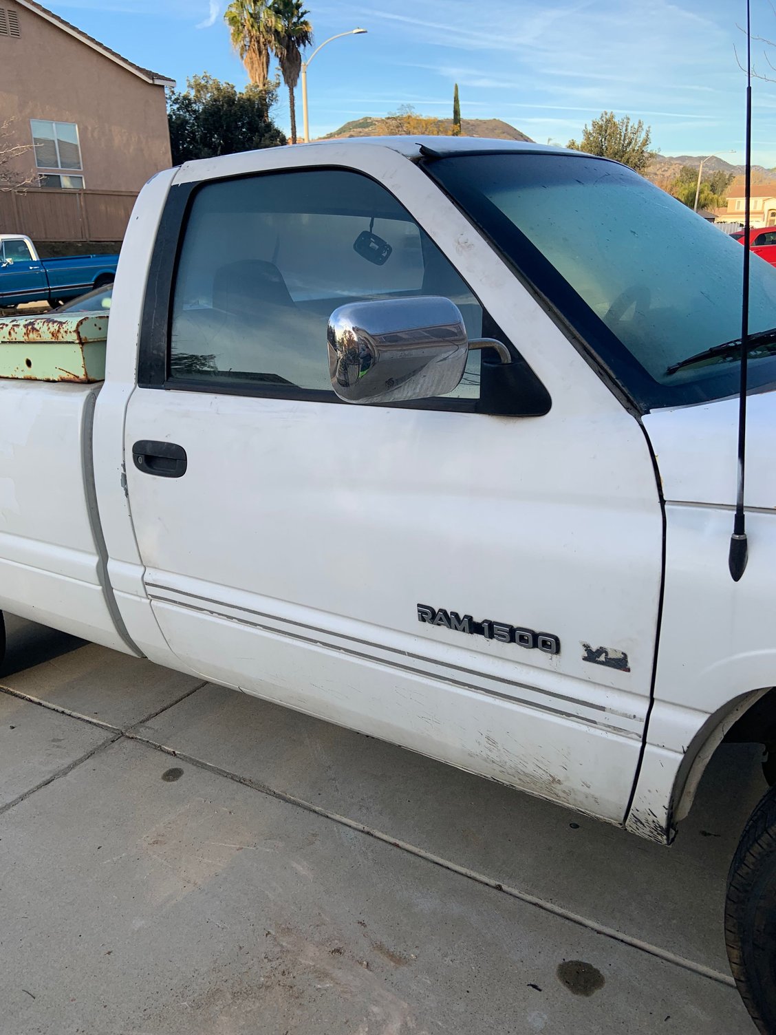

Swapping manual doors for pick a part doors with auto windows and mirrors.
New doors from a donor 1500.

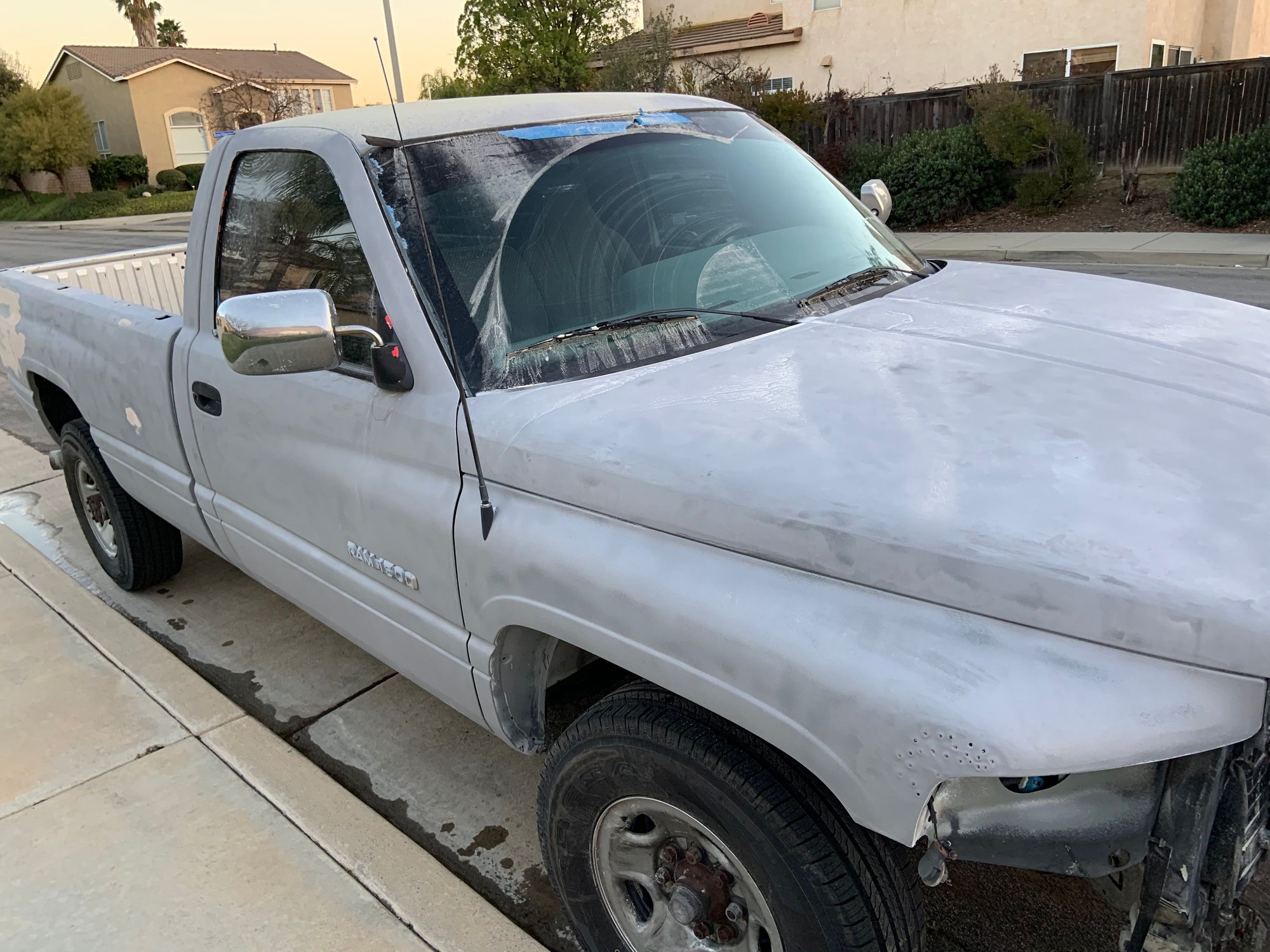

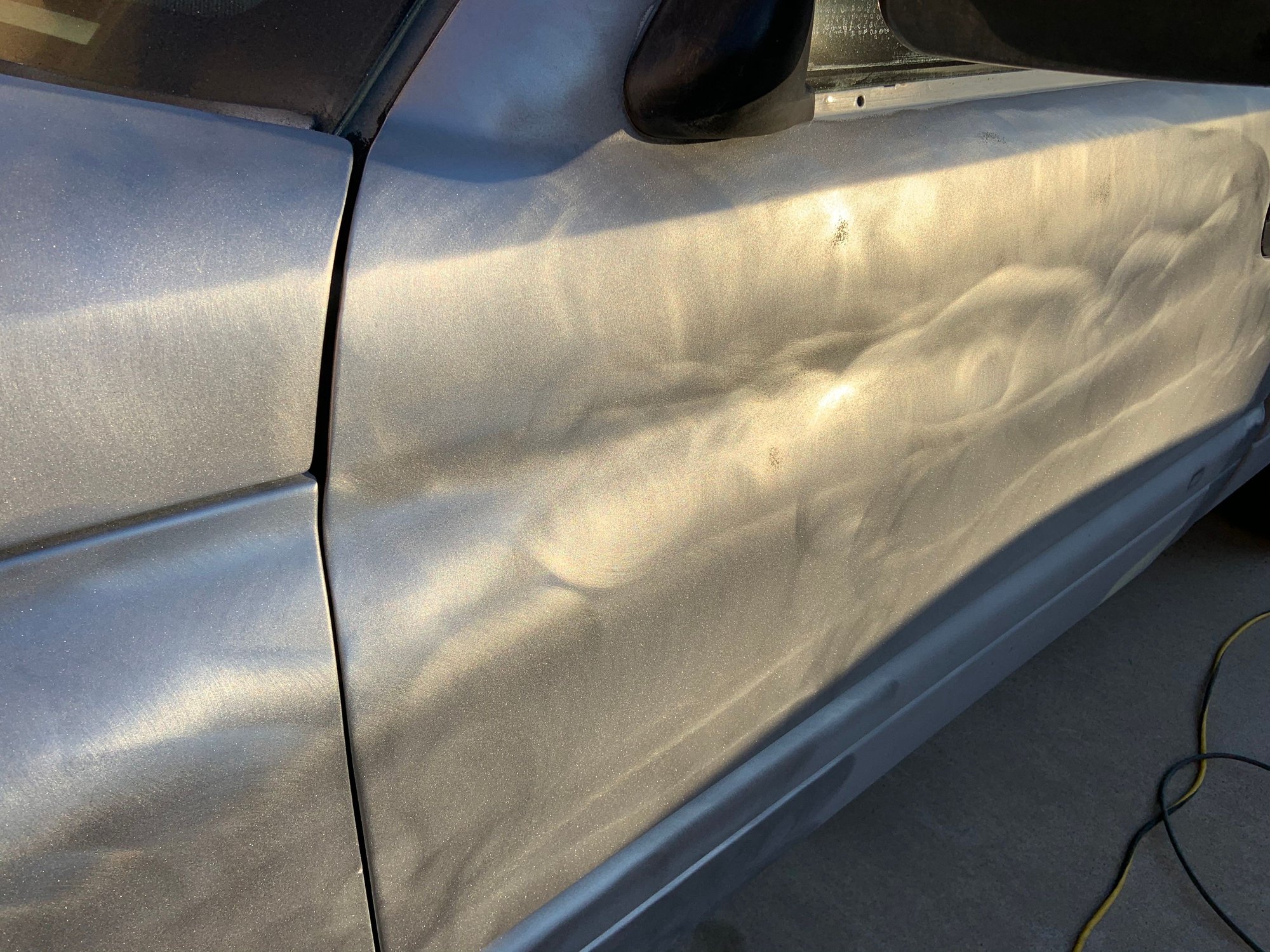

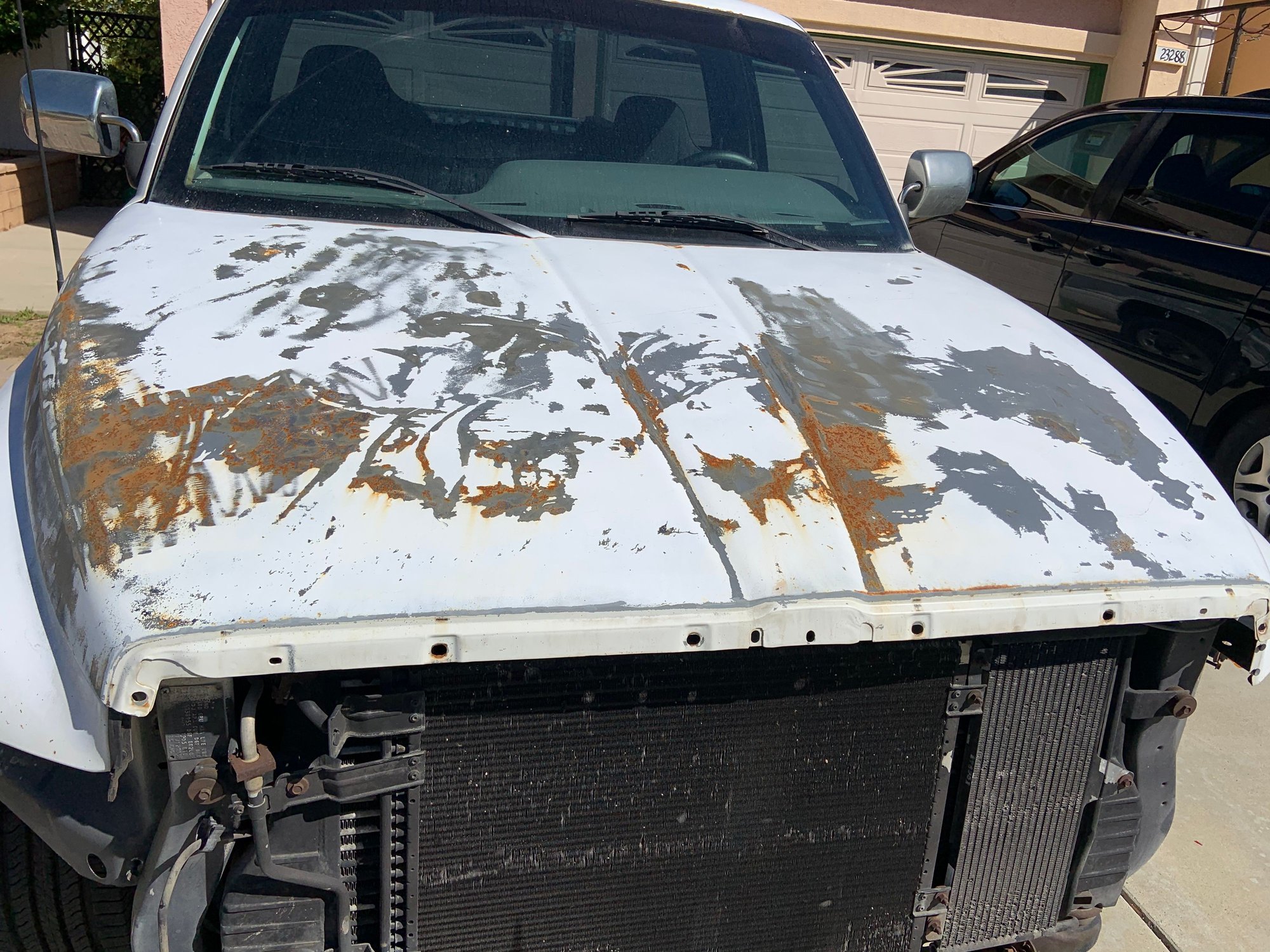

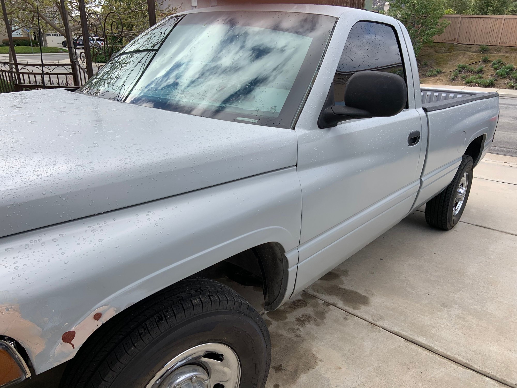

Post dustless blasting, highly recommend it as an abrasive blasting method.

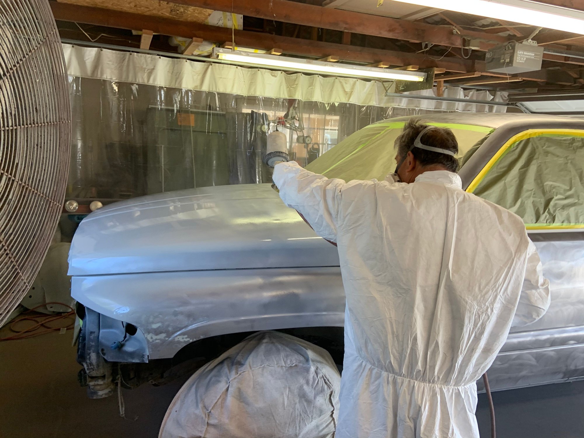

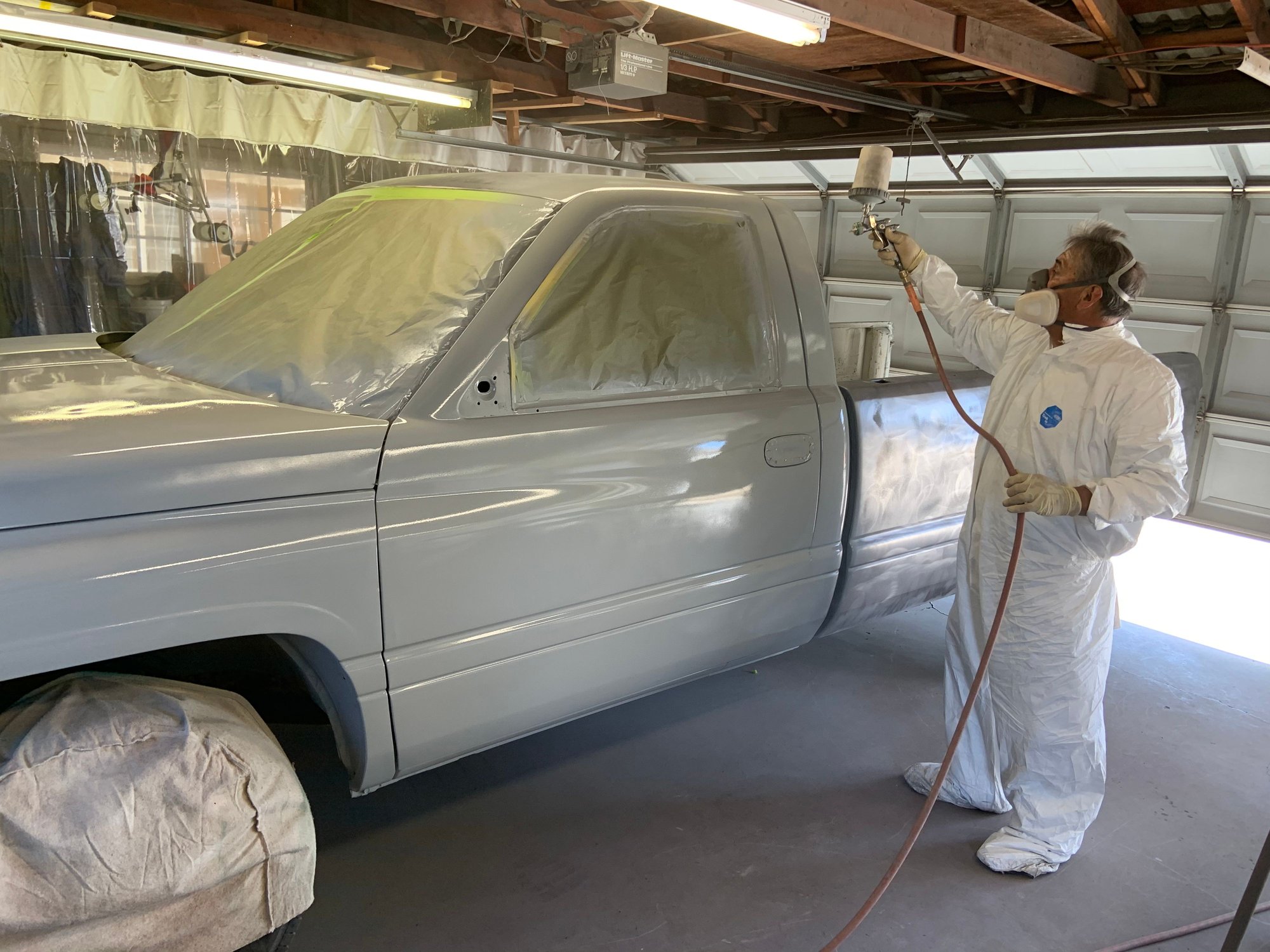

Prepping for primer, used an grinder with a plastic bristle attachment to get clean the metal and knock down the metal in prep for epoxy primer.

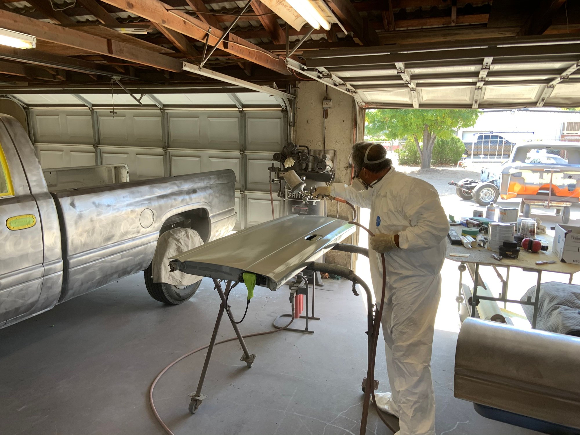

Great local painter, and teacher. He’s been a great teacher in regards to spraying and life. He has a 1997 2500, so it’s been fun cleaning her up.

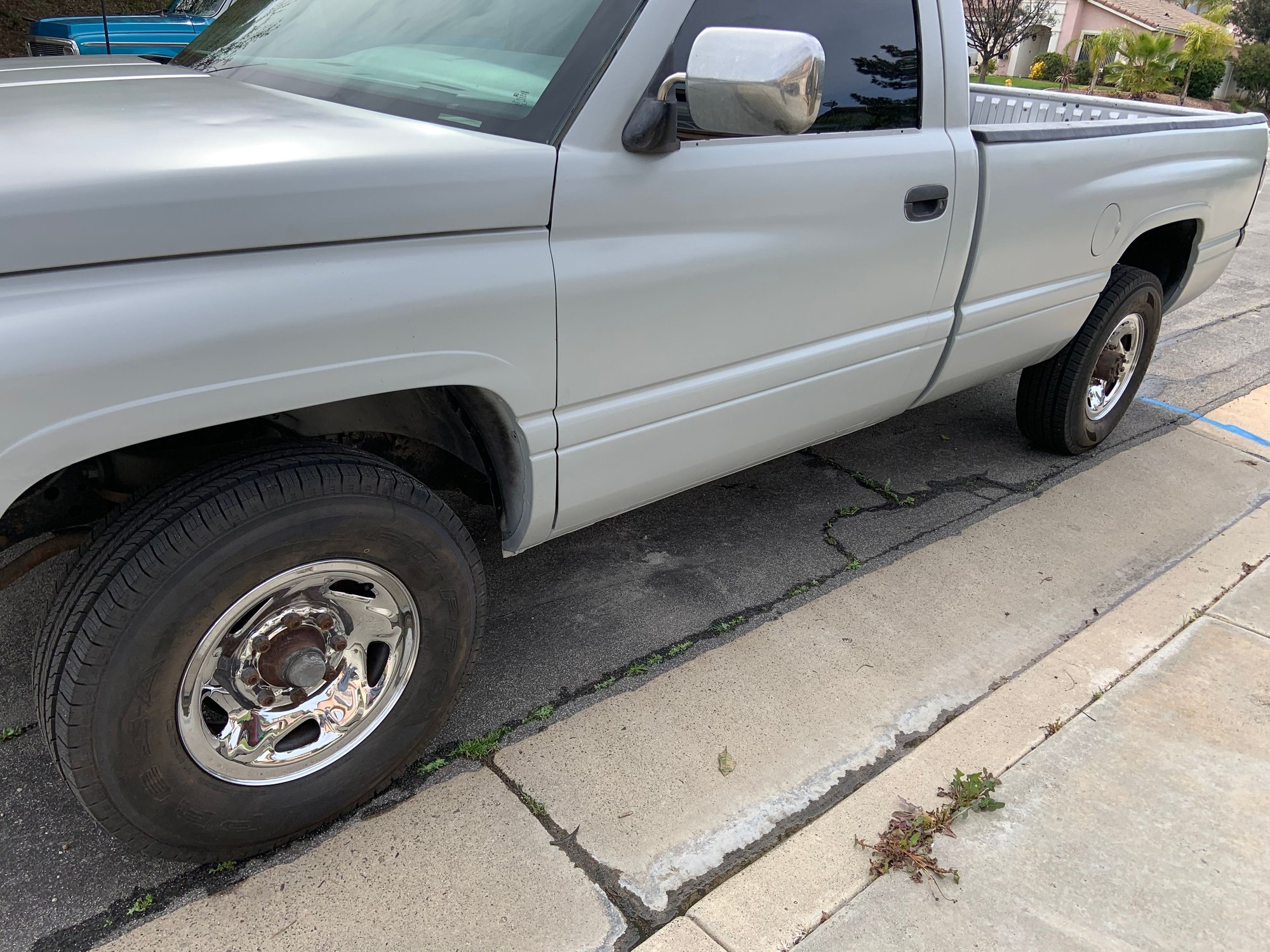

Epoxy primer and with the Craigslist rims and new tires installed.

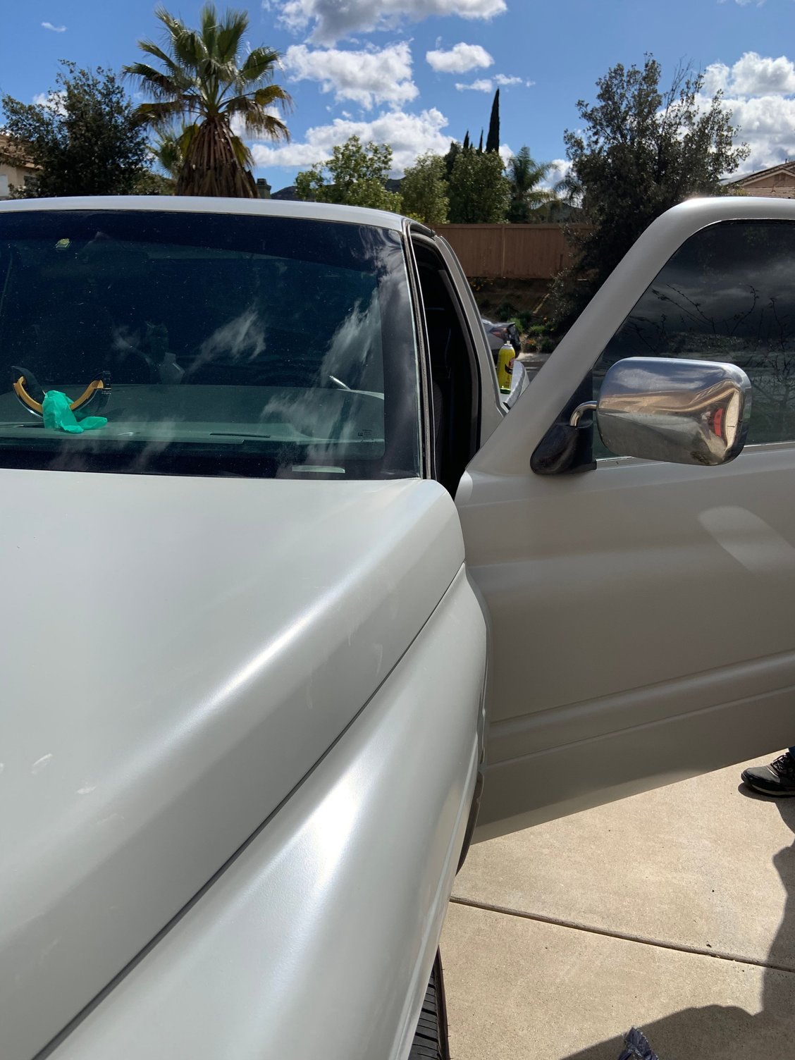

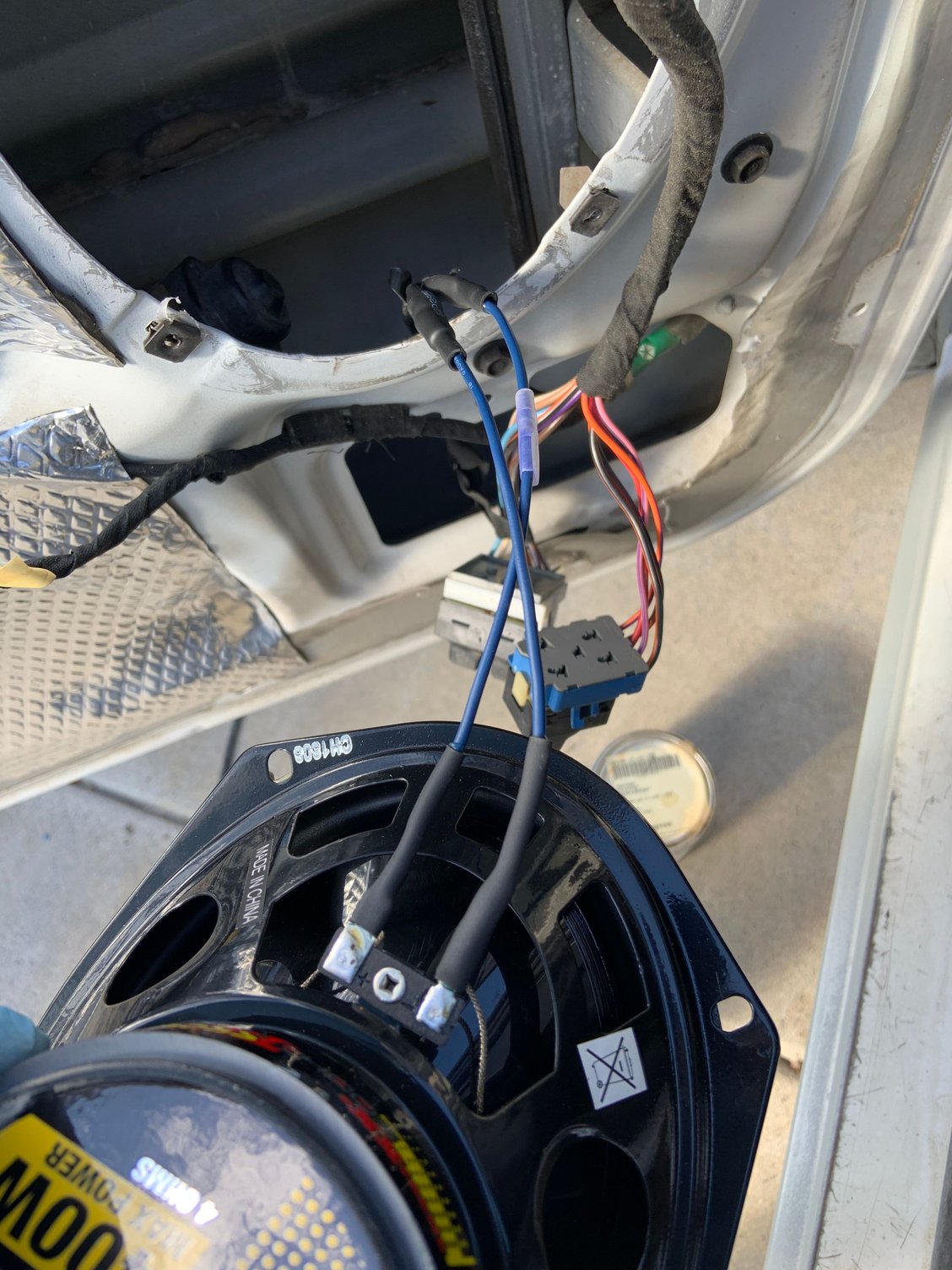

Swapping out the mirrors for the black plastic, later model Gen 2 mirrors.

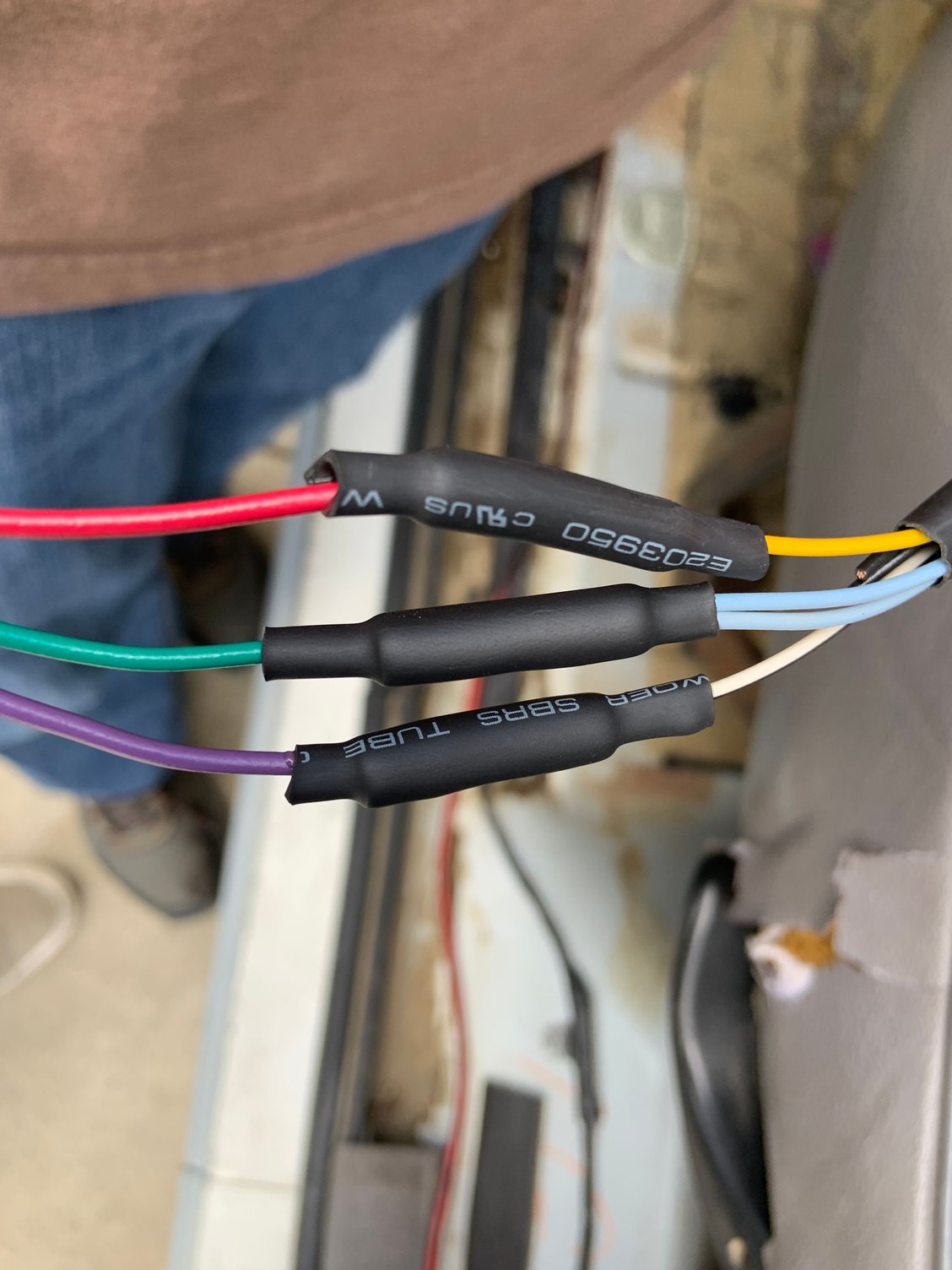

Wiring complete thanks to a smart OP on the Dodge Forum.

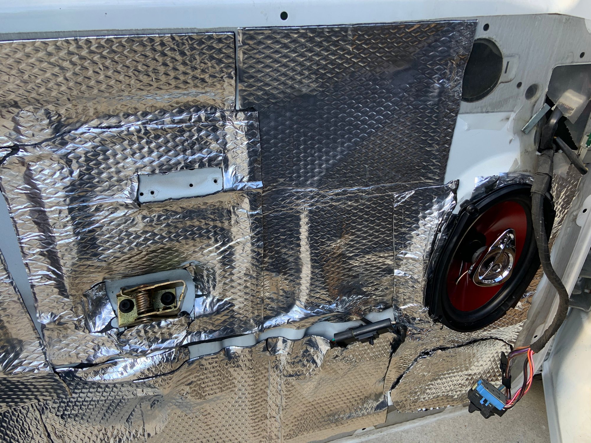

Taking advantage and swapping out the speakers and adding sound deadener.

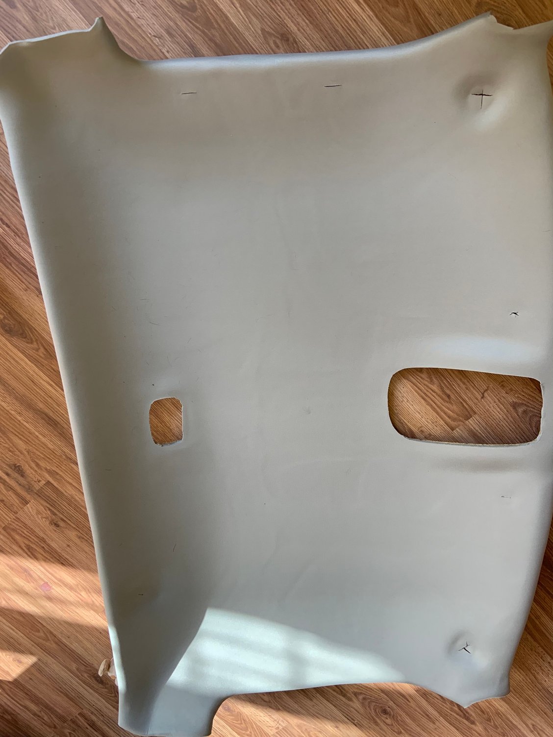

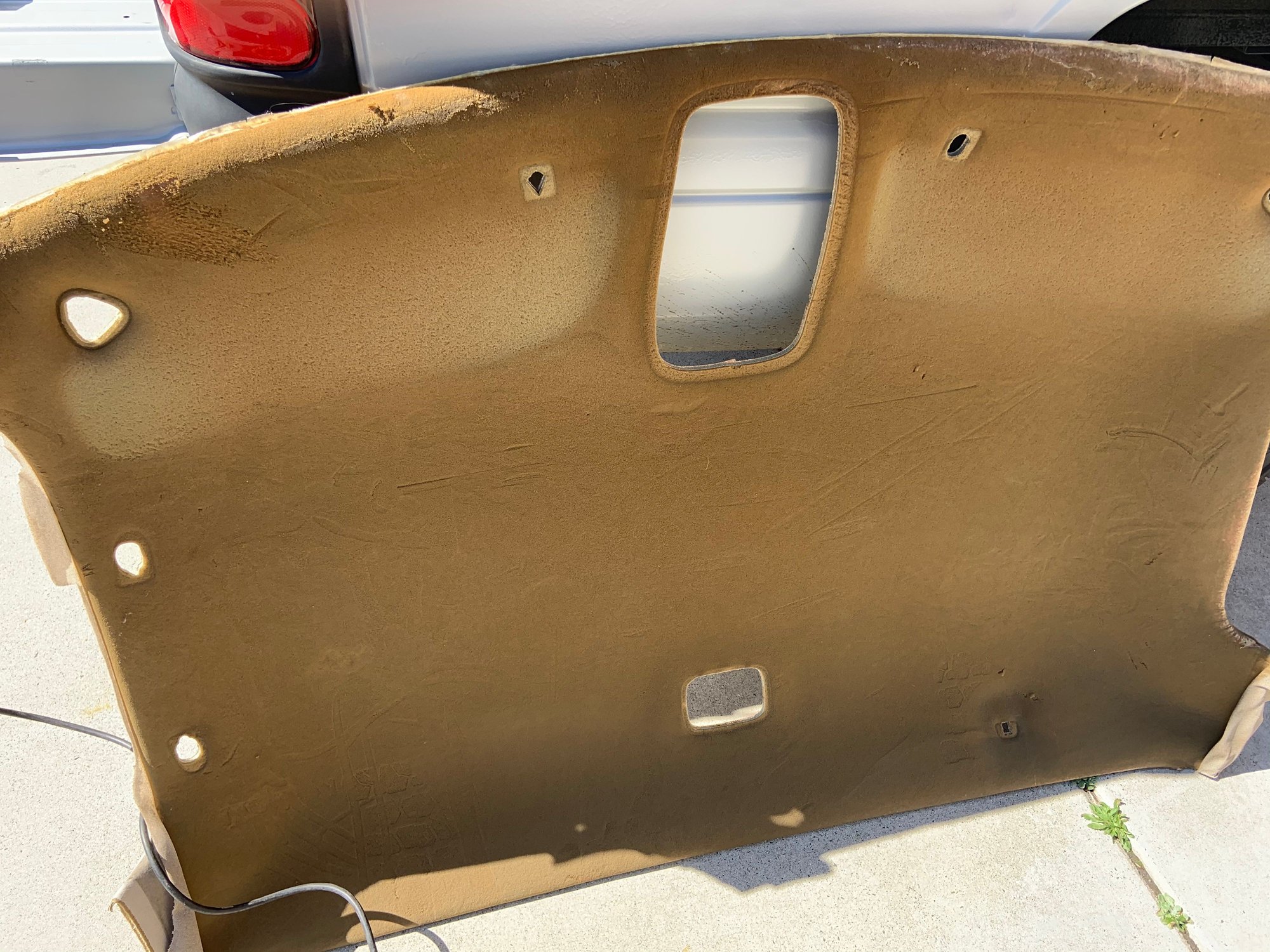

Going to strip the headliner today and save a few bucks at the upholstery shop. Using a wire brush on an angle grinder, with a razor blade and shotgun bore brush to clean up the edges.
Finished product
Finished product

Only problem I see is soldering the connections you won't be able to pull the mirror if needed. I would have used the connector.
Awesome truck!! Keeping it stock or lifting it?

Should have put a better picture in there, but used the original harness connection, just had splice in the new mirror wiring into the old.
Will look at lifting it, but probably going to tune up the motor first. Had the tranny rebuilt already (overdrive was fried when I got it)
Thanks for the feedback brother

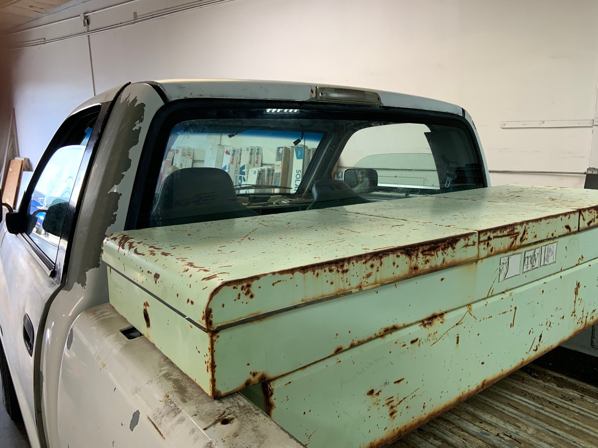

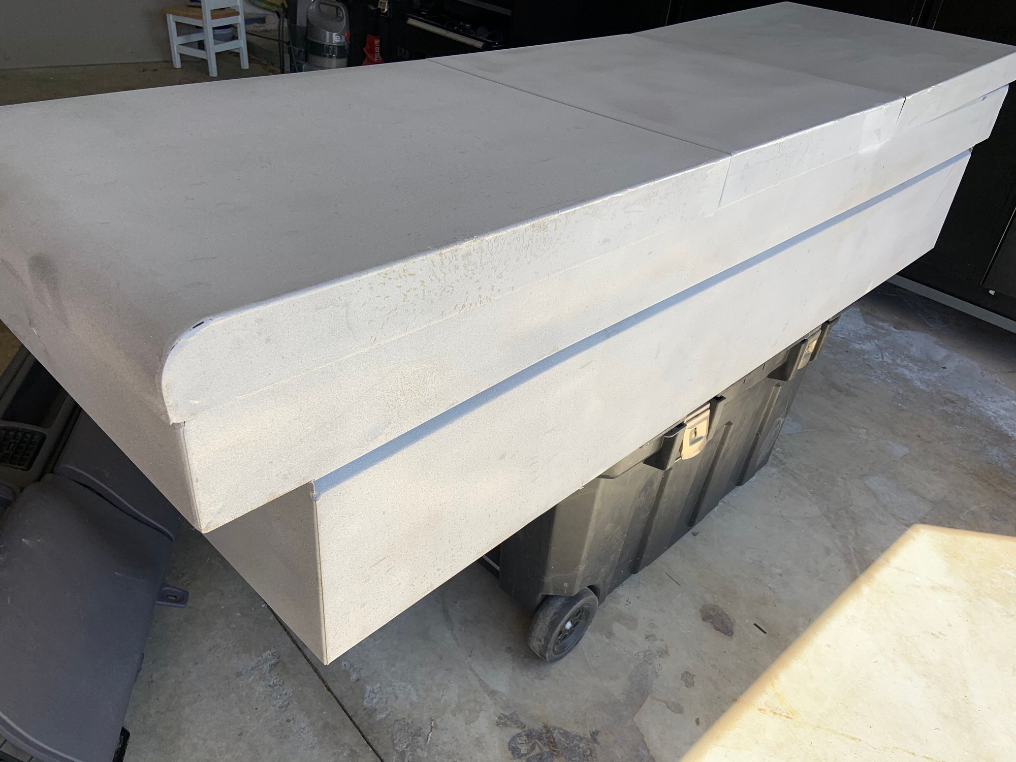

Picked up an old tool box off Craigslist for 40.00...A lot of surface rust, but structurally in good shape.
Got this back yesterday, if you need a good dustless guy in Riverside, Kevin and Mike are both good guys. Mike knocked this out in 30 minutes both inside and out. A coat of epoxy primer and it will be color matched with the trucks final coat. My goal is too bring life out of old used parts.

That's good using the connector lol. So far I think you are spot on with what needs done. I arm liking this so far. Im restoring a 2500 to!
You are doing good focusing on the drivetrain first
