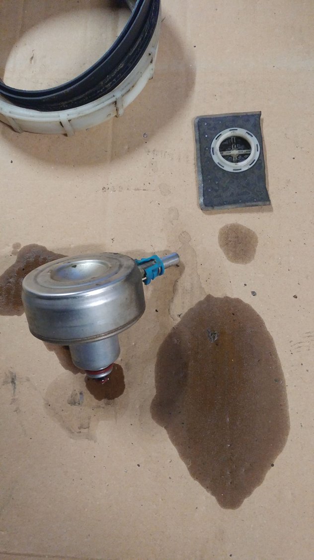

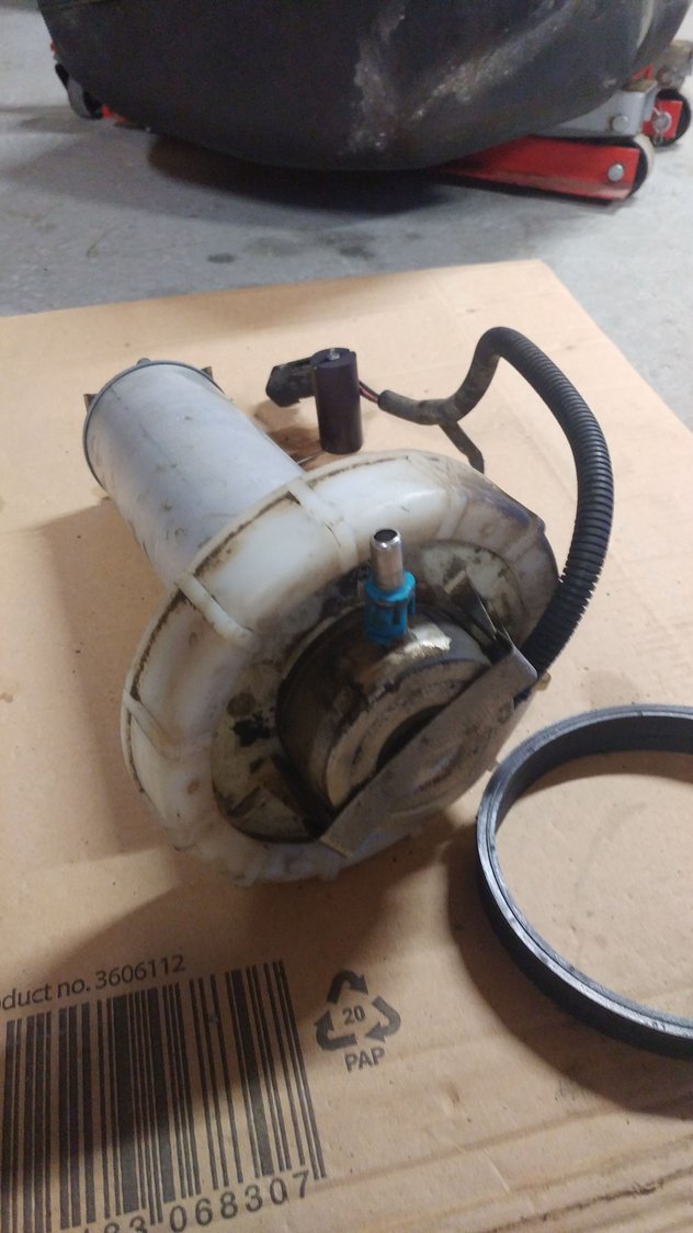

I hope so! Hopefully on tuesday or wednesday night I'll have time to put the tank back and try. I drove it 8 hours and gave me zero issues, so it's strange that the pump just dies in a moment. The pump itself still works, I tested it (I don't know if it works "enough"). The filter looked quite bad, and the regulator on top of the assembly I've no idea, as it's sealed.
