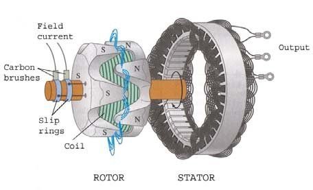

If the brushes are worn down it still may work when removed and tested. Need to take it apart to look how bad the brushes are. Brushes need to make contact with the slip rings.
thanks I'll check it out and so what you're saying is when the engine has higher rpms the brushes loose contact?

Quick way to check for worn brushes; engine running and no charge situation, hit the alternator with the rubber mallet or piece of 2x4 or something. Worn brushes make contact and alternator starts to charge.
