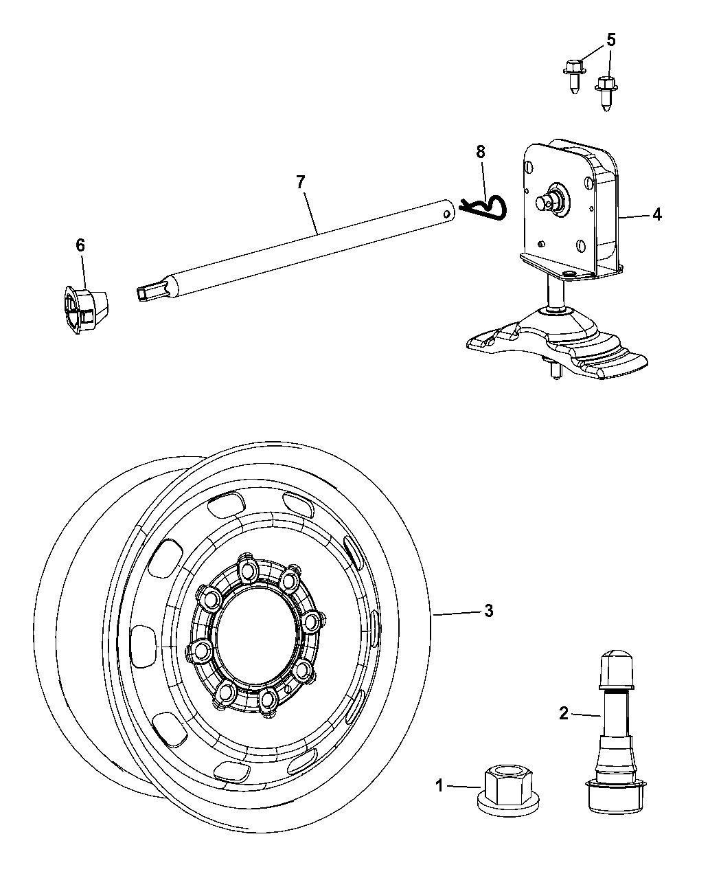

There is a tube that connects to the winch with a cotter pin that goes to the hole on the bed

Took me a while to find the correct picture (though this is for a later model truck, but the principle is the same), but this shows the parts and how the tube is connected. With the cotter pin like MoparFanatic21 said. And that tube is easy enough to make myself that I won't bother to look it from ebay, gets rather expensive after shipping and taxes and stuff.
Indeed! Number 7 in the diagram is what I'm looking for. How can I make one? A piece of lead pipe with a small socket welded on the tailgate end, so I can just plug a ratchet into it, and a smell hole drilled on the other end for a cutter pin? Alternatively, where can i buy a new one?
Yes, sir! That's the tube that I'm looking for.
