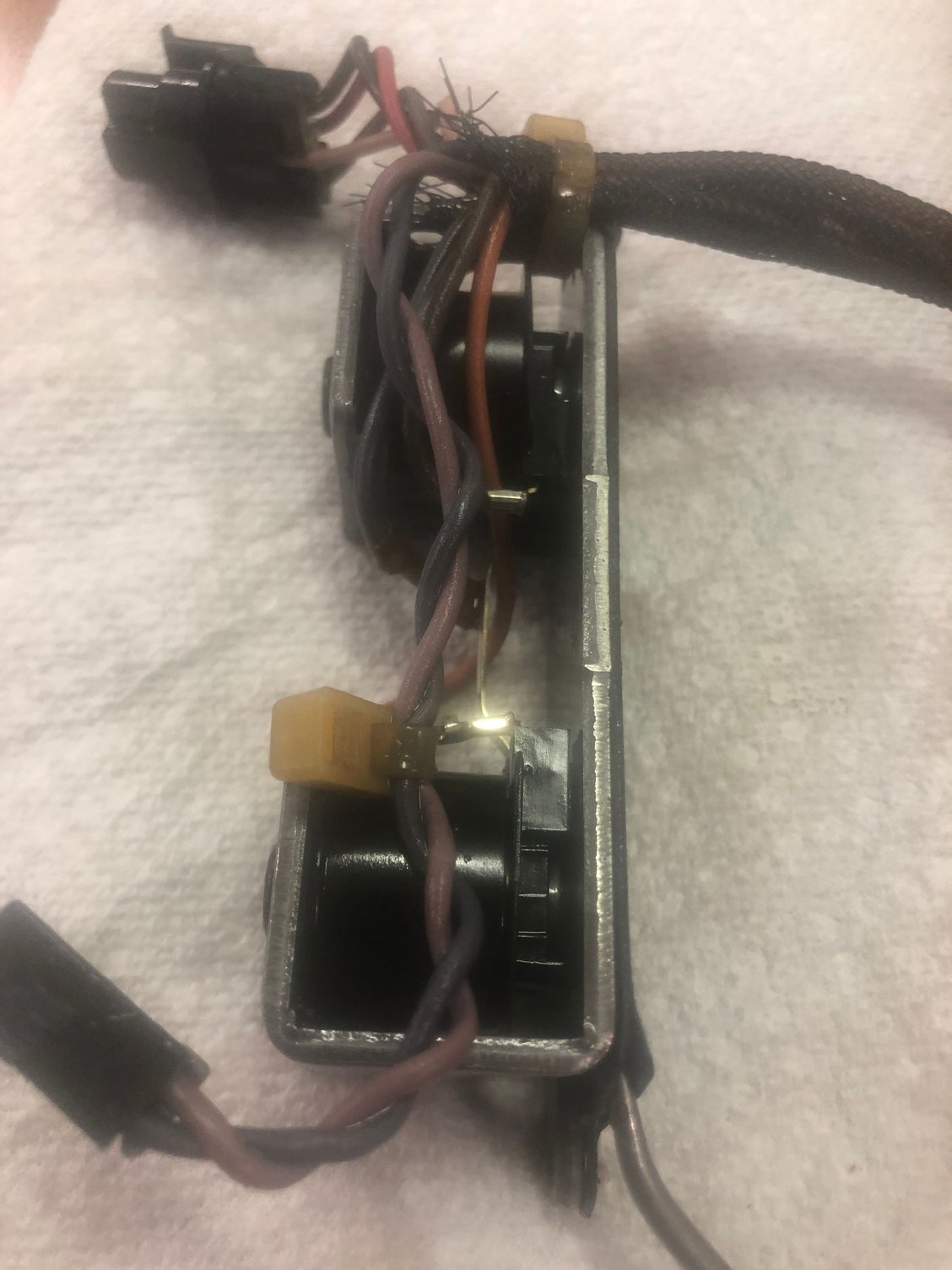

I finally removed the valve body and disassembled. No real issues found. No sticking valves and bores in housings are not worn. With regard to the solenoids both the overdrive and TCC solenoids have the same resistance around 33 ohms. I found a spec that states the resistance needs to be between 25 and 40 oms so the resistance is in the middle of spec. They do appear to be original, they have a part number stamped in them 52118500. Looks like two gaskets were used. Do not know why one would do that. Have anyone had solenoids that were in spec. and still were faulty? Anyone installed a Sonnax Zip kit in one of these transmissions? Appreciate any other advice on what I should do before I put the valve body back together and back in truck.
Solenoids, note 2 gaskets at bottom where pick is inserted

No idea why there would be two gaskets there..... And ya gotta admit, they are old.... so, while they my test good, that doesn't necessarily imply that they ARE good. If you have new ones, install 'em.
Sonnax makes some good stuff. I think the zip kit used to be called the 'sure cure'. I do believe part of the installation is modifying the valve body so that the the torque converter is charged when the trans is in park. Really not a bad idea. (and it means you can check fluid level in park as well....)
