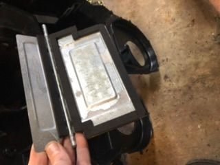

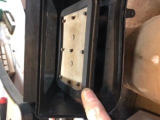

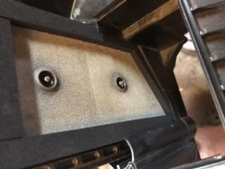

Originally Posted by Spillage
Just did strips placed snugly together and trimmed around the edge.
You can use some rtv or seal adhesive between strips if you want to be certain it’s sealed.
I didn’t use any sealant, and it doesn’t leak.
That is what I will do no rtv they stuff seems to end up everywhere when I use it

How bad was taking the HVAC box apart? Since I have it out I might as well do all the seals
Pretty easy... take a pic of where the wire and hose clips go to make life easier putting it back together.
The most time consuming part is cleaning all the old foam off.
It’s a job worth doing while the box is out.

Thanks man I'm going to see if I can find them seals at the store. Did you use that on all the doors?
Old Aug 23, 2020 | 05:54 PM
Spillage's Avatar
Spillage
Joined: Sep 2012
Posts: 2,439
Likes: 73
From: S. Florida
Yup...
