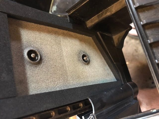

So I used weatherstripping for air conditioners for the ducts but what do you guys think about using closed cell foam for the AC and heater lines where they seal against the firewall

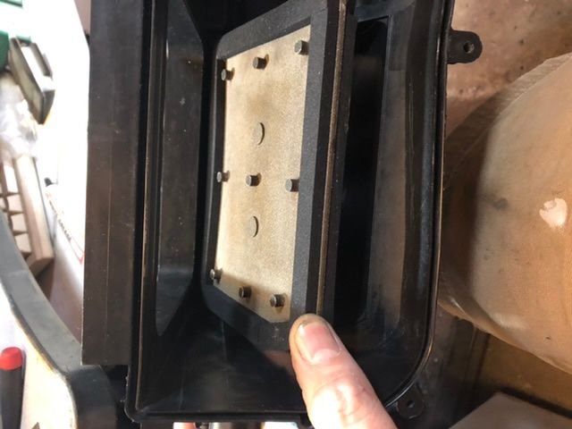

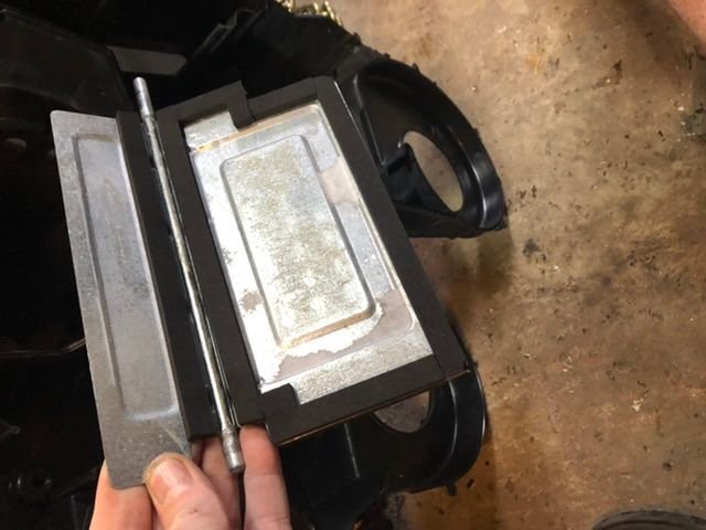

I used 1/2 Inch Wide X 1/4 Inch Thick, Neoprene Weather Stripping High Density Foam Tape
for the blend door seal and around the firewall opening... worked fine.

A place i used to work at had closed cell sponge rubber neoprene with super sticky adhesive on the back(all thicknesses). I used that, It will out last the standard foam you can get at the home improvement stores. When i took my hvac box apart all the seals where shot.

I stripped all the old stuff, wiped it down with alcohol, and stuck on my precut piece.
