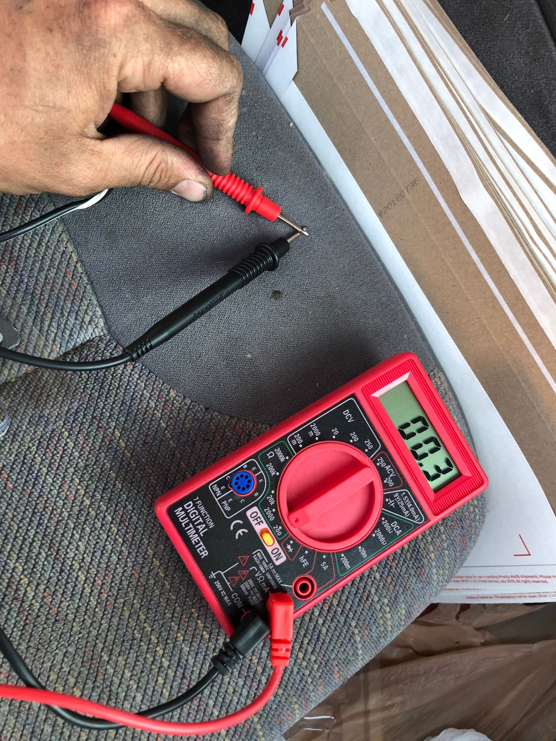

Did either of those wires give you anything other than .3?

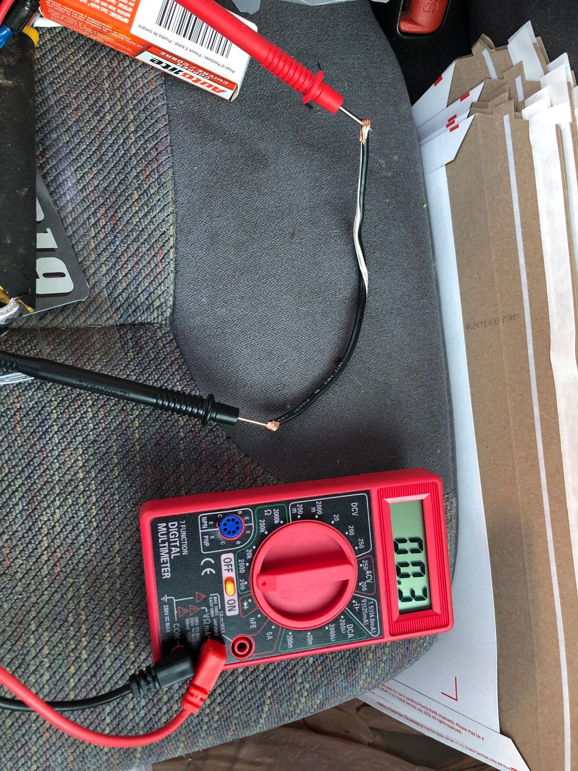

no they both show .3 to my recollection which is the same thing that shows if I touch the leads together or if I test on a single piece of separate wire by itself

question: can I take a piece of known good wire and splice it from one end to the other and bypass the whole harness to double check it? In theory this should work for testing purposes right?
i guess that circles me back to when I touch the leads or test a single piece of wire and it shows .3 ohms...
are you saying when testing from pin 85 to the pcm or pin86 to the pcm it should show something else? If so what?
when I touch each end of a known good piece of wire it says .3ohms
what am I missing? What numbers should show when I connect the pdc end to the pcm end?

Your meter needs to be re-zeroed. When you touch the leads together, it shows .3 ohms. It should show zero. (the manual for it should tell you how to do that.)
Have a test light? Hook the clip to the positive battery terminal. Poke it into the relay socket where the brown/white wire is, does the light come on?

I assume you are trying to read voltage? Should have one lead on battery positive and the other(lead from the pcm that supplies the ground) in this pin. Don't be concerned about the 00.3 even my Fluke auto ranging meter does it. And if you are checking continuity you should be using the one with the pic of the diode(the one to the right of where it is now)
